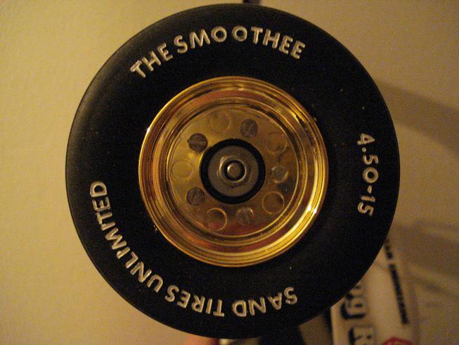

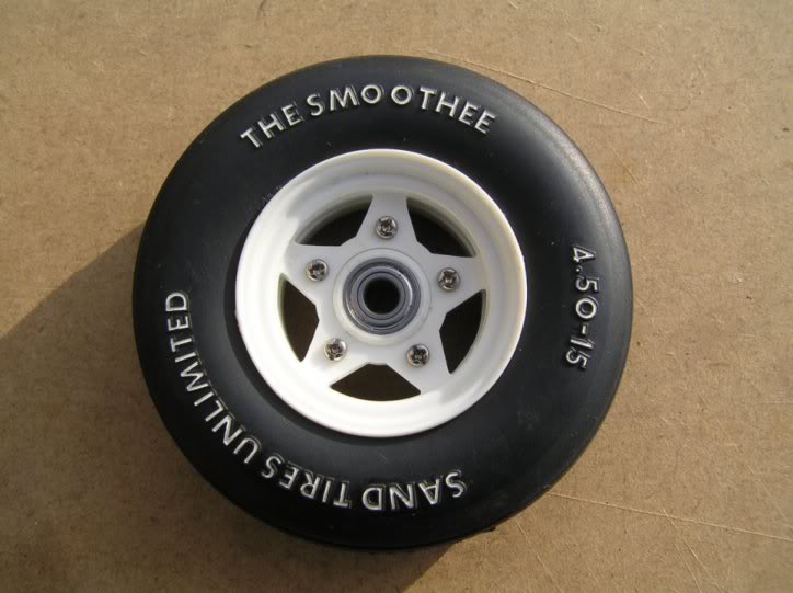

- mikedealer
- Posts: 1778
- Been thanked: 3 times
Re: White tire lettering????
i use this method, and its quicker than trying to use a pen/toothpick..
(prep first, make sure rubbed mold release is wiped off, also MOUNT THE TIRES FIRST if its a 3 peice wheel!)
1. Ill take a white ink pen (ive used sharpies just cause they were available locally) and color on the insides pretty well, not worrying about spillage or border bleed.
2. Ill apply 2-3 coats of white (it seems to thin sometimes showing black)
3. After its dry for a good day (time can be whatever), ill take a good blue shop paper towel, fold it over 3-4 times, wet it with paint thinner, and wipe over the white lettering so that the borders will be perfectly black. Trick is not to apply a terribe amount of pressure or thinner.
4. Onces the tires have the black border, there will probably be excess white outside the lettering or inside like a e or something, just use a xacto or toothpick to pluck it out.
5. You may need to reapply some white if it gets rubbed off by the thinner in the flatter spots, but thats easy to touch up
ill take some pictures next time i do it, but if done right it should look like this below from that ebay auction (this type of pen will NOT produce the results pictured unless you take 2 hours per tire. Wiping off with thinner is easy
