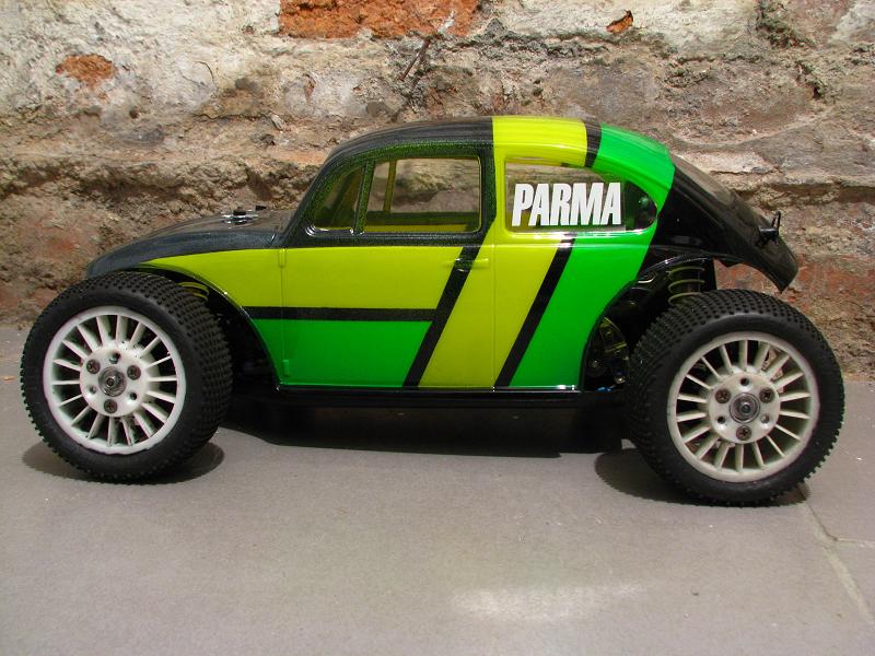

I picked up a cheap MR4-BC in Japan over a year ago and it stayed in the background till shortly.
The main reason was I had no clue of how to really personalize this rather modern build with all its molded parts.
And then this idea hit me... took me some time to get it right , but it came out way better and easier than I thought; I only had to handfab 1 part and didn't even have to go down to 2WD as I initially expected.

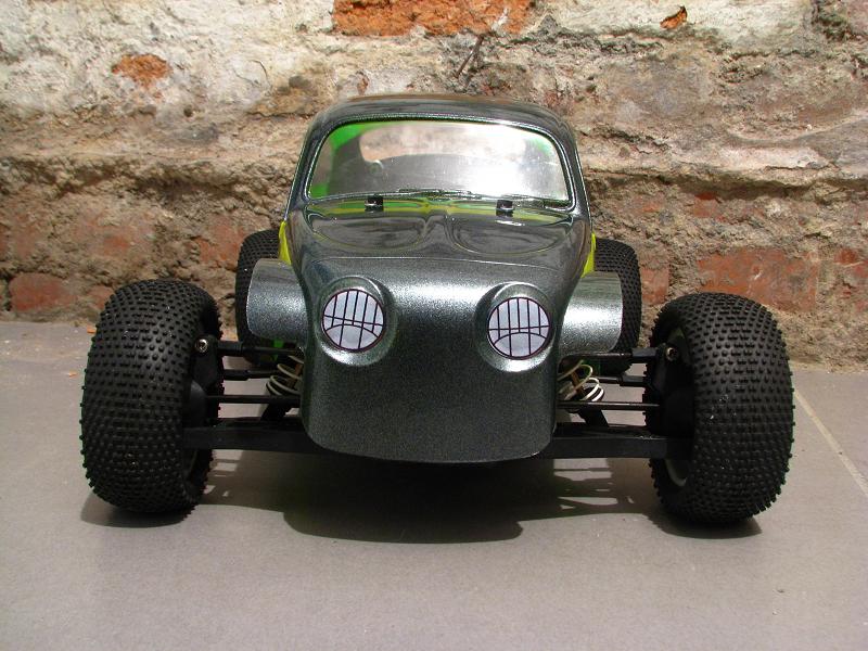

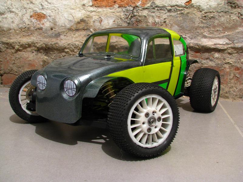

Mr Ed,
That has got to be the best looking bug body I have ever seen on an RC car.
Way Cool

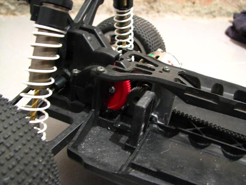

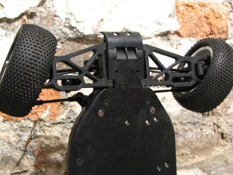

Anyway I thought some people 'd like to see how I made the shorter wheelbase and relocated the steering. Some body-off shots:
front arms swapped back and shocks on the rear of the shocktower bring the wheelbas from short to beetle ultra-short. The servo saver is original but is now mounted a little wider and further back to clear the new shock position. A piece of carbon from a dtm chassis was shaped to fit under the topdeck and fixes the top of the servo saver. The old servo saver location on the topdeck carries the front bodymounts and fixes the carbon piece also.
The aftermarket rear pulley allows using a standard spur. And I chose to use  small one in combination with a 27 turns stock moter and large pinion: thus preventing having to cut the chassis for clearance.
no extra holes were drilled in the new chassis (the original one was replaced by the previous owner for the lightweight version with batterycell cut-outs)
