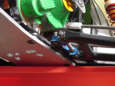

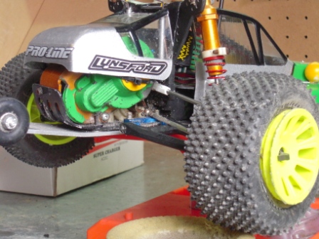

I was wondering what were the weak points on the RC10 or 10T?
I think that arms and arm mounts probably are likely on the list somewhere.
Really, I am wondering more specifically, are the aluminum screws meant to shear off when under extreme torque or pressure?
This happened to me today
I was making a sharp turn and gave it some throttle coming out of the turn and the next thing I know the foam is flying across the driveway and one of the rear arm mount screws is sheared in two. 8)
Maybe the tire ripped off and the foam flew out first creating it to be thrown off balance and then it torqued off :?:

Well, it's better that the screw/bolt sheared off rather than the mount or arm breaking. You can get the rest of the screw out of the arm mount and off you go!
Something to keep in mind is the insane amount of grip that modern tires can obtain. The RC10 was not designed with the forces of Holeshots or Double Dees (I just like typing that) in mind. The simple fact that so many of us are running them at all with modern tires, motors & batteries is a testament to how tough these things really are.

Yup the screw came right out, and I was back at it. Gotta like RC10 technology, simple, yet well designed. It definitely gets you back on the track quick if something breaks.

in 20 years, i've only ever broke 2 associated parts. a front arm on an rc10gt (when my kid drove it full throttle into a telephone pole), and a rear arm on my old tc3.
i'd bet if you wouldn't have those aluminum arm mounts on it, that screw wouldn't have broke.

Such wise words. Some day, people will realize that aluminum parts might look great, but they make the next weakest part next to them break REALLY quickly. Good luck if you manage to bend that aluminum part, too. Pulling bent hinge pins out of aluminum bulkheads is always an entertaining chore.

yeah, I'm sure it wouldn't have sheared off either.
People think those aluminum parts make things stronger, whereas it just makes something else on the car more susceptible to breaking as mentioned above.
That's why I thought I would start the thread, to bring out some of parts that are supposed to giveaway when hitting something to save the more vital parts. Like the arms, if they didn't break, then you would end up tweaking the chassis of something else. Arms back then were readily available and quick to change.
I'm guessing by the first couple of replies, that we wont here much more than the arms breaking. This is also what I have experienced too with all my older stuff that has proper periods electronics and after market parts. Oh and I too had a cracked front shock tower after the RC10 hit a brick wall at full tilt :oops:

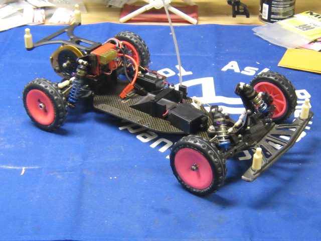

I currently ran an oval race with my old/new RC10 and B4 in a basement of a Legend running a front spike tire on the outside and road tires (trucks in the rear) on the rest. Quite fun, with just 8 guys playing around. Spikes on a 4 corners with oval would be cool to watch :lol:
