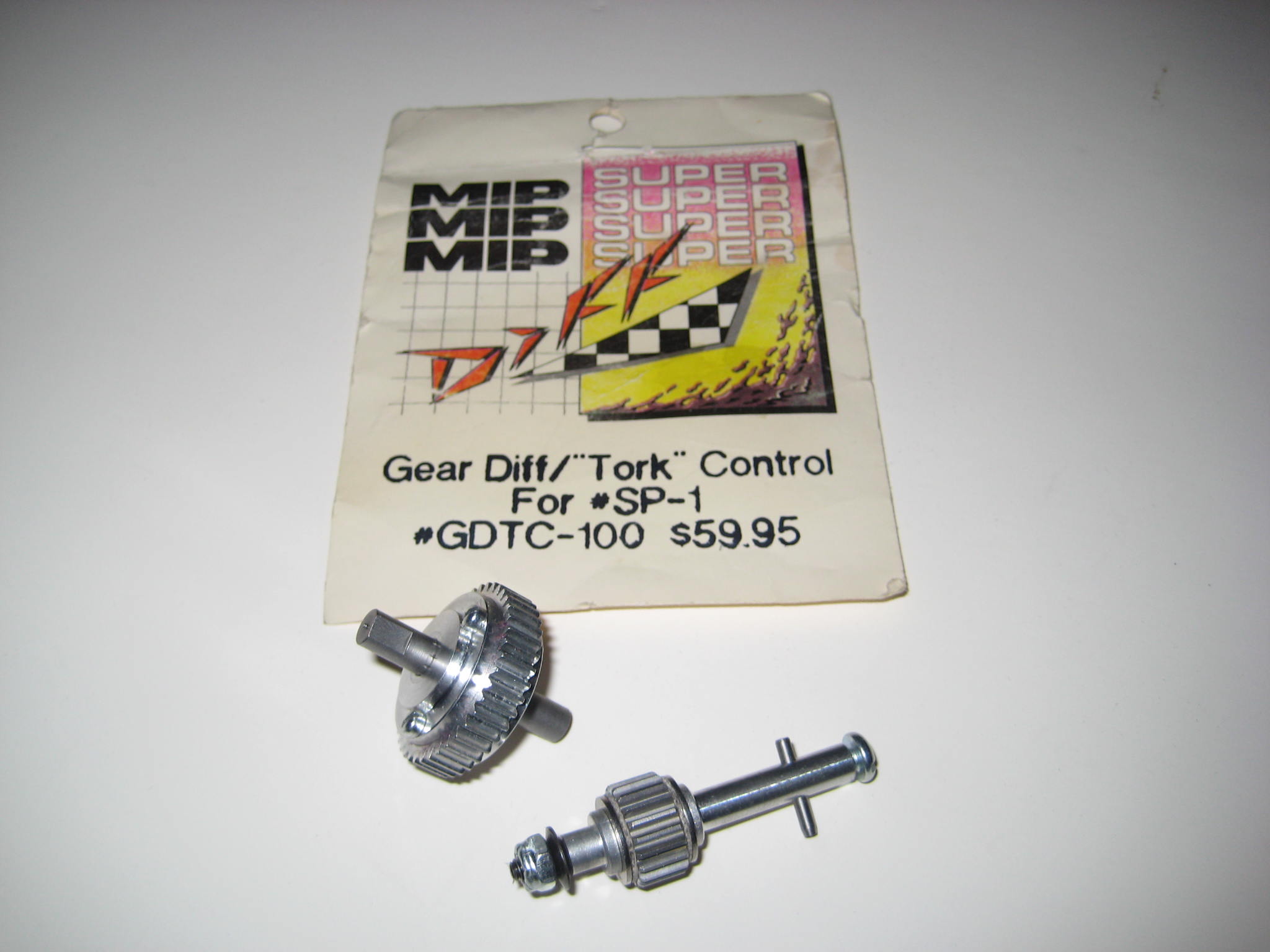

by a01butal
shodog wrote:MIP made a slipper topshaft. In addition to ball diffs they also made gear diffs for this gearbox
Just assembled this pair yesterday, just love MIP stuff, great craftsmanship and quality.

Posted: Thu Apr 08, 2010 9:01 am
by shodog
a01butal wrote: Just assembled this pair yesterday, just love MIP stuff, great craftsmanship and quality.
Those are exactly the parts I was speaking of.
Re: mip tranny
Posted: Thu Apr 08, 2010 12:52 pm
by corkyjohnson75
why as your layshaft got a nut on the other end.
Re: mip tranny
Posted: Thu Apr 08, 2010 1:01 pm
by jwscab
that is the slipper top shaft. you adjust it with the nut on the side, the gear itself slips on the 2 side plates and the nut and spring provide tension.
