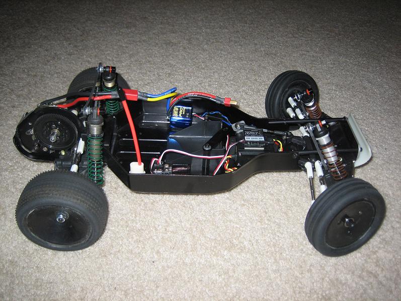

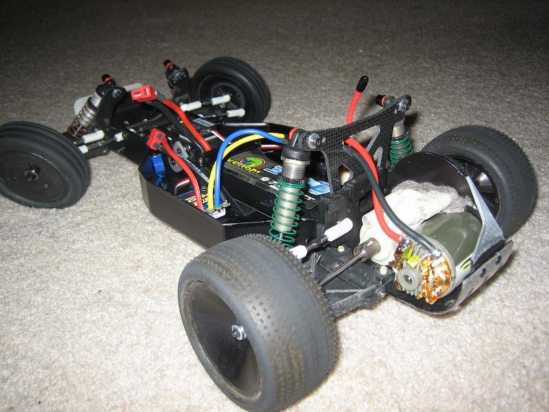

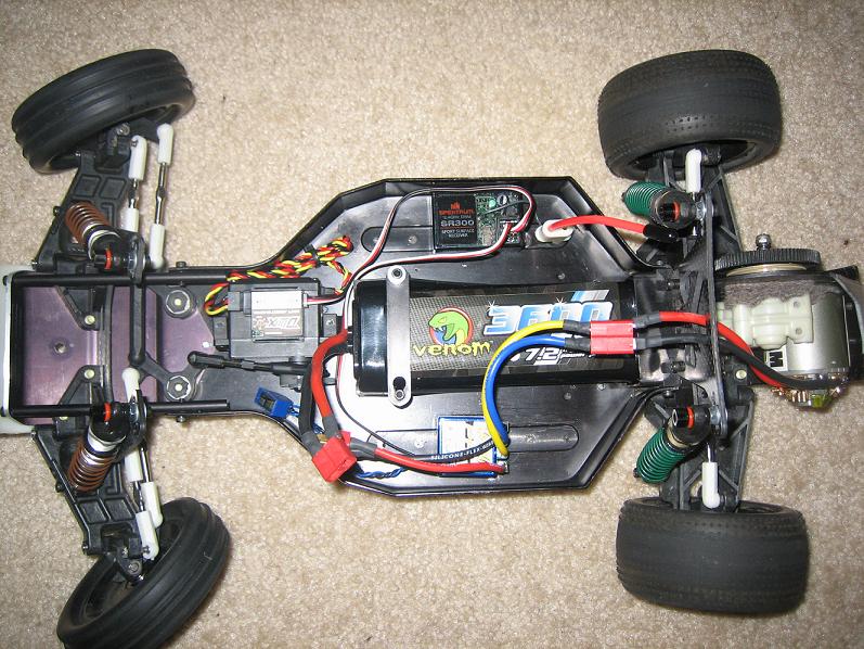

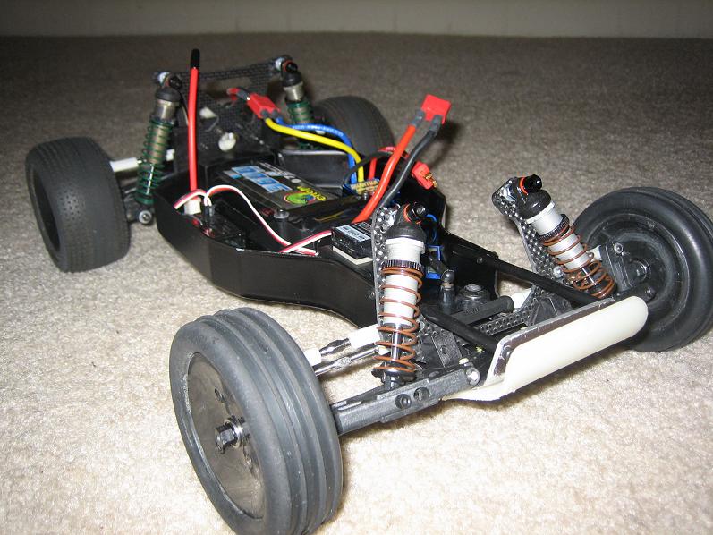

I rarely get a chance to post up my builds. Mostly due to my parts being in storage and my wife not wanting to share me with my builds. Here we go. Here is my version of an Old but Newer car.
I was fortunate to find this car at a local hobby shop. The owner offered it to me for $15 saying he was close to throwing it out. The chassis had seen alot of battle and was a sight for sore eyes. The chassis was one of the dirtiest and most scarred chassis I had. Covered in flat black krylon and a pound of CA glue.
My first task was to clean the car up. I tore the car down in stages over a few months. I wanted to build my first runner and pondered about it since I already had a Team Car chassis in mind for this build. In addition I was unsure about using such a rare chassis as my runner. After some thought, it was the perfect chassis to put back into service. I wanted this runner to be a cross between Kinwald's original car and an Old but Newer version. Old but Newer mods:
- B2 CVDs
- B4 threaded shocks.
- New graphite WC shock towers - The front accommodates the .89 shocks
- B4 slipper (future upgrade)
- Electrics (Spectrum DX3S, LRP Quantum Pro, HiTec Servo, HPI Drift Assist)
Kinwald mods:
- Kinwald shaped nose
- shaped motor plate
- Rear bulkhead ball end ears removed
- Kinwald shaped rear A-arms
- Motor: Team Kinwald Dirtinator
Other mods:

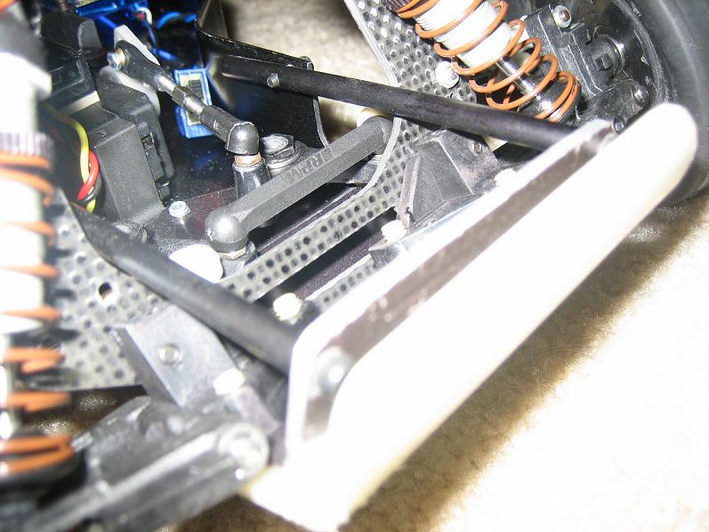

- Ti turnbuckles w/ RPM ball cups
- RPM shorty front bumper
- Chassis tape
- B2 CVDs
Kinwald mods:
Other mods:
- Chassis tape

Re: JPAE07s Old But Newer World Car w/ a Kinwald Touch
Sweet looking towers, don’t forget to add the tranny brace.

Also just a minor update.
A while back I obtained a Team Checkpoint 12 turn. Once I get this thing going the right direction on the track I plan on swapping motors.
Also, the LRP ESC is the second from AE. The first caught on fire and nearly burnt the car to a crisp. Good thing those LRPs have a lifetime warranty.
