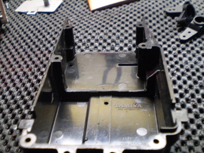

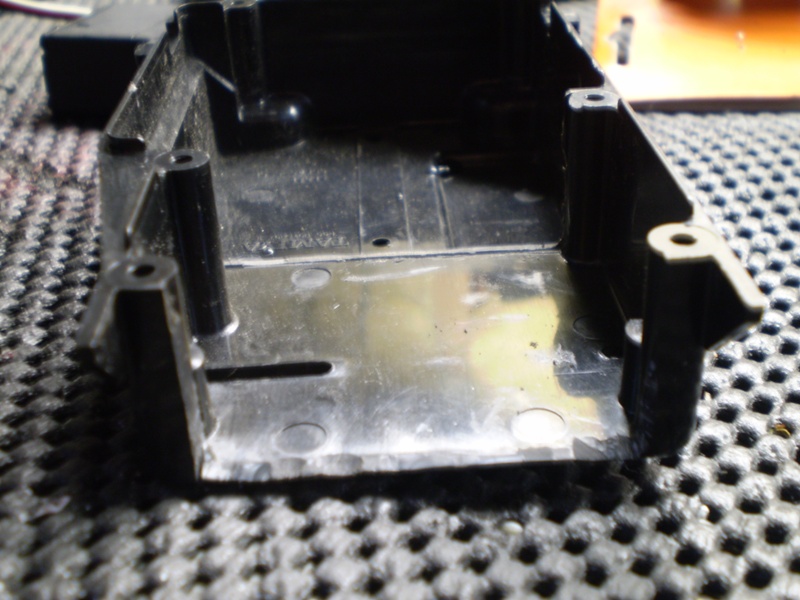

so i been slowly working on my hotshot re-re.... finally got to the servo/electronics setup...
is there anyway to increase steering a bit on these cars? basically the steering is a direct servo turn (like frog and others). no bellcranks or anything to increase throw.. are there any tricks/upgrades to this? if i added a large/longer servo saver would that help? would give it just a bit more "throw". any ideas?

I don't think one of the large Kimbrough servo savers will fit in the channel they made in the chassis... I know what you mean, though.. Just doesn't seem to turn enough.

i was going to put washers under the servo to raise the servo a little to fit it in the channel, going to try it out tonight

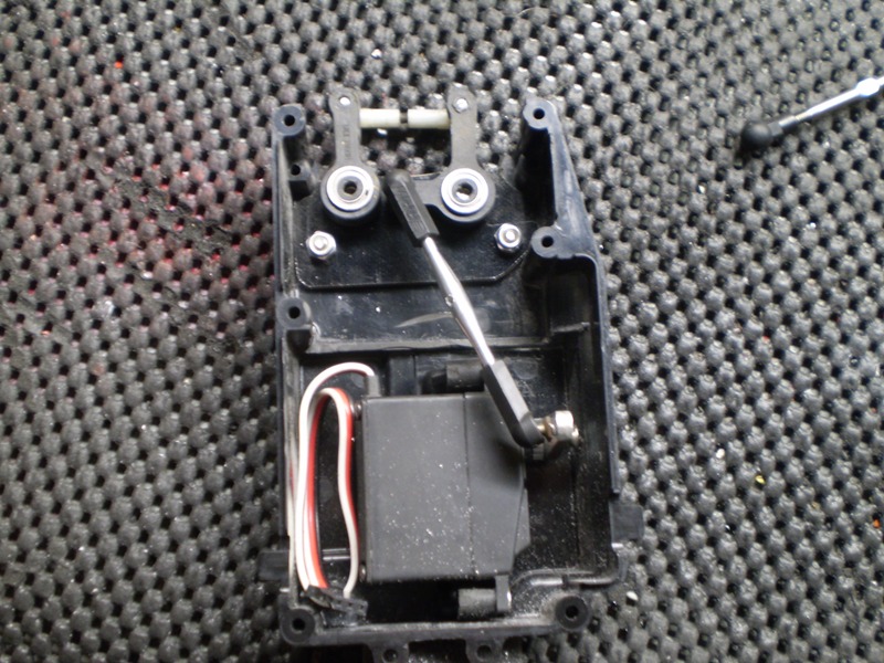

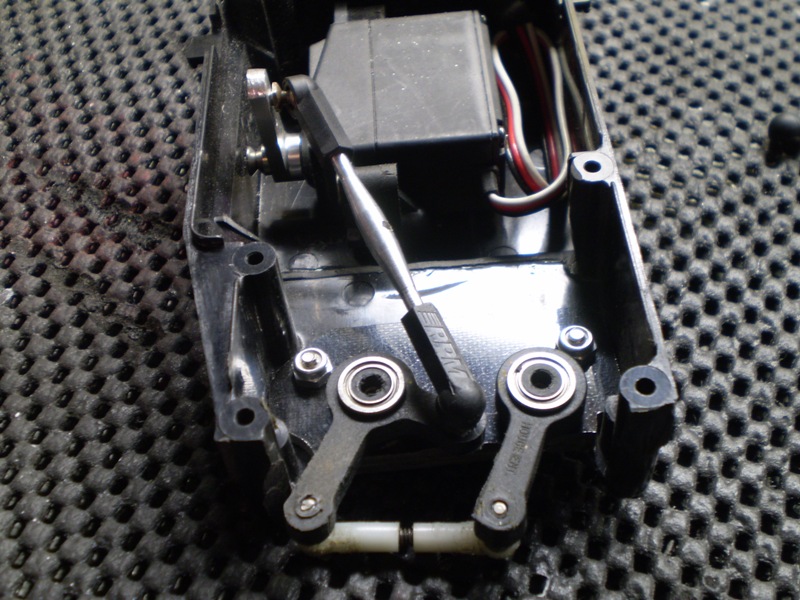

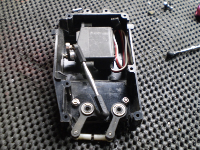

added a set of houge bellcranks into the lower chassis plate.. fits well. electronics are a bit tight but with a spektrum micro reciever and a small brushless ESC it will be fine. added a graphite plate on the bottom to strengthen everything. had to dremel the chassis part a bit, but fits and steerings perfectly.
with this mod, the wheels will now turn to the full radius that the front hubs will go so understeering isnt a problem anymore. waiting for some dubro rod ends to come in to mount it up...

Hey Mike you are doing a good Job there.
I was thinking along the lines of a Boomerang rack set up.
Hope you have enough clearance for the links and mounting the bumper.

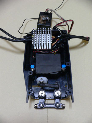

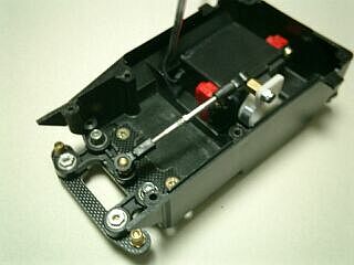

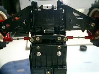

for this issue..........I have been searching in the internet for a while...........finally got these photos (from some Jap webpage).........
one is using TA05 bellcrank........the other one with Avante 2001........

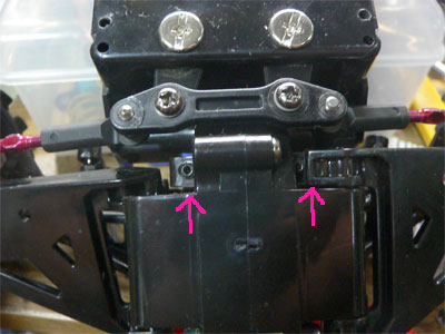

Well im still thinking of which mod to do the steering set up.
I have a set of Top Force bell cranks with alloy post and bearings and would be silmilar to what has done here already.
On the other hand RC Channel has just realised there steering kit too.
Totally different to whats here but i think its so the chassis isnt modified at all.
Just two screw holes. Looks good but may affect ground clearance a little as the bell cranks are mounted below the chassis which is coverd by their own skid plate.
For $30 U.S its a little steep i think but you know it will work. There parts are excellent as i have their Pro metal kit with four shocks and seems to be really good.

Looks like the tao5 setup is a better way to go. The pivots of the front arms are about the same width as the ballends on the bellcranks. Best bet for minimizing bump steer...
I guess most doing this mod are mounting the ESC and receiver where?
I noticed one of the problems on the stock setup is that the ball stud in the servo saver in full sweep is hitting the front gearbox minimizing full throw. Have to get a little creative with the dremel, I guess....
Why with all of Tamiya's engineering prowess do they always seem to overlook the simple stuff? Sloppy steering links, bump steer, etc. All you have to do is look at the rear suspension on the original Hotshot to know they could do better in other areas. *Rant over*
