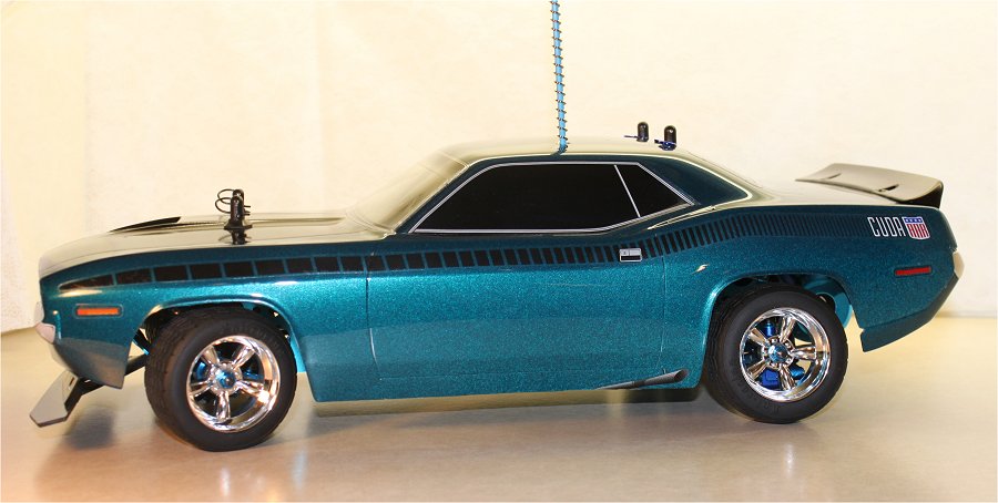

Posts: 7421
Location: Alberta, Canada
Post by Coelacanth »
Toasted Coastie wrote:Dude, I am in awe of this build. Pure goodness! Fantastic job!
Thanks, Coastie!
I lubed & threadlocked & put everything back together on the rear, and finally took some quickie body shots showing the results of countless hours of measuring, searching the 'net for parts that *might* fit, and lots of trial & error. This is as good as I can get it, but it was worth the effort. Who'd have any idea there's a Turbo Optima under there? I think it looks like a muscle car ought to look, like they did back in the 60's and 70's...not with the tires pulled several inches inside the wheel-wells or sticking out too much--just about flush.
I also dig how the blue rear arms & Lazer hubs, and front knuckle arms can be seen through the 5-spokes! 8)

I can finally say Project CYANide is completed! This took over 8 months to finish, several months more than I expected, but I'm happy with the final product...an Optima like no other!
Tonight I found the time to take the final "money shots". Thanks to all who followed this thread, helped me out in countless ways (but mostly by answering my hundred questions about "what size is that?" or "will that fit?") not the least of which included selling or trading me the various parts needed to make this car happen...and thanks also for all the great comments, which was a big part of my motivation to get this thing done. :mrgreen:
