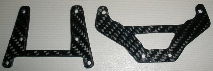

I got some suspension tweaking done tonight, it's more or less just as I was hoping to accomplish. Barney now has full-size front shocks like all the OTHER race cars out there! :mrgreen: One weakness of the Optima series that I wanted to address were the aluminum shock towers, which are notorious for bending all to hell after some rough roof-top landings, especially the rear one. As mentioned before, the stock front tower (if you can call it a tower) was backed by a proper 3mm thick CF tower.
I had to figure out a way to fabricate a rear shock tower brace (of sorts), something just a bit wider, just a bit longer, and mounted directly behind the stock aluminum tower, to hopefully strengthen it. I used a piece of 2.5mm CF cut from a scrap I bought from eBay (carbonfibersuperstore, I think)...that arrived only gloss-finished on one side. (I positioned that side towards the stock tower so you can't see it.) :lol:
The CF towers themselves were finished by blacking the edges with a Sharpie marker before applying CA glue to prevent delamination. I had to use screws that were about 2 - 3mm longer than the manual-recommended screws to properly mount the CF towers (perhaps obvious but worth mentioning).

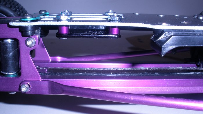

Homemade servo mount
Post by Coelacanth »
Here's a mock-up of the servo mount I made from a scrap piece of carbon fiber and 5mm thick spacers. I like Jay Dub's suggestion to use flat-head 3mm screws on bottom and normal 3mm screws on top running through 5mm thick threaded aluminum posts, that will help me lose the unsightly nuts on top. :oops:
There won't be much thread for the 3mm screws to grab onto, but hopefully 2 - 2.5mm each (for top & bottom screws) with some threadlock should be enough...now to wait for the needed bits & pieces I ordered to arrive. More delays... :|

So it's just double-sided tape which holds the servo onto this late?
Coelacanth
Posts: 7421
Location: Alberta, Canada
Re: MMV Challenger: Turbo Optima build - Project Barney
Mr. ED wrote:So it's just double-sided tape which holds the servo onto this late?
Yes, double-sided tape and a plastic zip-tie just for good measure--as per the manual. :) I spent so much time focusing on the suspension that I never took a great pic of it with my CYANide car, but you can pretty much see how it works here.
