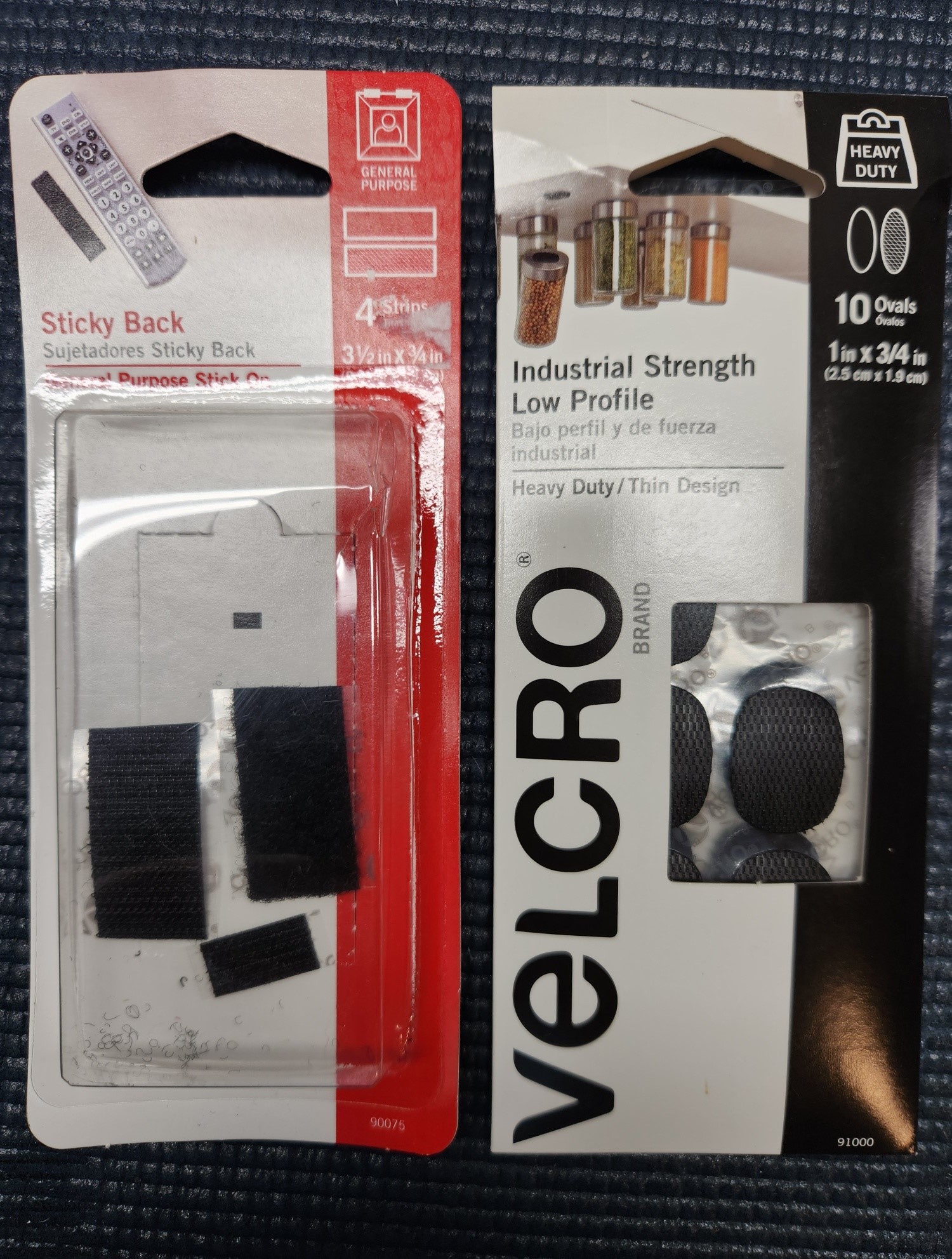

Have you tried using velcro strips to hold down the electronics? It has worked well for me in bashers. I clean the surfaces with rubbing alcohol, dry, heat each mounting surface with a heat pen, then apply the velcro strip while surface is hot. It takes a lot of elbow grease to remove the velcro if needed, but it comes off clean. I haven't had any velcro pull apart in crashes and rollovers yet, it would take a lot of centrifugal or brunt force to do so.

I have had used velcro in the past but it's always a challenge to keep clean. I think I will need to go back to it, or foam tape only for this rig. I really liked how clean the hot glue worked and that it didn't hold any dirt.
The hot glue makes a great tool on the aluminum tub, but for the carbon tub It doesn't go on evenly enough, or frankly it isn't good at 110 degrees.
Any specific velcro you used?

Nothing special velcro, just the thin stuff. Pretty sure I found these pictured at Walmart. Regarding cleaning it, when I get done bashing I spray the rig with a compressed air gun, also pull the velcro apart and spray it as well. Works really good getting dirt and dust out of the velcro.
