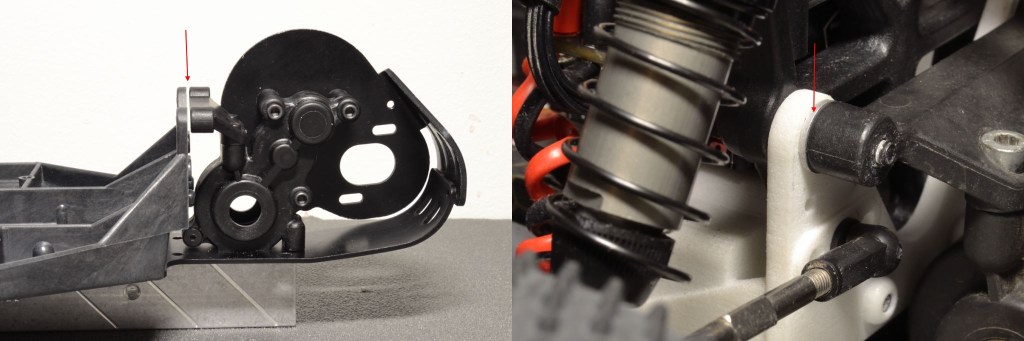

Only thing that I noticed during my build was a need for a washer between rear shock tower and transmission brace. While wondering this, I put together B2 rear end with original parts. And there it was... same gap with original parts. Normally, when screws are attached, rear and lifts up. Now when chassis is CF it doesn't bend and shock tower bends instead. Which is not wanted. So with a proper size washer rear shock tower will stay in its original position.

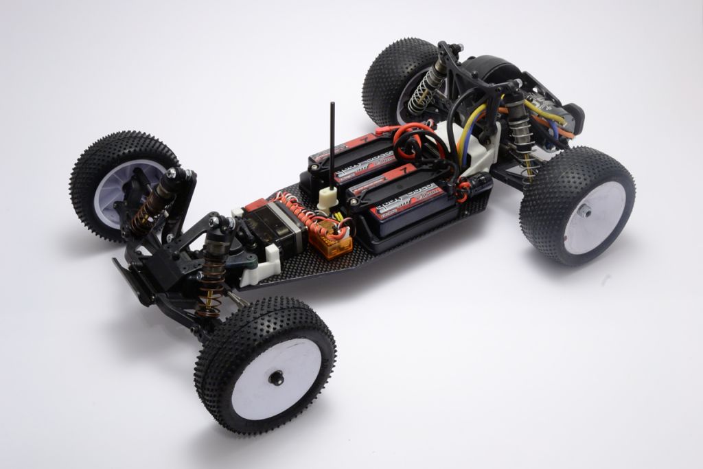

This was my setup yesterday at the track. B3 arms (B2's in the picture) and B44.2 battery cradles.
I dropped ESC down from shelf and routed servo and receiver wires through the gap between saddle packs.
This way battery CG moved 15mm forward and 1.5mm down. With extra 25g weight inside front box car felt really good.
Feels like now it's really starting to turn - first time. Until now rear end has been like glued to the track no matter what setup changes I make.

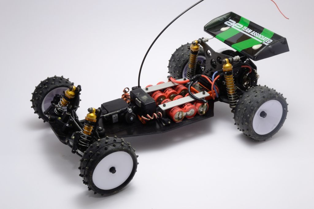

Just realized why my current saddle pack layout feels so good and comfortable.
Below my 1989-1991 race car (replica).
