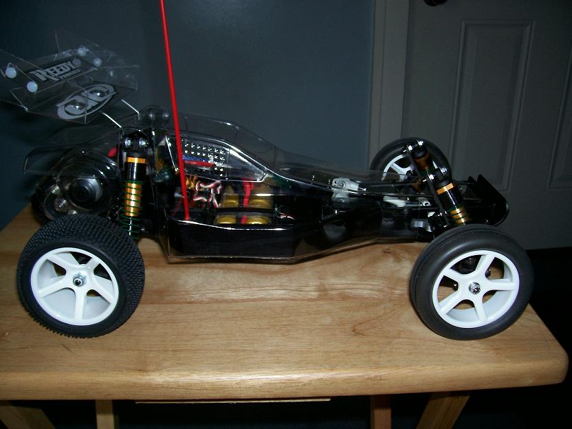

Have set on my soon to be runner with proline tires. Not sure if they are nylon rims.DerbyDan wrote:These 2.2" wheels from JC Racing should fit straight onto your vintage RC10.....

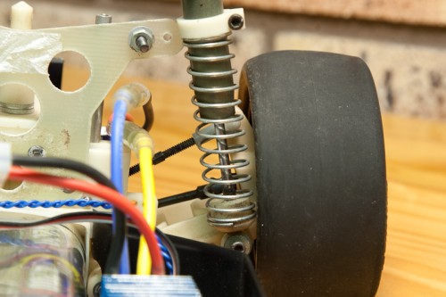

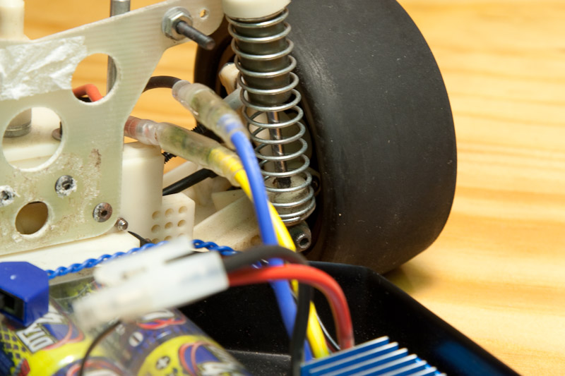

Re: *Parts needed to run modern 2.2 rims/tires on your rc10*
I assume you mean the JC Racing wheels... If so, no clearance issues whatsoever.badattitude wrote:Anyone know if these rims cause shock clearance issues? Will my tire rub on the shock when I use the outside shock mounting hole?
thanks much
See the attached photo's... My shock is mounted in the outer lower hole and is sitting against the shock tower outside edge (I figured since there was still clearance, it was good enough for the photo without having to remount the shock on the outside top hole).
Still at least 3mm of clearance to the rim/tyre.
Yes those tyres are supposed to be bald - Panther slicks (http://www3.towerhobbies.com/cgi-bin/wti0001p?&I=LXNPY0&P=7)
