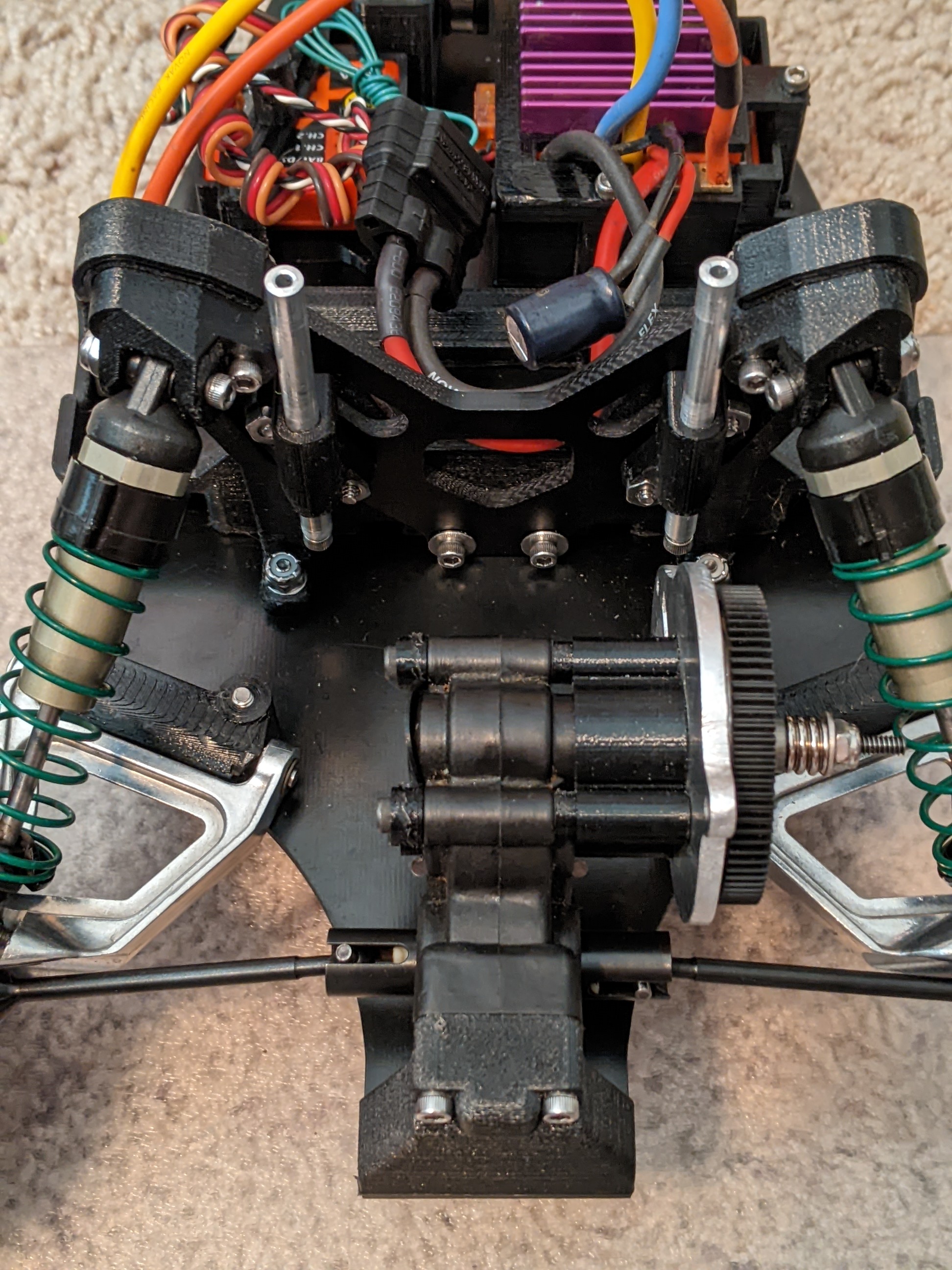

Getting back to the buggy, the chassis plate just needed some trimming for the undertray to fit. After trimming, it's back to reassembly.

Going back together pretty well. Also time to add the front control links so I can sort the steering setup out better.

Need to make a minor tweak to the ball link positions for the bellcrank connecting link. The steering tie rods clear the bulkhead fine be the conning link makes contact that's an easy fix.

I think this is the electronics layout that I want. I considered mounting the servo across instead of front to back, but the layout otherwise stays similar and I need a new bellcrank setup to make that work. I also considered mounting the receiver on top of the servo to get it a little farther from the brushless ESC, but not sure if that results in noise/interference from the servo.

Electronics are all mounted. I did forget the antenna tube mount though. I'll probably make a new hold down strap for the receiver and incorporate the antenna mount into that.
I used an Associated 7138 servo saver and with a single spring clip it seemed sloppy so I installed both the small and medium spring clips. I'm assuming it's meant to be done that way.
Next up is bodywork trimming so I can start work on the body mounts. I'm also considering a front anti-sway bar. It seems like a good idea for this type of front suspension setup.
