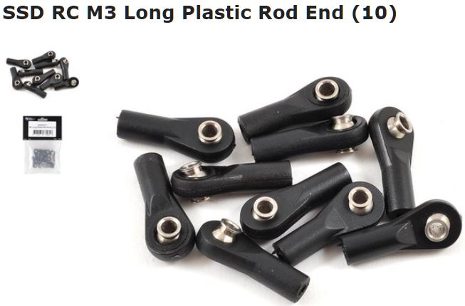

What I ordered to try on my next attempt are plastic, not nylon hopefully. Nylon seems to soft and doesn't cut cleanly for me.
19mm OA length, 6mm OD on the shaft and 3mm for the ID.
Mine will be open but a ball end should measure approximately the same.
And the only reasons I will use them is I have them and they were original to the Mid SE.

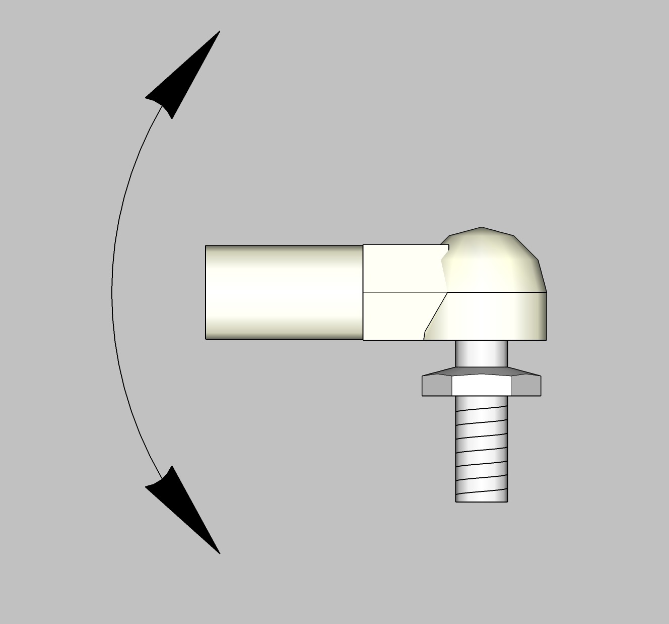

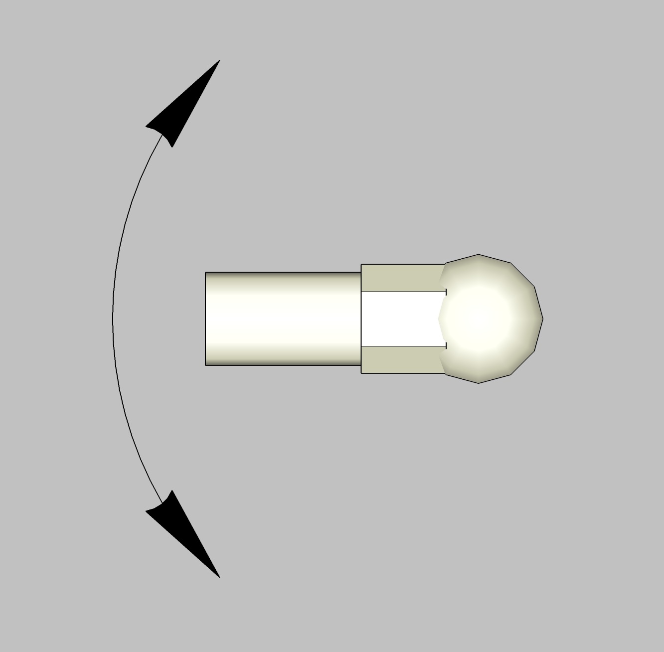

Here's another theory.
If the ball cup's axis of rotation is normal to the ball stud's axis, as in this illustration, the ball cup could pop off more easily.
Conversely, if cup rotates about the ball stud's axis, then it will become less prone to popping off.

True, but that would be no different for an open ball-end.
I guess that's why some cars went with those screw-in captured-ball-type ball-ends (pictured above) because even if they popped off, the screw would be there to retain them...until that ripped out instead. :)

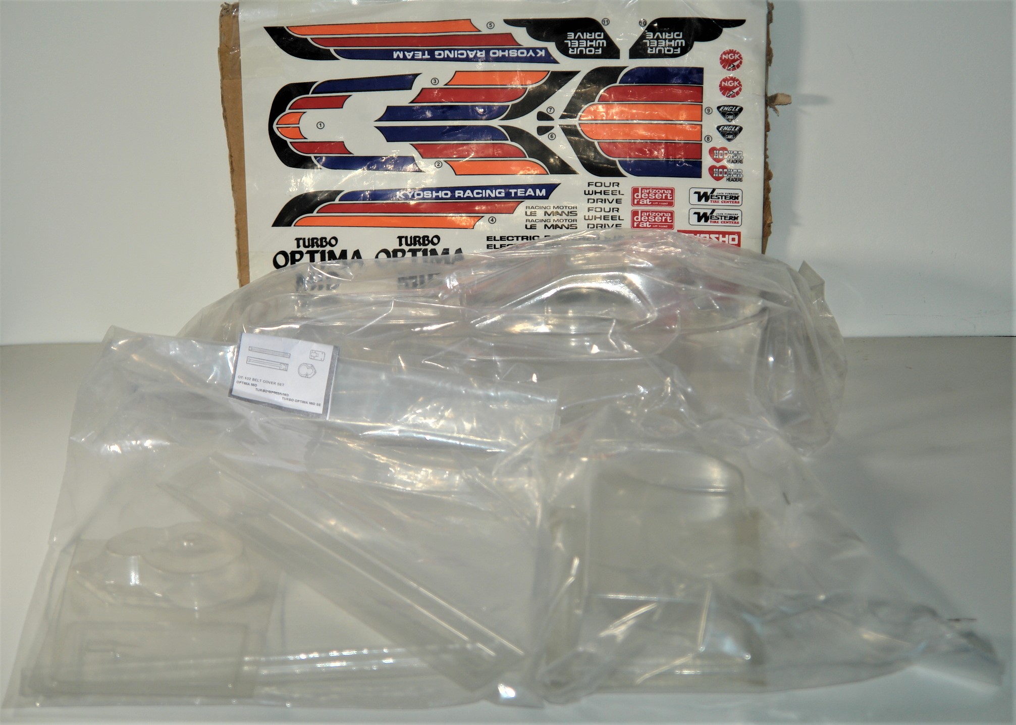

Body. wing, belt covers, etc. to add to to a growing pile of parts.
Very lucky it wasn't destroyed in it's journey to me. Thin non-padded plastic mailing envelope with one small piece of newsprint as protection.
Have yet to closely examine. Hoping for the best.

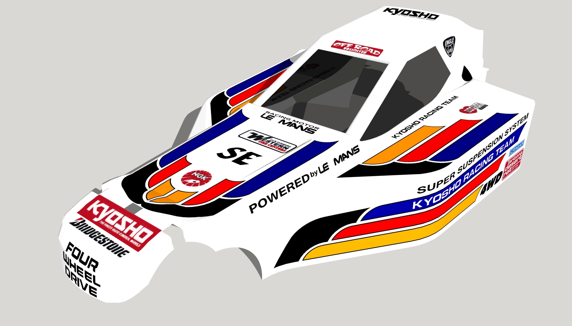

FWIW, I've think that decal set looks nice on a white body as well.

And yours sure looks nice! But is that one of your indistinguishable renderings?

Yes, it's another rendering from the virtual RC collection.
One advantage to having a 3d model is that it allows me to pre-visualize how ugly my custom paint job will be before I spend any time. :roll:
Seriously though, I think yellow or white work equally well with these decal colors. Might be other colors as well but I haven't tried others.
