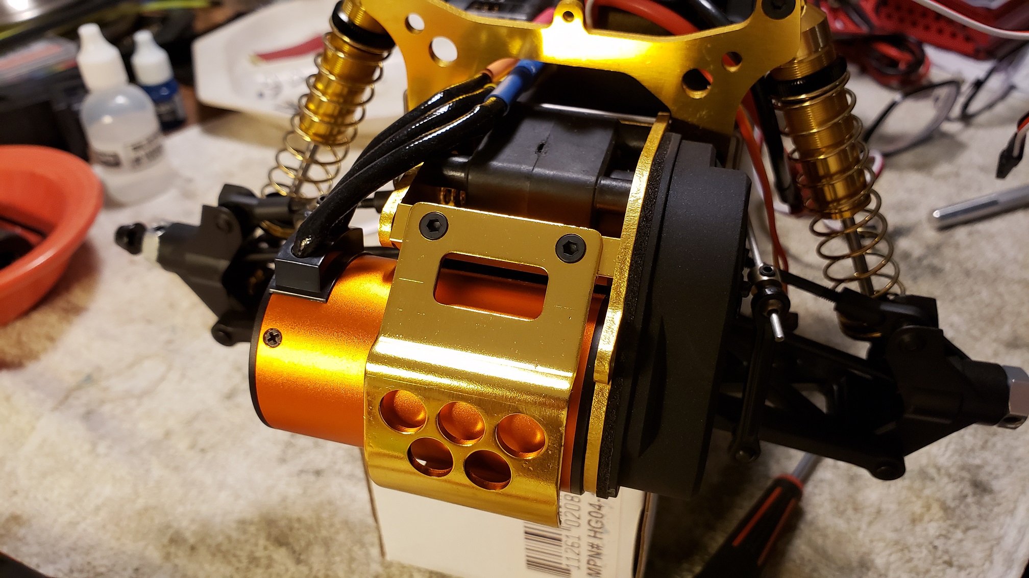

OK, last steps and now the car is DONE! Electronics. This step had to wait because I went on the advice of XLR8 and got the GoolRC motor/ESC combo. The problem was that the motor shaft is 5mm thick, so I had to order a new pinion gear with a 5mm bore.
But that guy's in now, and meshed perfectly...

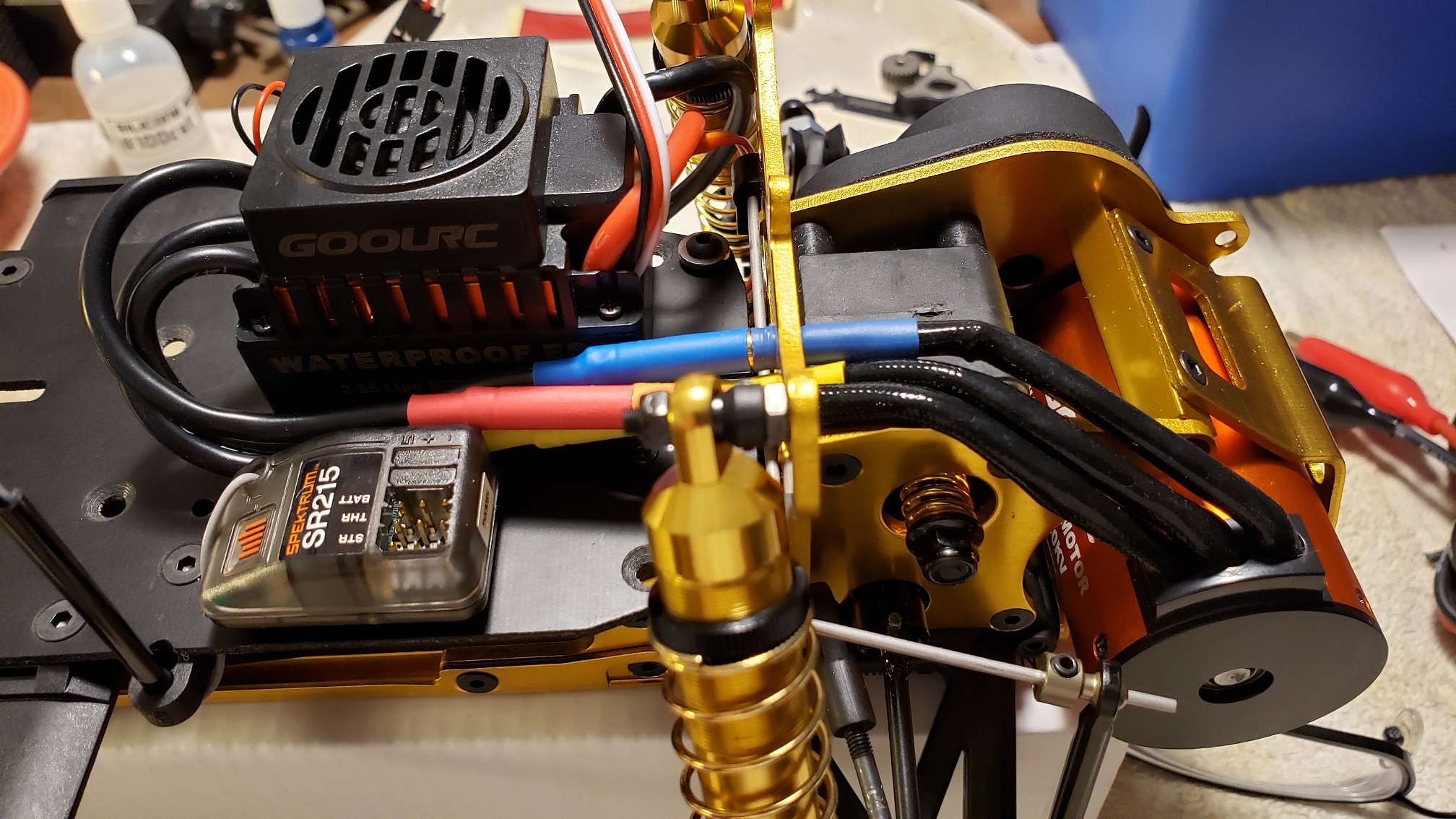

After that the receiver went in near the hole for the antenna tube
Then the ESC taped down so that the motor wires are nice and neat.
And, lastly the receiver wires from the servo and ESC, and mounting the power switch. VOILA! Complete!

Well, the car looks great -- and it should run GREAT as well.
5mm shaft??
Oh man, I am kicking myself right now because I may have sent you the wrong link. My motor takes standard 1/8" shaft pinions.
I went back and looked and the motor I have is model 3650, 3500kV with a 50mm can but I think I sent you the link to model 3660, 3300kV, 60mm can (It's sorta like a 550 class motor).
I am so sorry - I should have checked that link more closely before sending it to you. :oops:
Man that TO is gonna rip with that motor. :D
I have a Reedy motor with similar specs in my TOMS tribute car and it's an ANIMAL. :lol:
Anyway, the motor prices are about the same but unfortunately it required you to buy a new pinion. I am sorry about that.
