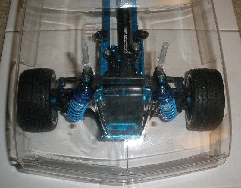

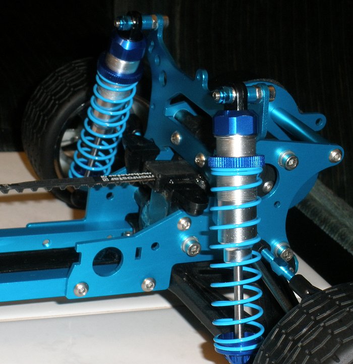

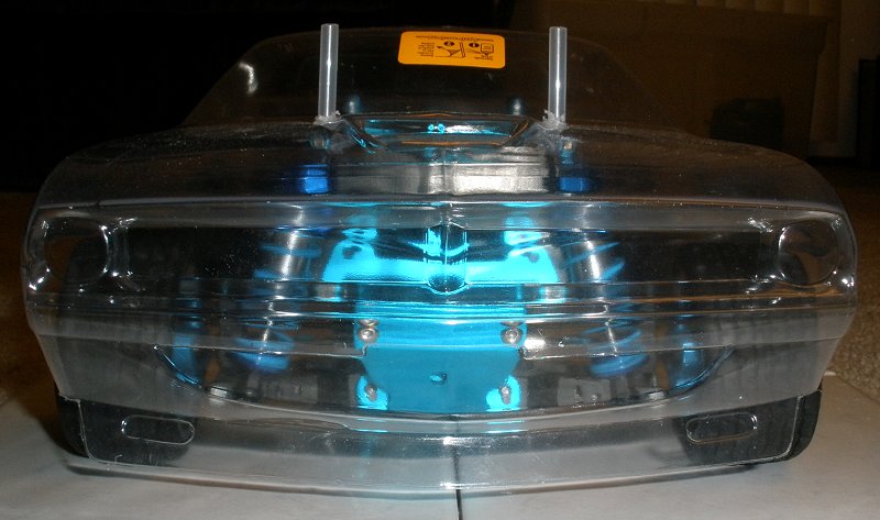

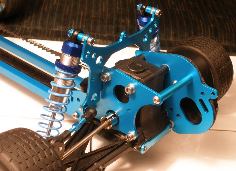

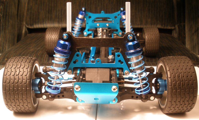

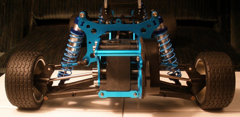

Updated suspension pics
I haven't been able to do more to finish building the chassis as I'm still waiting for parts to get through the mail--bloody holiday lag!
I had some spare time so I tweaked the suspension and took some more on-road body shots. I didn't want to fab rear shock tower extensions or buy shorter rear shocks as the shock travel was only about 5mm too long, so I took apart the shocks and inserted a 3mm plastic spacer inside to limit the travel. That pretty much got the rear control arms to sit the way I wanted, especially considering the low height of the HPI vintage series tires & wheels. The fronts were already setup how I liked.
Armed with a bag of assorted width Tamiya [3mm I.D./5.5mm O.D.] spacers, I tweaked the shock mountings so that the shock adjuster rings wouldn't rub against the towers and would move freely. The cheap black plastic spring retainers were upgraded with a beautiful set of 3Racing Kyosho V-One/RRR spring retainers. This was practically the ONLY set of spring retainers I managed to find; nothing else fit properly.
To Do List: Install some 3mm Kyosho hexes to narrow the track a bit; replace the 62.5mm Optima-length CVD bones with 60.5mm bones, as the 62.5mm bones press all the way into the outdrives with max shock compression. This will also help suck in the rear track a bit.

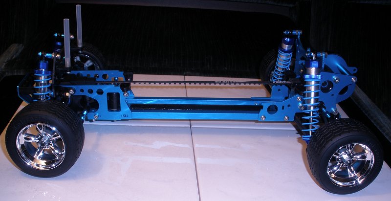

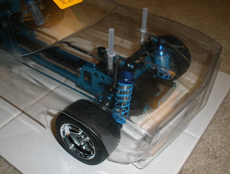

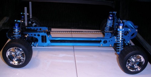

Re: New Optima Build: Project CYANide

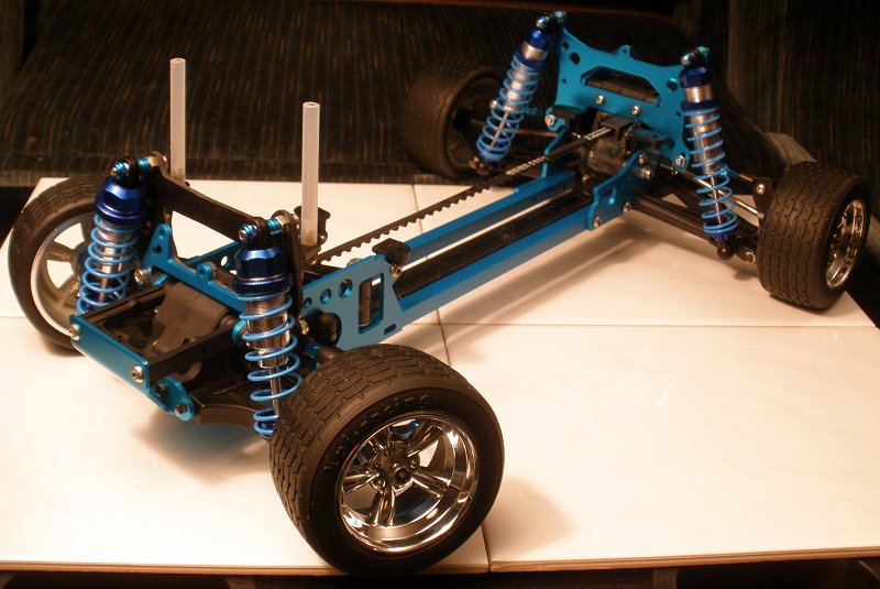

Pics of chassis thus far...

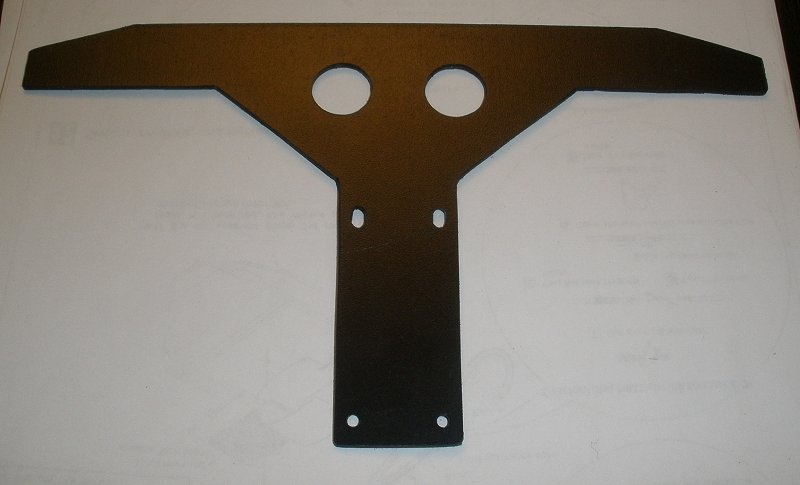

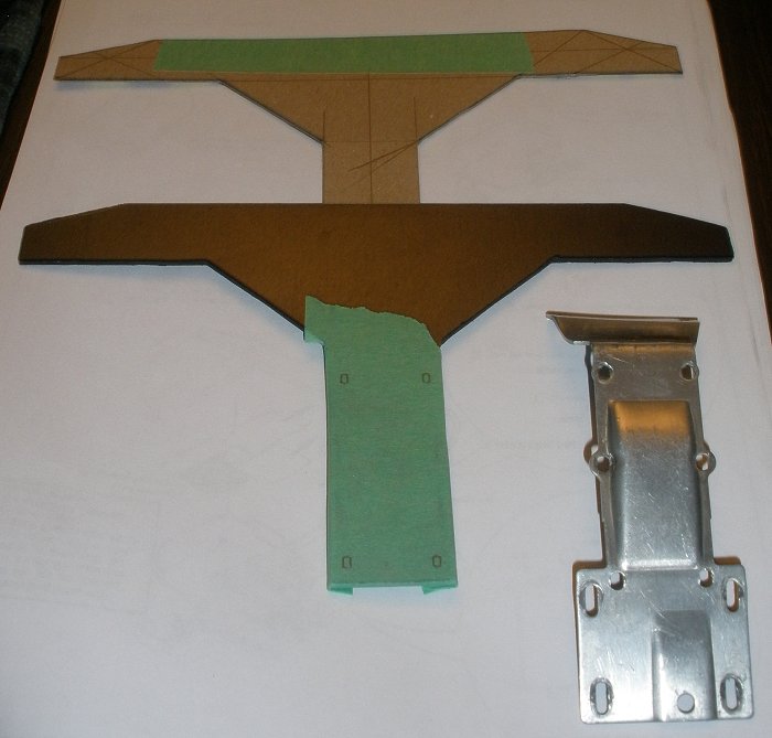

Optima bumpers rare? Make your own!
Since it's damn near impossible to find an original Optima bumper in decent shape (at least without breaking the bank), and the aftermarket Kydex repros looked pretty clunky, I figured I could come up with something better. After some measuring and a general idea of a sleek, simple design, here's what I came up with.
It just needs a bit of time in the oven to form an angle and mold it over the round bump in the skid-plate. I plan to drill a couple holes so I can add heavy foam onto it for on-road use.
