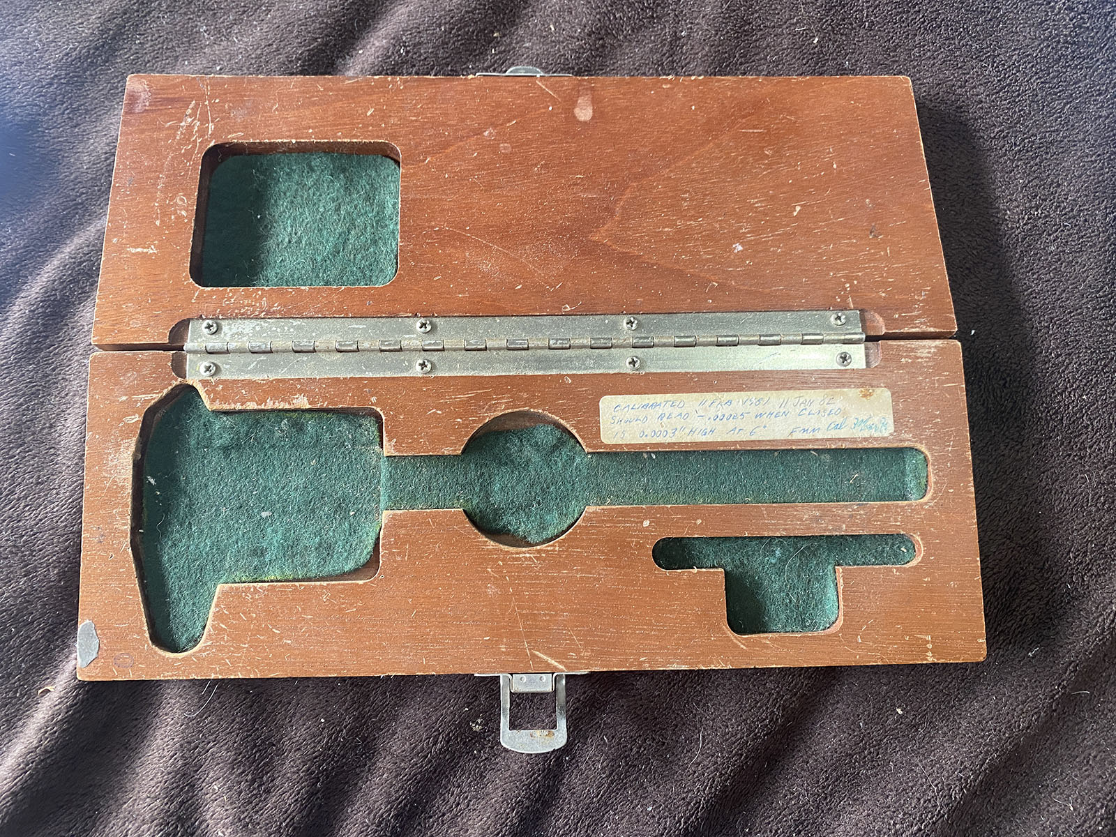

Posted: Thu May 30, 2024 8:01 pm
by azone
Frankentruck wrote: Thu May 30, 2024 7:33 pm I do cheat and use a digital set more and more, but I like my Brown and Sharpe best. I bought these 28yrs ago while working in a machine shop.
Nice. When I started my career I was gifted a set a 6" Brown & Sharpe's by a guy that was retiring. I used them mostly as backup. I just wasted another 15 minutes running around looking for them as I found the box empty. I think my son got to them. But yeah they were from the 60's and definitely quality.

:) I guess take it for what it is - just trying to share some data. Not sure how much precision we really need here but I did double check w/ the 12" caliper and same readings.

by Frankentruck
I had a similar walnut caliper box but forgot it at the machine shop when I moved onward.
