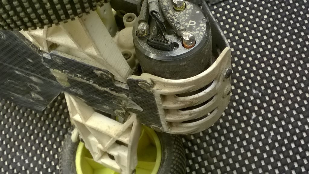

thanks for the reply curtis. were those rear motor guards cut from rc10 tubs? or were they custom made just for the stealth?

littleVETTE wrote:were those rear motor guards cut from rc10 tubs? or were they custom made just for the stealth?
I think ASC6311 from Graphite added with 2 holes for Stealth chassis mount. Dims match. We used standard holes because ASC6311's are so rare we didn't want to drill any extra holes for those parts that might be found. That's the reason SLS part is also available. As SLS part obviously isn't as good as original 6311, I added some functionality with "skid plate" shape to protect chassis rear end.

the reason i brought up the question about the rear motor guard was because i was looking at my team car, and the motor guard just seems a little shorter than what's on the stealth buggy. seems like the stealth buggy's is a little wider and longer. my team car's motor guard....
and the stealth car's motor guard. also take a look at the last two photos from steve husting. two different mounting location holes for the chassis.
if you look at the bottom of the stealth you could see that theirs is a little wider than the stock motor mount plate on my team car. look at the width of each "rib".
-rob

Original Stealth chassis rear end is narrow compared to RC10 Graphite. Standard holes on ASC6311 are too wide to be used. That's is the reason for additional holes on Stealth mounted 6311's. That's my vision...

Original ASC6311 motor mount brace can be used on NIX91 without drilling extra holes. Check out assembly drawing on NIX91 topic.

You can get the rpm motor guards direct from them , they are the standard associated part just black... In case anyone wants an aluminum one...
