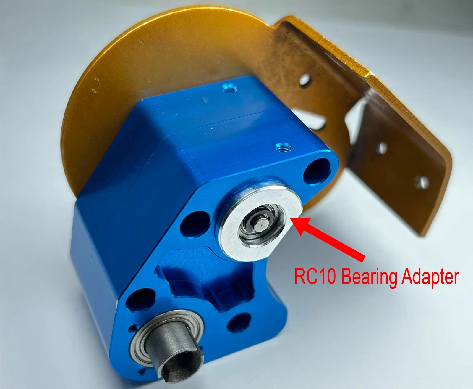

Need a particular ESC, and a bearing kit. Also thinking about getting the Dhawk 6-gear bearing kit.
https://www.ebay.com/itm/196184897363

The D-Hawk bearing adapter is not really necessary IMHO.
"Should I put bearings in this kit, or are there any other improvements I could make in the gear box while it's open?"
Bearings is yes.
The best investment in a 6 gear transmission is taking the burrs off the teeth of all the metal gears in the trans. All 4 metal gears.
The burrs left from manufacturing the gears can chew up those pretty new idlers.
Drag your fingernail across the gear faces and at the ends of the face and there will be a burr on both ends ( file sand polish ).
There is also a lot of excessive side to side play in the idlers and outdrives that can be dealt with.
Shims for the idlers and trimming the ends of the 6609 drive gear pivot about .010" - .015".
Check end play on the 6609 with calipers before trimming.
It takes time but 6 gears can be made to run like a Swiss watch.
Some more reading is here. https://www.rc10talk.com/viewtopic.php?t=44362
Chuck
