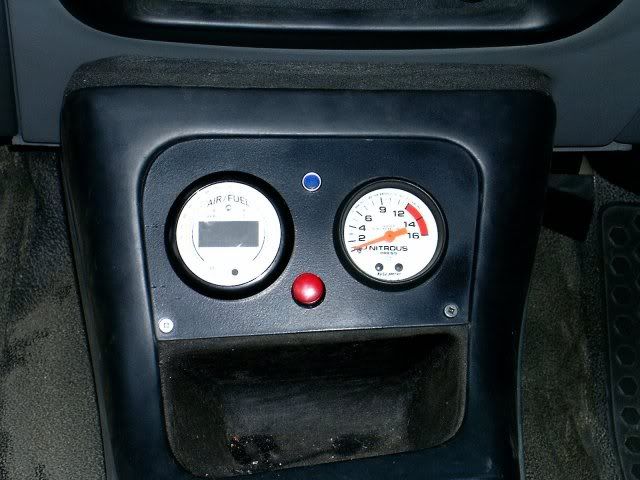

HI!... Ya I've used the SEM product with great results. I used it on my Taurus dome light, Explorer center console and overhead display., for my 07 Ranger.
