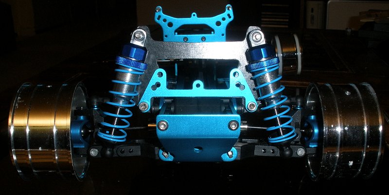

Custom carbon fiber front shock towers
Post by Coelacanth »
One issue I had to deal with, as a result of the shortened front control arms & CVDs, was shock length. One option was to go to short, dinky little shocks, something I didn't really consider because I wanted off-road driveability without major disassembling. The 3racing shock kit I bought had front shocks a bit longer than the stock Kyosho Golds, which was fine--I just had to fabricate shock towers to make them work. I had to think exactly where to mount the shocks, because the wide shock bodies & adjustment rings prevented me from mounting the shocks the same way the Turbo Optima shocks would've normally mounted. I had to position them more upright and out-board to clear the shock tower itself.
I built the tower from a spare piece of carbon fiber from DW911, thank you Dave! I gave myself a pair of mounting holes; one allowing the CVDs to be close to horizontal, and one giving me a good amount of offroad clearance.
I'll do more filing to clean up the lines later, I just wanted to make sure everything fit and worked nicely...it looks like my '70 AAR 'Cuda body will fit like a glove, even though it seems like the shock tower is so high. I cut out the body but have yet to sand the edges smooth...this is going to look killer when it's done! :twisted:

Some Christmas Eve updates:
-I cleaned up my front CF shock tower, and filed down some of the excess height where the shock bolts go.
-I custom-made mounts for body mount tubes using some spare Optima parts, the little angle pieces that attach the side-plates to the upper deck.
The last pic shows the range of suspension travel, which is pretty impressive even for the shortened control arms, and seems to show very little change in camber throughout the range of motion. I'll be setting up the fronts to have a more horizontal alignment than the pic shows, by using my shock tower's upper holes. The lower holes will work for the full off-road clearance.
