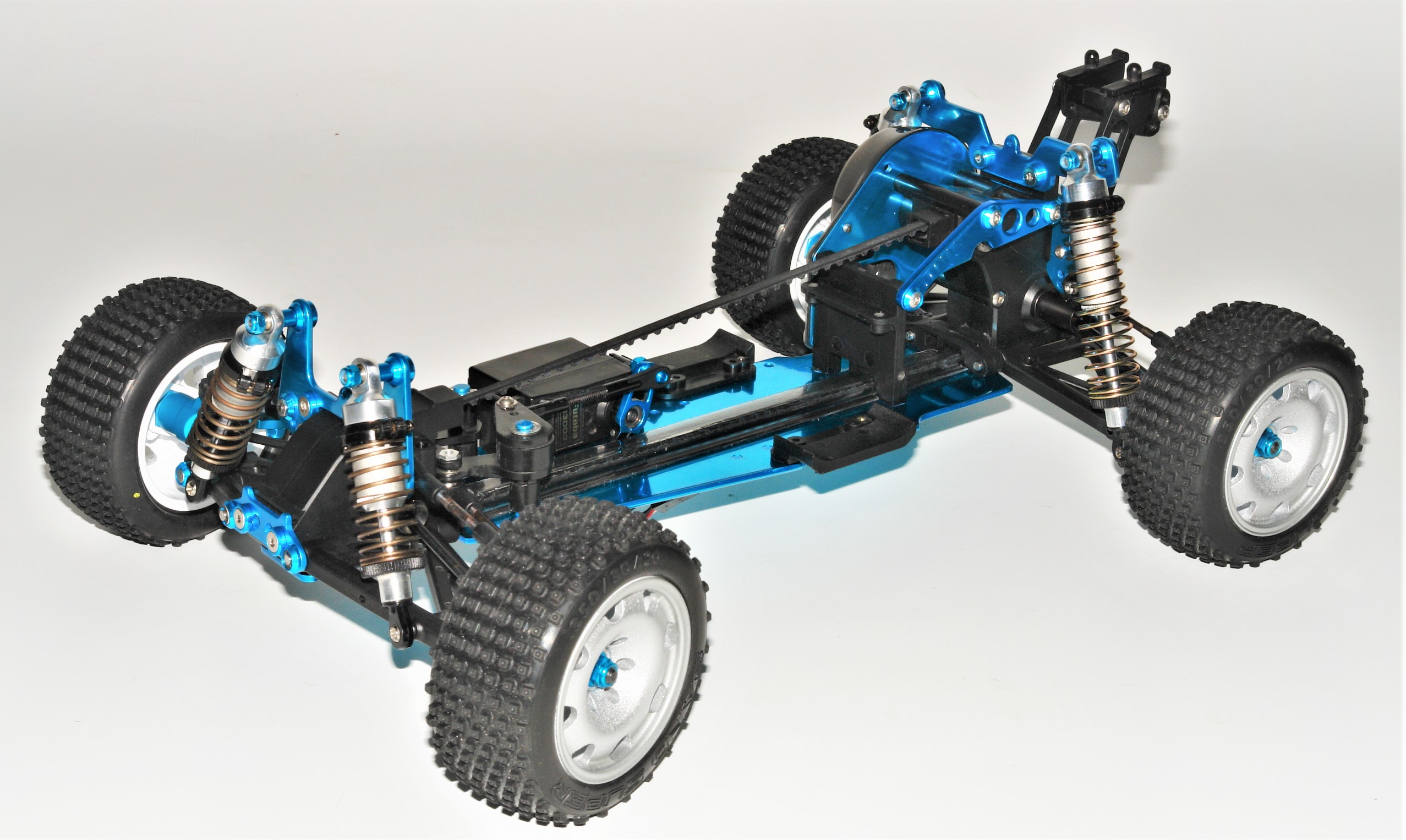

Still raining outside...
So a few more items added to the car.
Suspension and front CVs mostly.
Still need a few small items before thinking about motor, esc, receiver and wiring.
Chuck

Posted: Sun Apr 09, 2023 6:07 pm
by radioactivity
Started to test fit the upper belt covers.
Ran into a difficulty trying to get the nuts on the screws that hold down the front of the top cover.
My fat fingers just can't hold the nuts in place while screwing the screw down, particularly the four front screws. :x
Probably brought this on myself by using stainless hardware.
While off the car, I installed the small lexan cover that goes on the bottom front of the upper deck with servo tape.
I screwed the four front screws and nuts down snug against the lexan cover and heated the nuts with a solder tip.
This melted the nuts into the lexan leaving a nice hexagonal recess to keep the nuts from spinning while tightening.
A bit of CA glue locks them in place.
Overall it doesn't seem like much but for me it makes installing the cover waaaay easier.
Chuck
