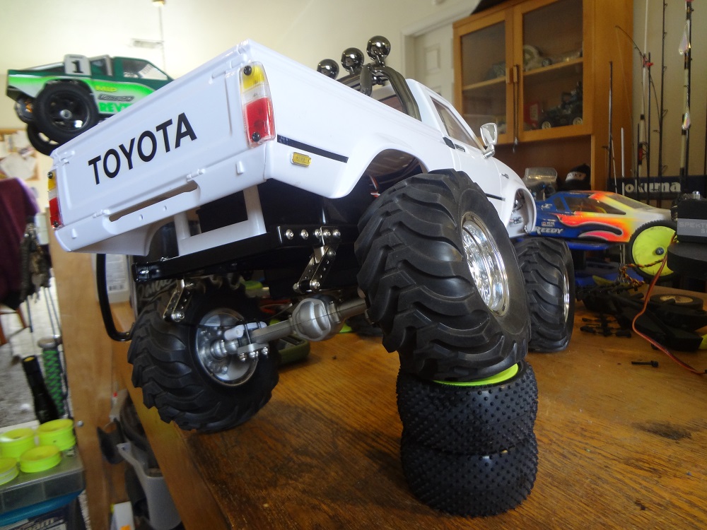

Photo's showing how it looks and how it can be tucked in for driving just in case .
I also tried adding some lead weight to help it articulate , firstly 400g under the battery , this made it top heavy so next i tried in the bottom of the radio box on the lid that covers the servo's as this lower's it down as far as it can .
This still made it unstable and it was better without it , so in short don't bother as it didn't work

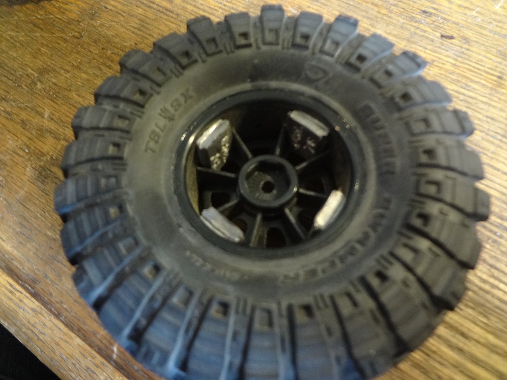

This is where you should add weight for better stability and articulation. Simple weights with foam tape on one side. Same ones we all use to add weight to our race cars or to balance planes. Cheap and very effective. These are 7 gram weights on the backside of my ascender wheels. 28 grams per wheel worked great on the ascender, but you can see I could have done 56 grams per wheel if I wanted, and these are only 1.9 wheels. I haven't done this to my HG yet since I'm still waiting on my tires to arrive but it looks like there's plenty of room to add as much weight as needed. The real reason the truck doesn't articulate is the shocks. I'm down to a single spring on all four corners and still have the stock shocks on the front until my new mounts arrive. With no shocks in the rear, this is how good it articulates now. It would be even better if the front shocks were removed.

I have some of those weights coming so i'll give em a go . My articulation at the rear is pretty much like yours .

Nice! You've got that suspension working real good. One of the downsides I see to removing all the leaf springs is that my truck sits lower now. By swapping in the HR shocks with the internal spring, it should raise my ride height back up. Now I'm just waiting while my tires and shock mounts slowly make their way here in the mail. I did end up locking the front and rear axles and started to replace all the factory screws with the stainless ones.

My springs are as follows at the moment .
Front
Removed coil spring from shock and shortest leaf removed .
Rear
Removed coil spring from shock and the mid length leaf removed .
I've ground the leaf ends all round and opened up the bottom eyes on the shocks all round .
This is working quite well for me .
Front
Rear
