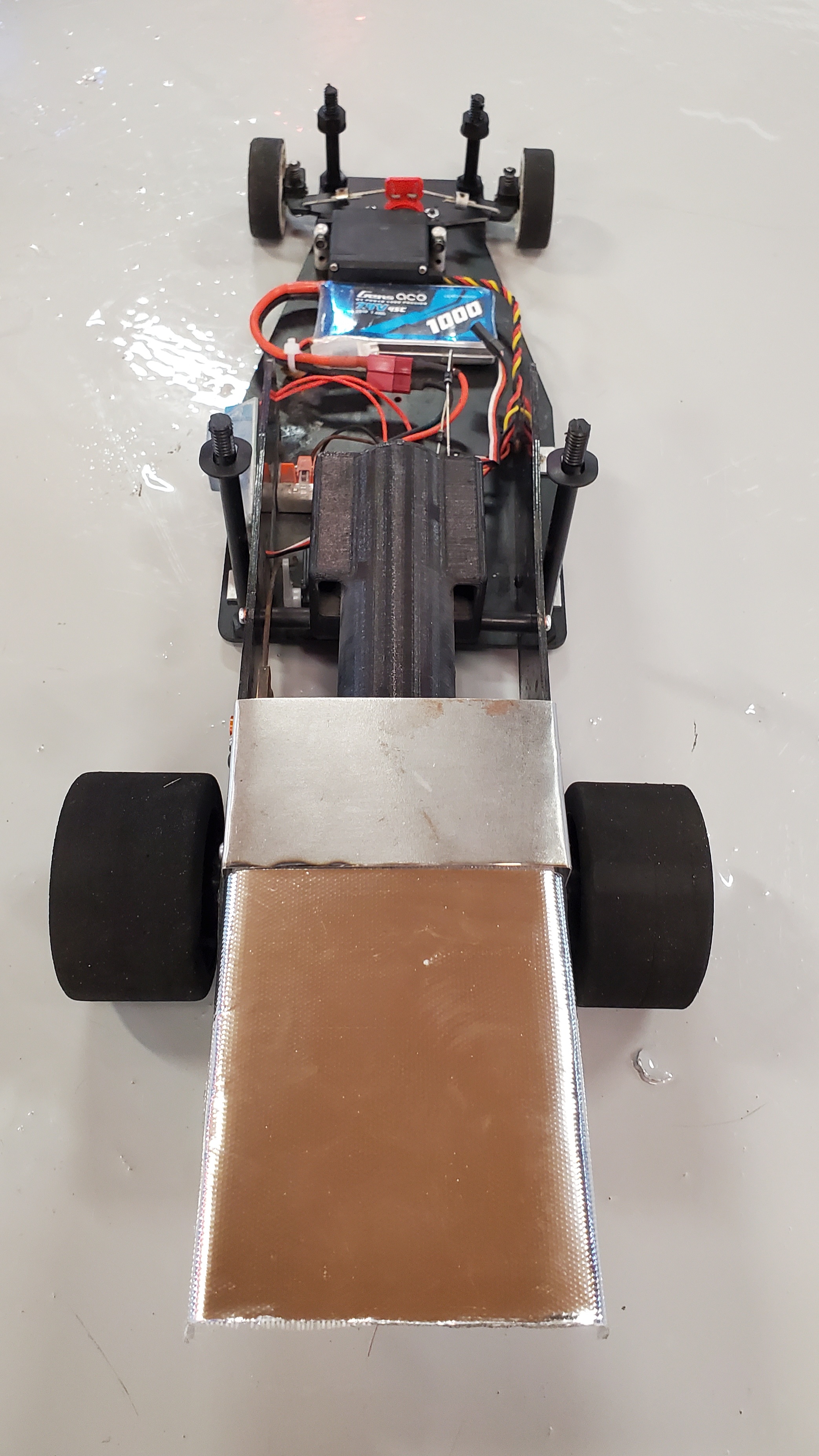

That was the final dual engine run for now...making changes...extending the wheelbase an inch (12" to 13")...going "F" single engine (which worked great the two times I ran them)...going with a new body, narrowing the front end to tuck it under the body...and lastly, moving the engine mount forward and inch to help push more from the front than the rear...if it all works...should run 88mph in 3.5 seconds....100mph is out of the question for now...thanks to everyone that is following this build

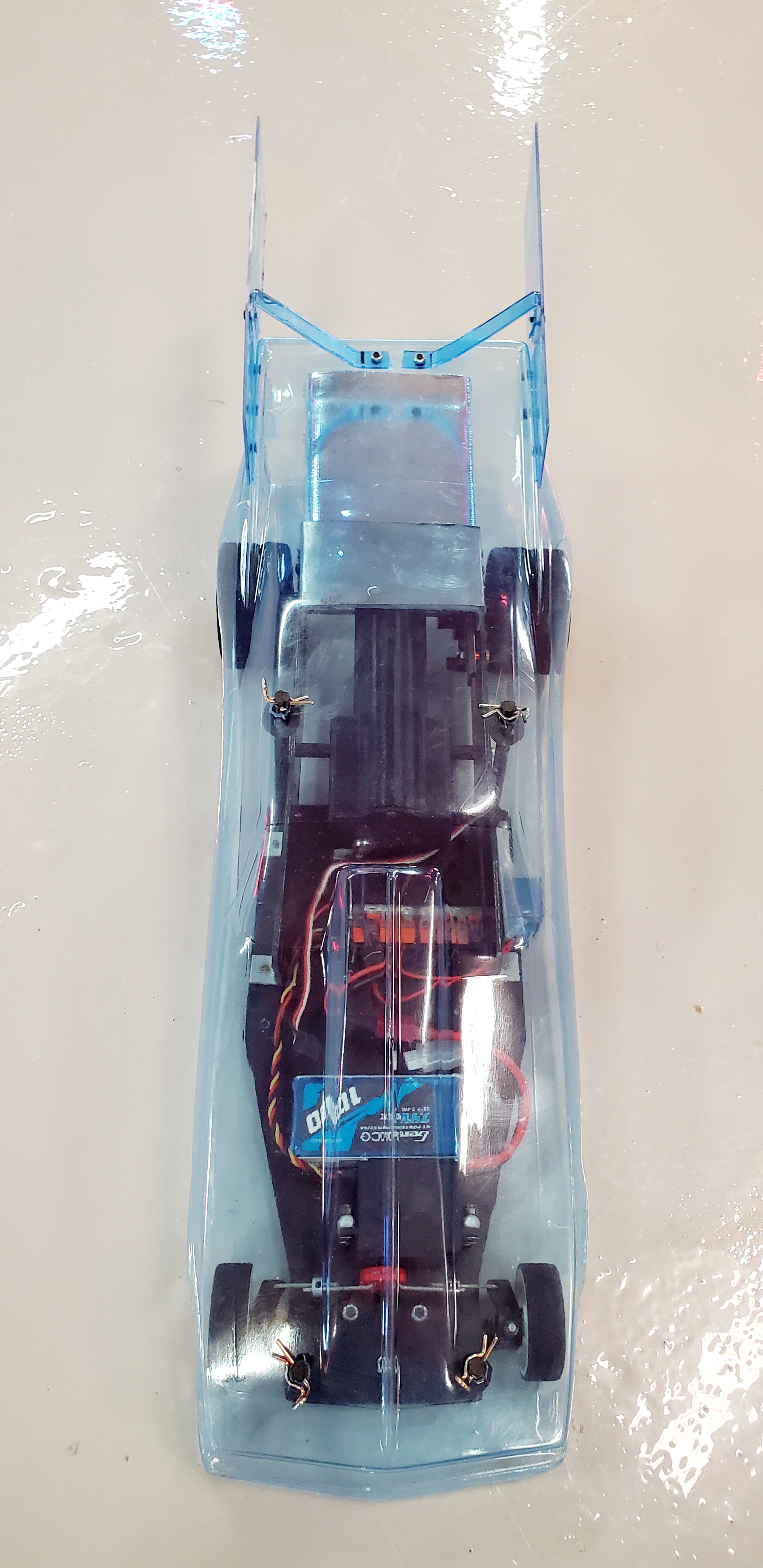

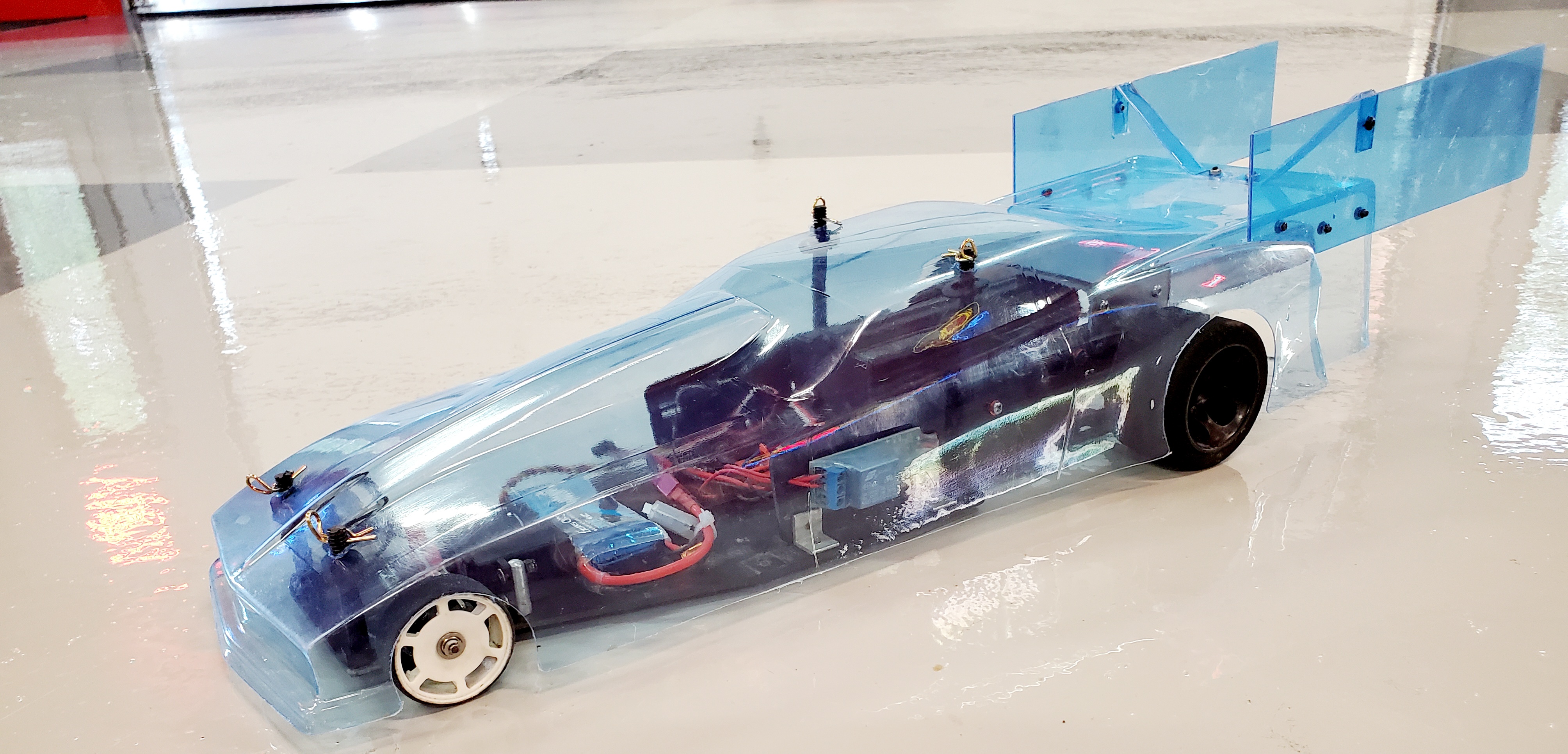

All redesigned...2.19lbs as it sets

Turnbuckles on those side slats would make them trim tabs in the event that the car consistently pulls to one side or other.

1911Colt wrote: Tue May 16, 2023 12:12 pm Turnbuckles on those side slats would make them trim tabs in the event that the car consistently pulls to one side or other.
Plus it would look cool!

coxbros1 wrote: Tue May 16, 2023 11:46 am All redesigned...2.19lbs as it sets
Just makes me grin every time I look at it .
