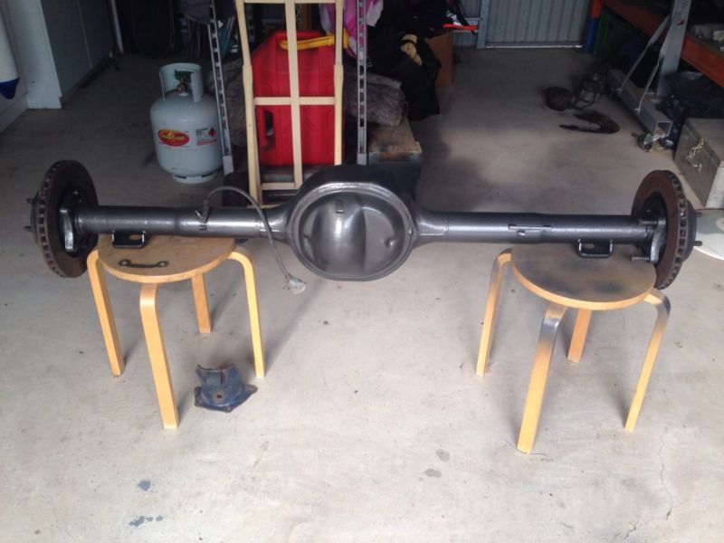

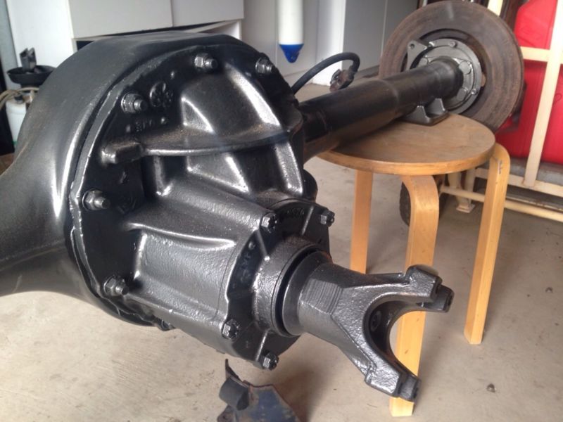

I bit the bullet and bought a Ford 9", It's not as nice as Todds but it will do for me. I wasn't planning on buying a new axle at this point but it just happened that it popped up not far from me at a good price, and was everything I was looking for. I couldn't refuse as something like it would NEVER pop up again. It is a 100% direct bolt in without any modifications. It's the 3.5 ratio I wanted and is a limited slip. It is also set up with the disk brakes flanges which my calipers and stone guards fit.
I was quoted about $600 + gear set to replace and set up a new ratio in the Borg Warner diff. For about double that I got the 9", even if I found another 9" with disk brakes and a direct fit for my car I'd still have to replace the gear set.
Win Win.....
I'll have the calipers rebuilt and will replace the rubber and hard lines. I will also replace all the spring eyelet, shackle and spring saddle bushings.

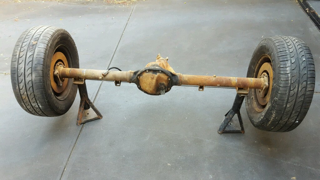

Just for fun this is the type of diff currently in the car. Look at the difference in pumpkin size :lol:
I'm already looking at more power.
