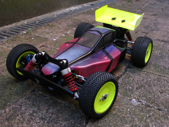

Diggin up the old thread to show how the dark dog sits on the shelf now.
The yokomo wheels have been back on forever , body was painted and has been waiting for something to cover for some years... but last week I made some effort and added B5m wing mounts and a fresh painted spoiler and put it all together. It's a return to its roots perhaps, but I always loved it , so there's no harm in that.
The B5M mounts are perfect and cheap
I probably need to move the wing a little further back: about 10mm as it is almost impossible to remove the body now without removing the wing first :oops:
