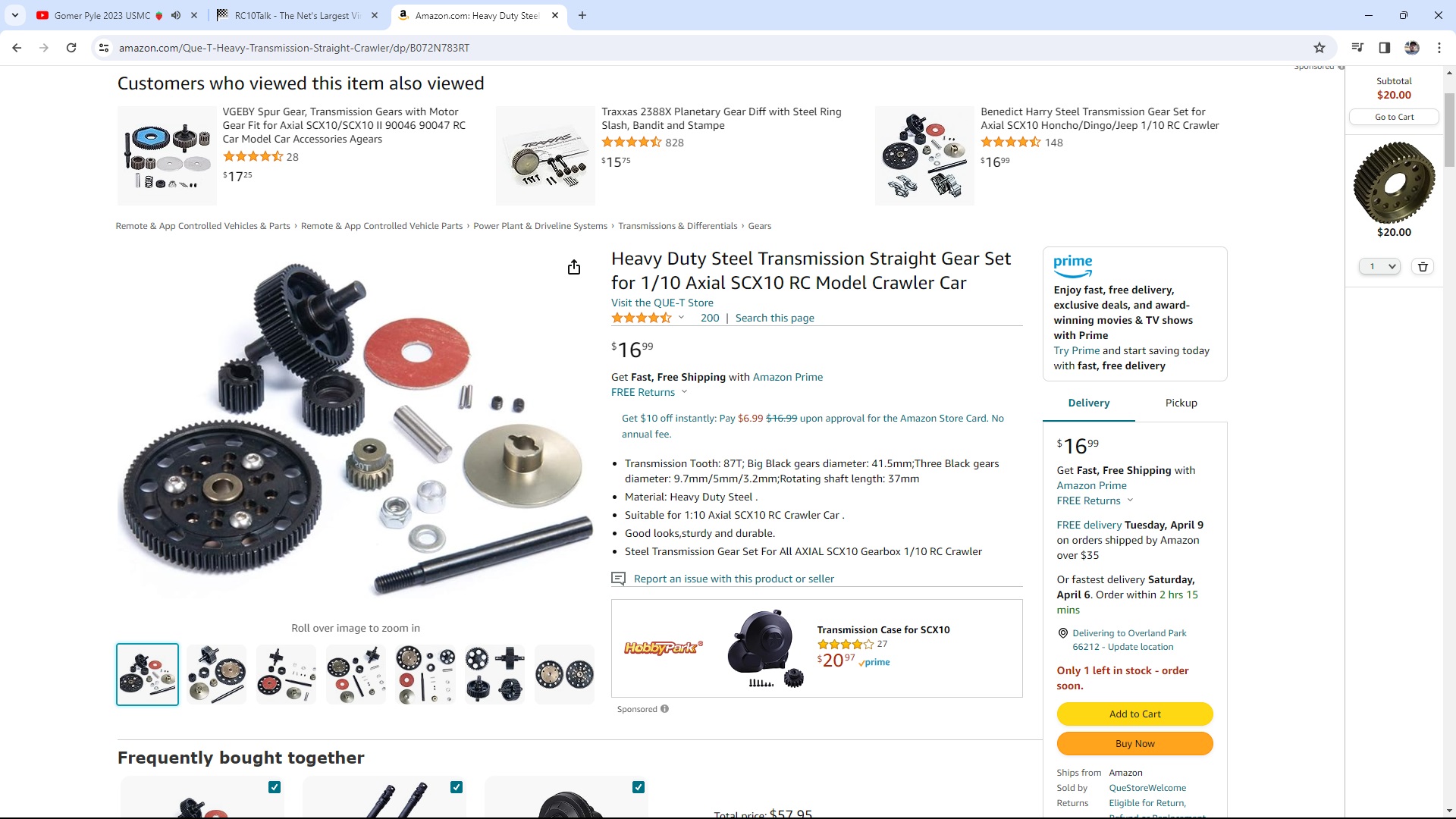

well making progress on building one with a diffless transmission lol .at 17$ for the complete trans its pretty tempting even with no diff .

good to know . a bunch of the members on the fb page are screaming "no diff" like its a big deal lol . it will steer like crap but as you said its a basher for my son he is 7 and could care less lol. people forget they used to run old new bright toys as a kid that had 0 suspension, and a straight drive axle lol and loved every second

discgolfer72 wrote: Fri Mar 22, 2024 12:09 pm well making progress on building one with a diffless transmission lol .at 17$ for the complete trans its pretty tempting even with no diff .
The next time you disassemble the transmission, could you please measure the dimensions of the "no- diff " gear?
- width
- diameter
- bearing size
- tooth count
Does anyone know what pitch Axial uses?
Perhaps a fitting diff can be found from a different brand.
Otherwise great work.
That purple / orange setup is screaming for a Joker themed body ;)

someone chimed in on the fakebook page and said you can use the tamiya hbx diff but you have replace the bearings (they have standard dogbone style outdrives). this should be th e gear set for the scx10 gearbox
looking at this one it has screws to remove the outdrives im sure its could retrofit a ball diff setup

discgolfer72 wrote: Wed Apr 03, 2024 10:49 pm
someone chimed in on the fakebook page and said you can use the tamiya hbx diff...
Are they referring to the TL-01?
Googling "tamiya hbx diff" yields many posts for an HBX clone of the Tamiya TL-01.

XLR8 wrote: Thu Apr 04, 2024 10:03 am
maybe bbx . dont know tamiya models at all

discgolfer72 wrote: Thu Apr 04, 2024 1:06 pm
Hmmm.
Well, looking at the manuals, the BBX and Axial diff gears have the same tooth count and both appear to be 48dp. According to the Tamiya experts on TC, the BBX uses a TA06 diff so if it fits the Injora trans, this could offer a gear diff option as well.
https://www.amazon.com/TA06-Steel-Gear-Diff-Unit/dp/B00AZFZJ1U
More research is needed. I have a BBX, Axial and Injora transmissions but I'd rather not tear into them at the moment.
Imagine a TA06 diff dropping into an AE Stealth case -- how crazy would that be! :D
EDIT: The Stealth diff gear is much smaller tooth count so no chance replacing it with a TA06. Anyway, curiosity got the best of me and I've opened the BBX and Injora cases and discovered the diffs are interchangeable after swapping out the bearings; Injora requires 16x8 while BBX uses 15x10 (easily sourced). But there's a problem. With bearings, the BBX diff assembly is maybe a couple mm's wider than the Injora so it won't allow the case halves to close. :?
