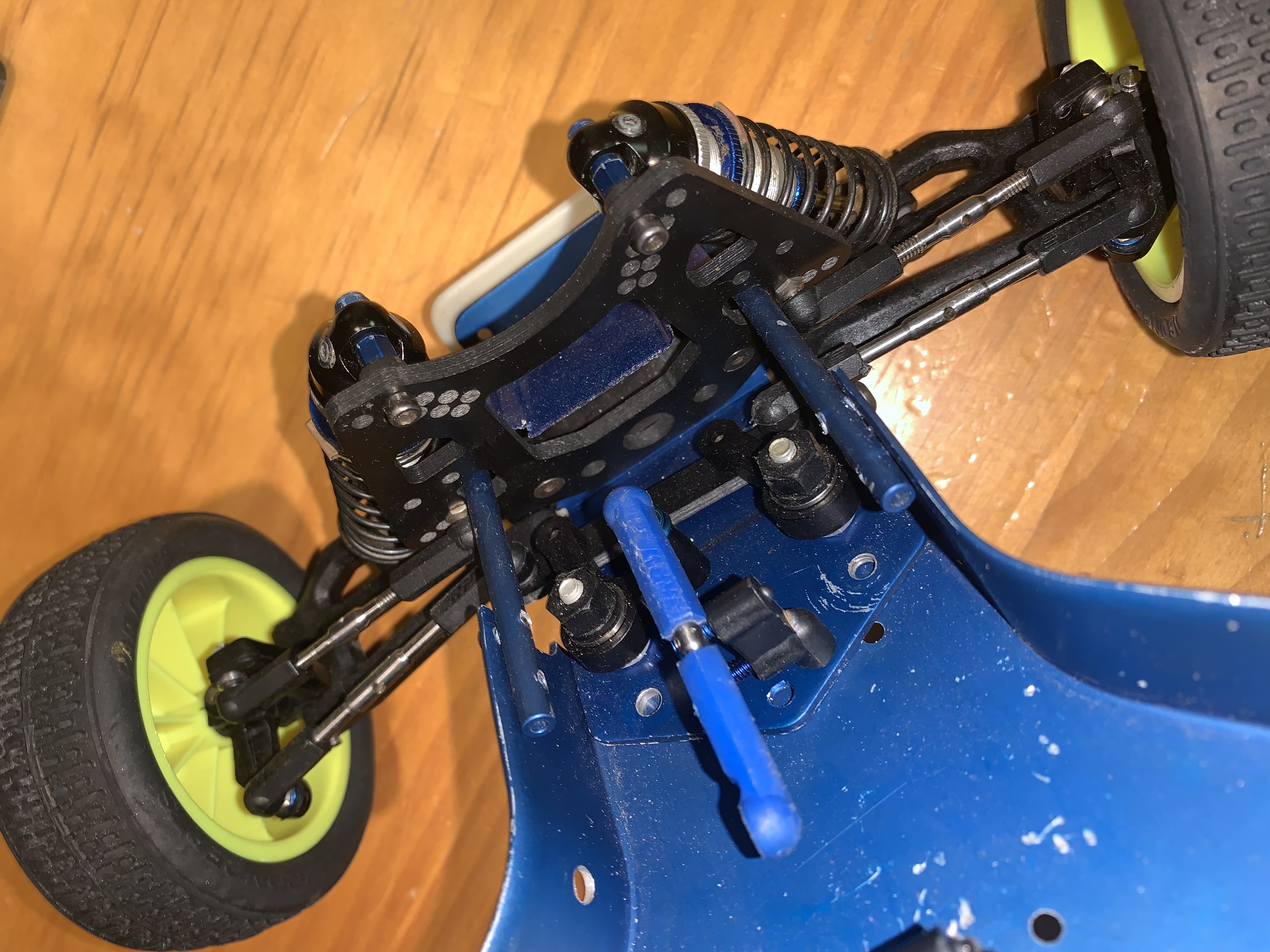

by MarkyDents
Hey is that this tower Jeff ? Sorry I know the pic is a terrible angle….. it’s all I’ve got atm
![Surprised :o](./images/smilies/icon_surprised.gif)
Re: RC10 C stamp resto custom
Posted: Sun Aug 13, 2023 7:09 pm
by juicedcoupe
MarkyDents wrote: ↑Sun Aug 13, 2023 6:21 pm
That is a 10T oval tower, for lowering a truck and using buggy (.56 and .71) shocks.
The Quadra tower looks like a shorter RPM tower.
