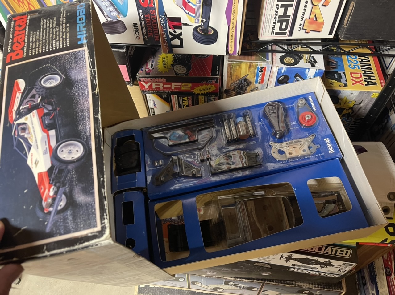

Well… I made a mistake. Mine is a Bearcat not a Tomcat. If those items are still of use I can help, but being a kit I can’t mount the body or wing. I’d be happy to help with all I can though.
Nice one you have here :). As you have that one, I assume you have brand new tires. Mine are depleted so it is difficult to take the measurements of the spikes, so would be good to have a picture (put ruler next to it, profile and face picture)...
