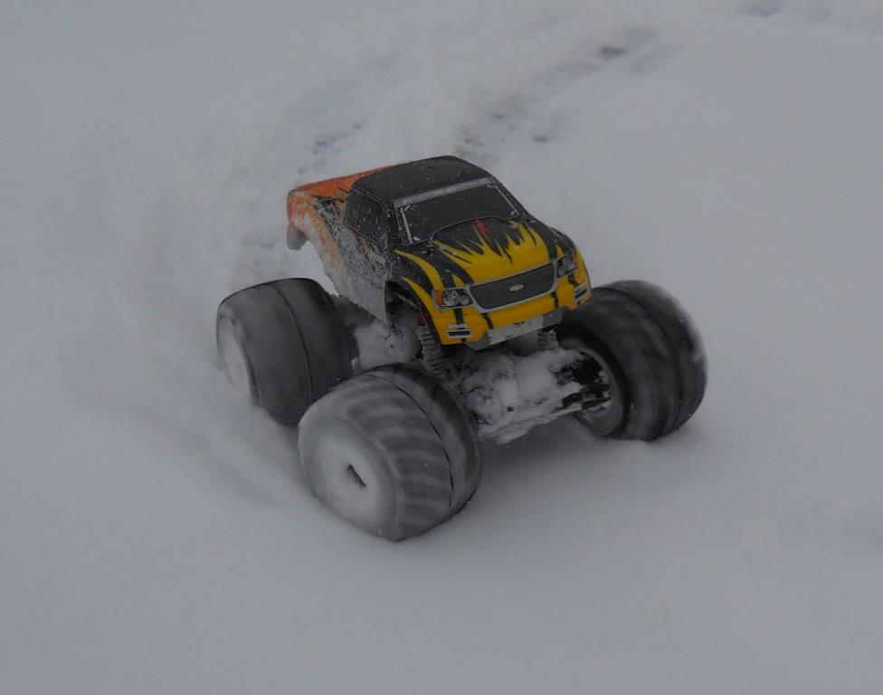

I think one of the biggest reasons I revived the Super-Stocker was because the "T2 Terminator" build I had done was proving to be not as good in the snow. It was heavier and the metal chassis and suspension would gather snow a lot faster. It's ironic because years earlier I had dismantled the Super-Stocker and put it's axles under the Terminator, and now the tables were turning.

By 2018, I finally got around to putting a new body for the Super-Stocker.... about time since it had never had anything but a used one on it.
Unknown body (I got in a parts-lot), I think it's a pro-line Tundra body for the t-maxx 2.5 if the writing on the bag it came in is to be believed. It came with only window masks, no body stickers, so I dug into my stash and came up with this, I was going for a little bit of Ford Raptor with the front-end. Not sure if you can see it, but the wheel openings are custom-cut to make the wheel base work. (there are still lines from where I was supposed to cut)
