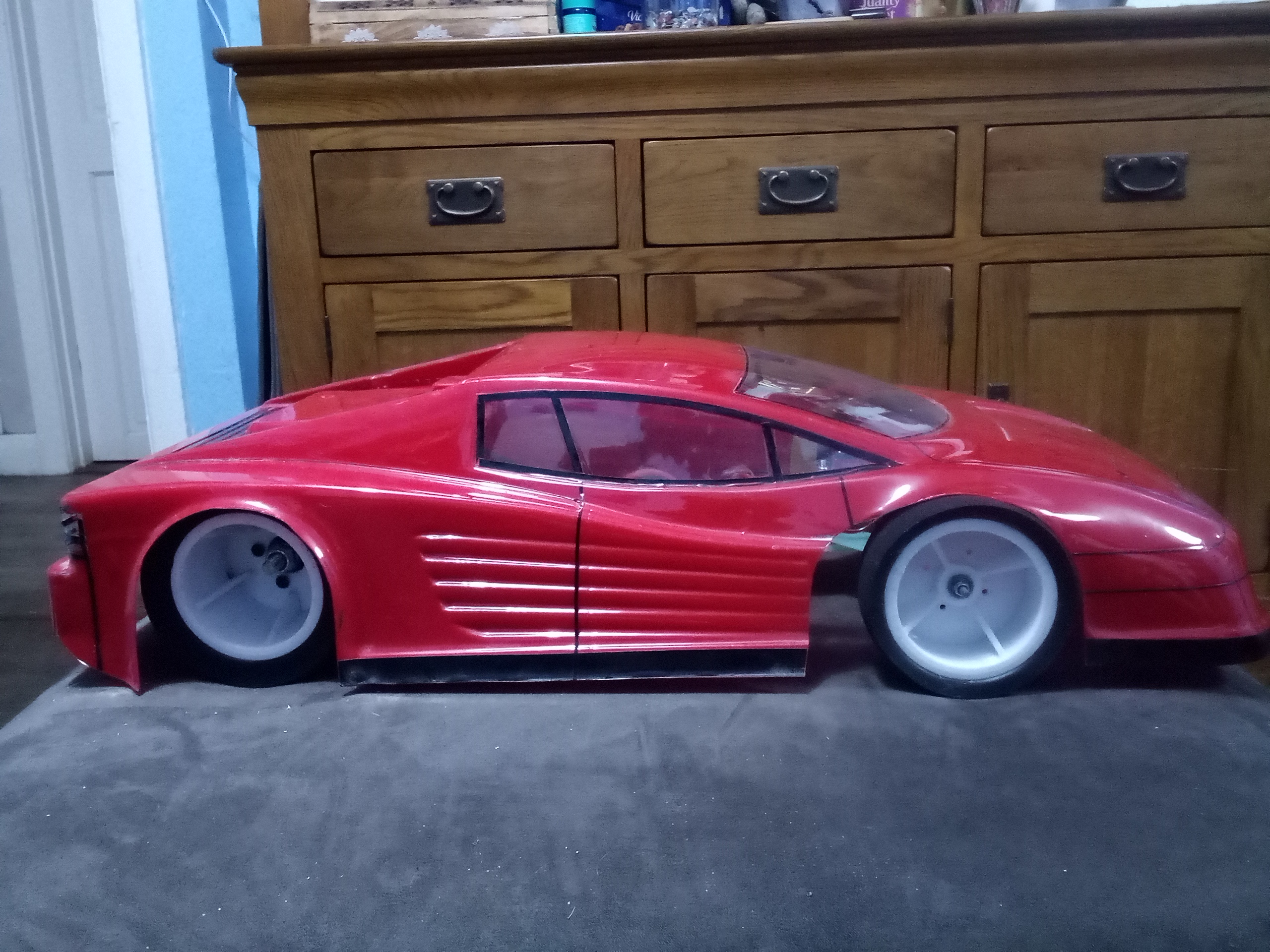

by Dadio
This is a possible body choice , it's been kicking around for a while after coming with a PB Mini Mustang
