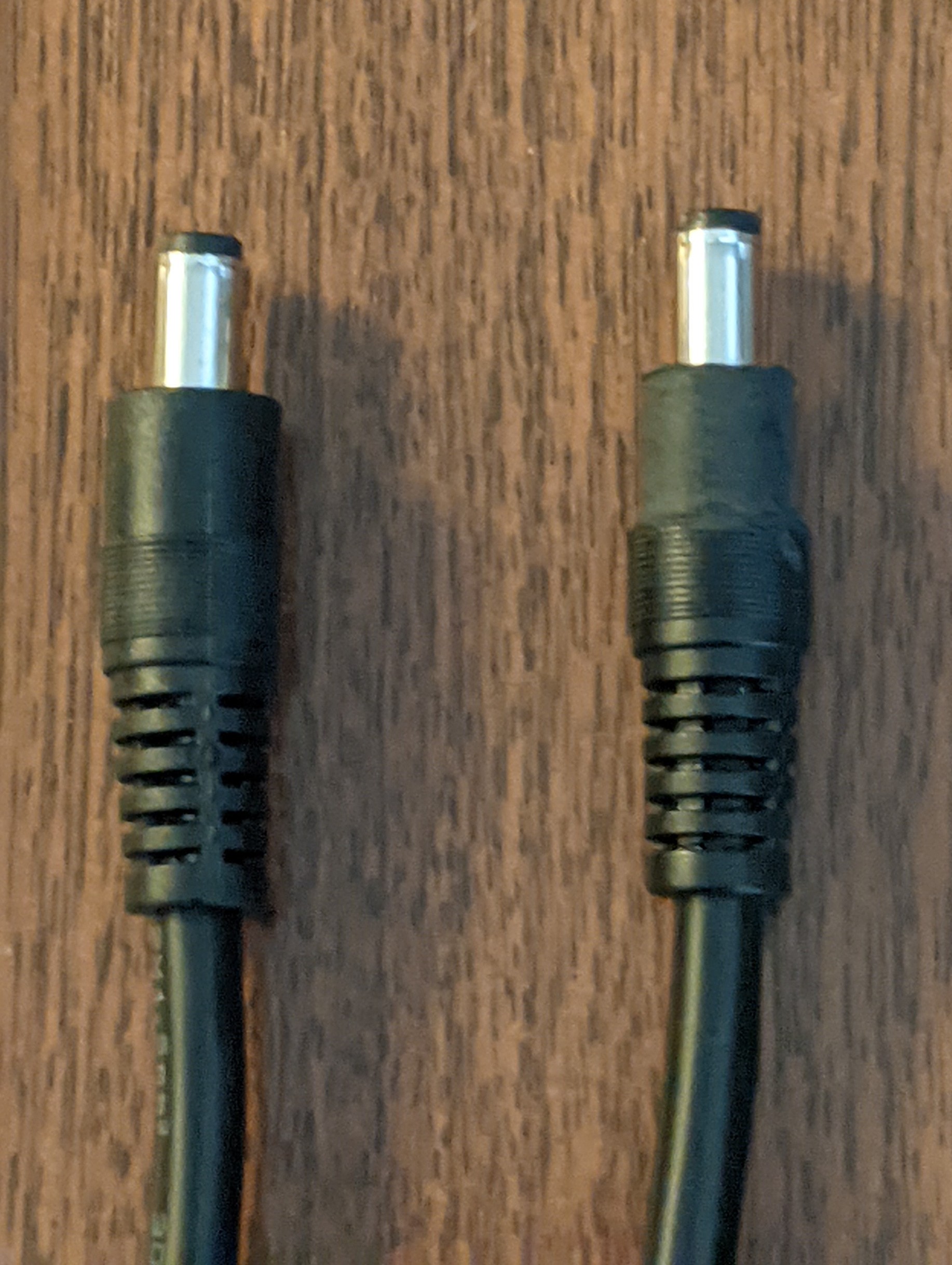

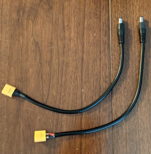

I've noticed that several of my Futaba radios have a jack on then for plugging in a power adapter. I assume this to be for using rechargeable batteries? Does anyone use this? If so, do you have any details on which make/model of power adapter you are using? Are you using a battery pack or rechargeable AA batteries?

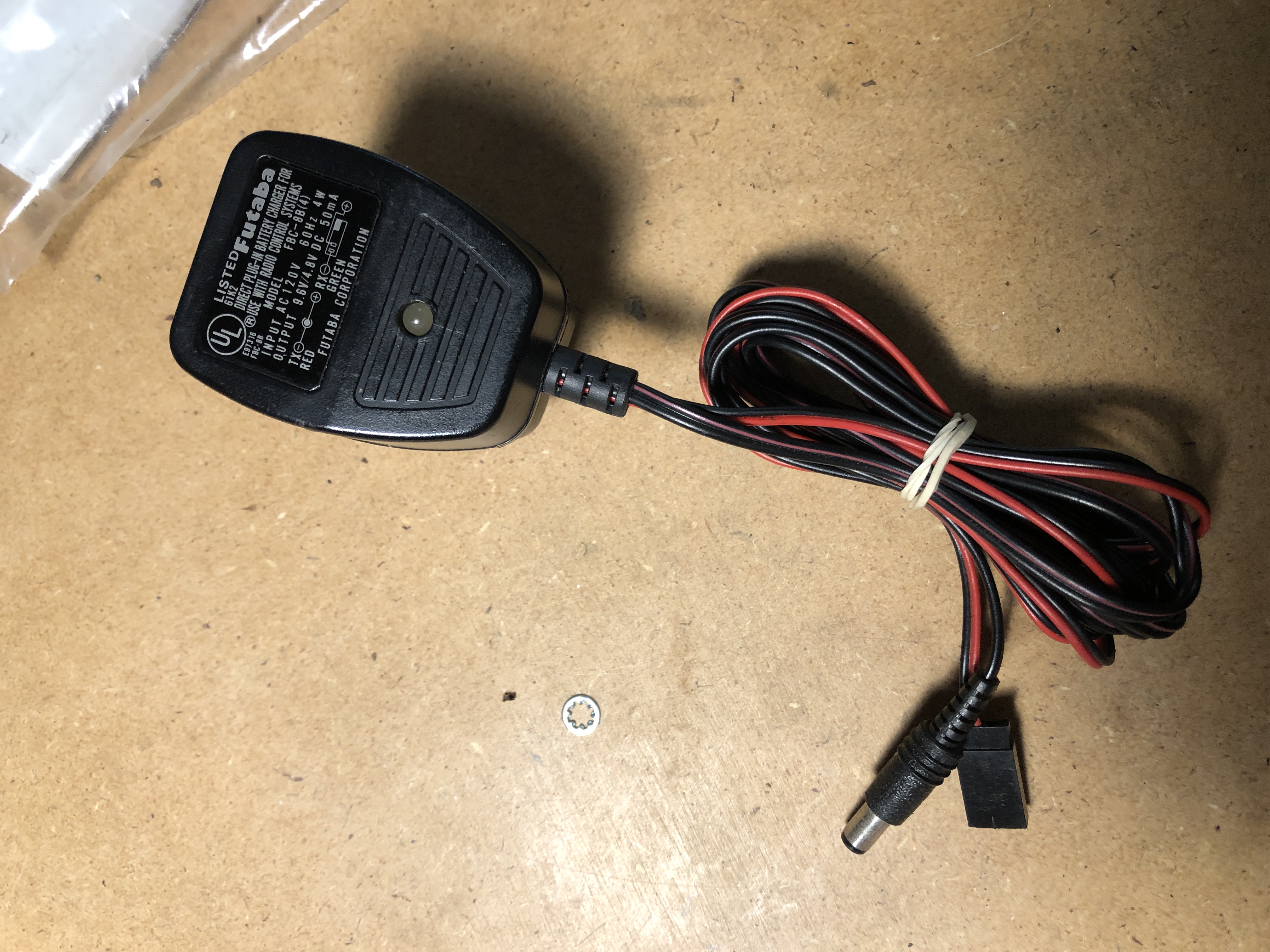

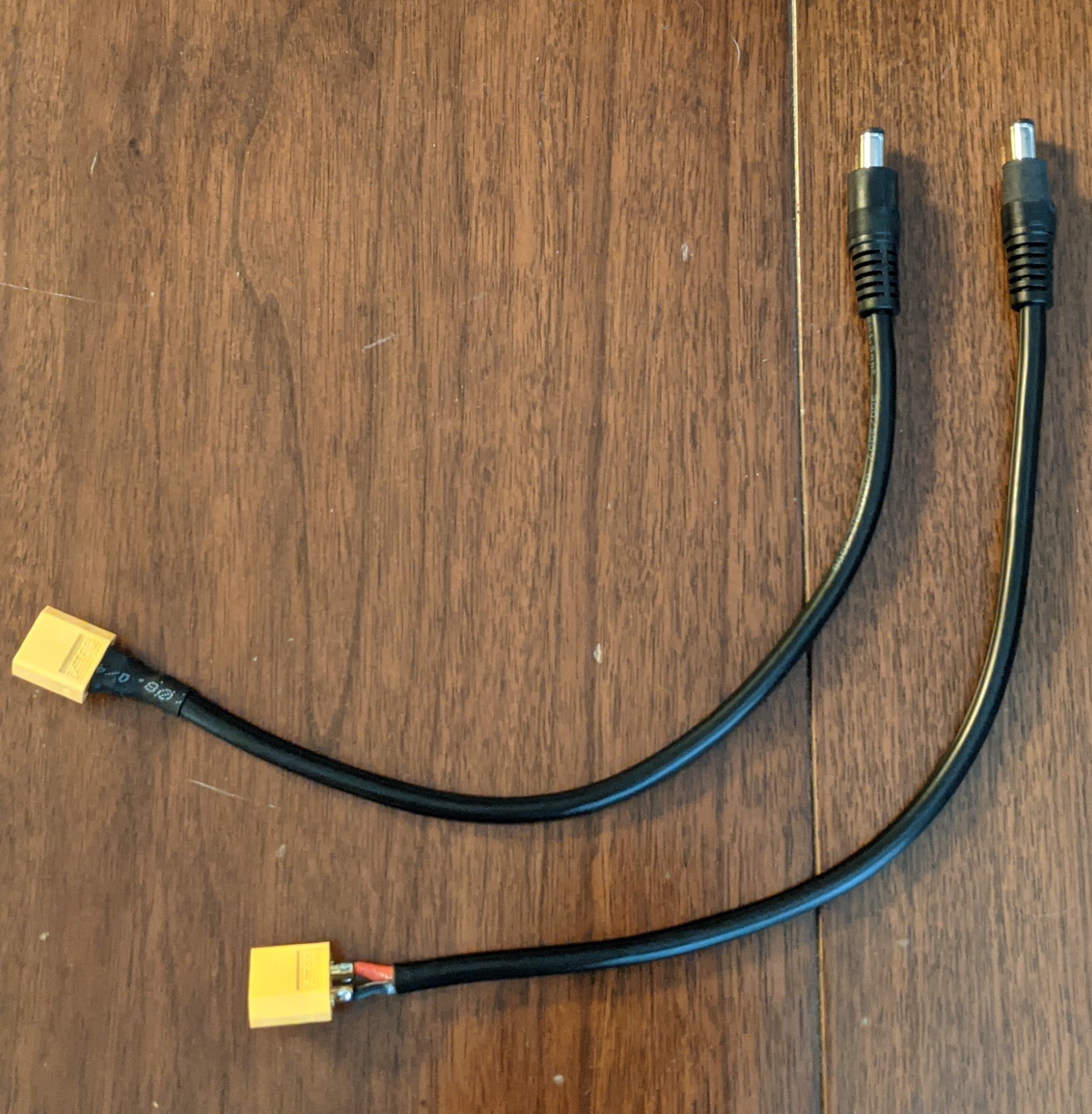

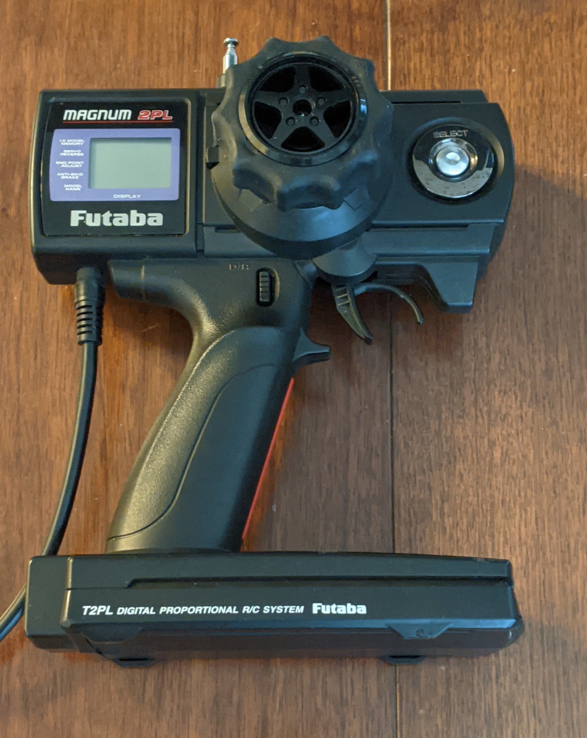

I think I've determined that the Futaba radios take a 5.5mm x 2.5mm DC male plug. There were some pigtails on Amazon that seemed ok, although they needed a connector change and a little shaving down to fit the recessed jack location on my 2PL radio. A file does a nice job of shaving down the molded plastic.

Just double check plug polarity, most are generally center pin positive but from memory JR might have been the opposite with the centre pin as the negative.

RC10th wrote: Sun Oct 03, 2021 7:59 am Just double check plug polarity, most are generally center pin positive but from memory JR might have been the opposite with the centre pin as the negative.
Continuity checks show the center of the adapter is to the red positive wire, outer is to the black negative wire. The adapter negative connects to the last AA battery negative with minimum resistance. The adapter positive connects to the first AA battery positive but with 165k ohms resistance. This makes me wonder if there is some circuitry in the radio fo charging. If so, then maybe I need to use only NiCd batteries? And maybe I need to use only a power supply instead of a charger? Any thoughts? I've never changed batteries inside a Futaba radio before. There was a Duratrax kit for this (DTXP4010).

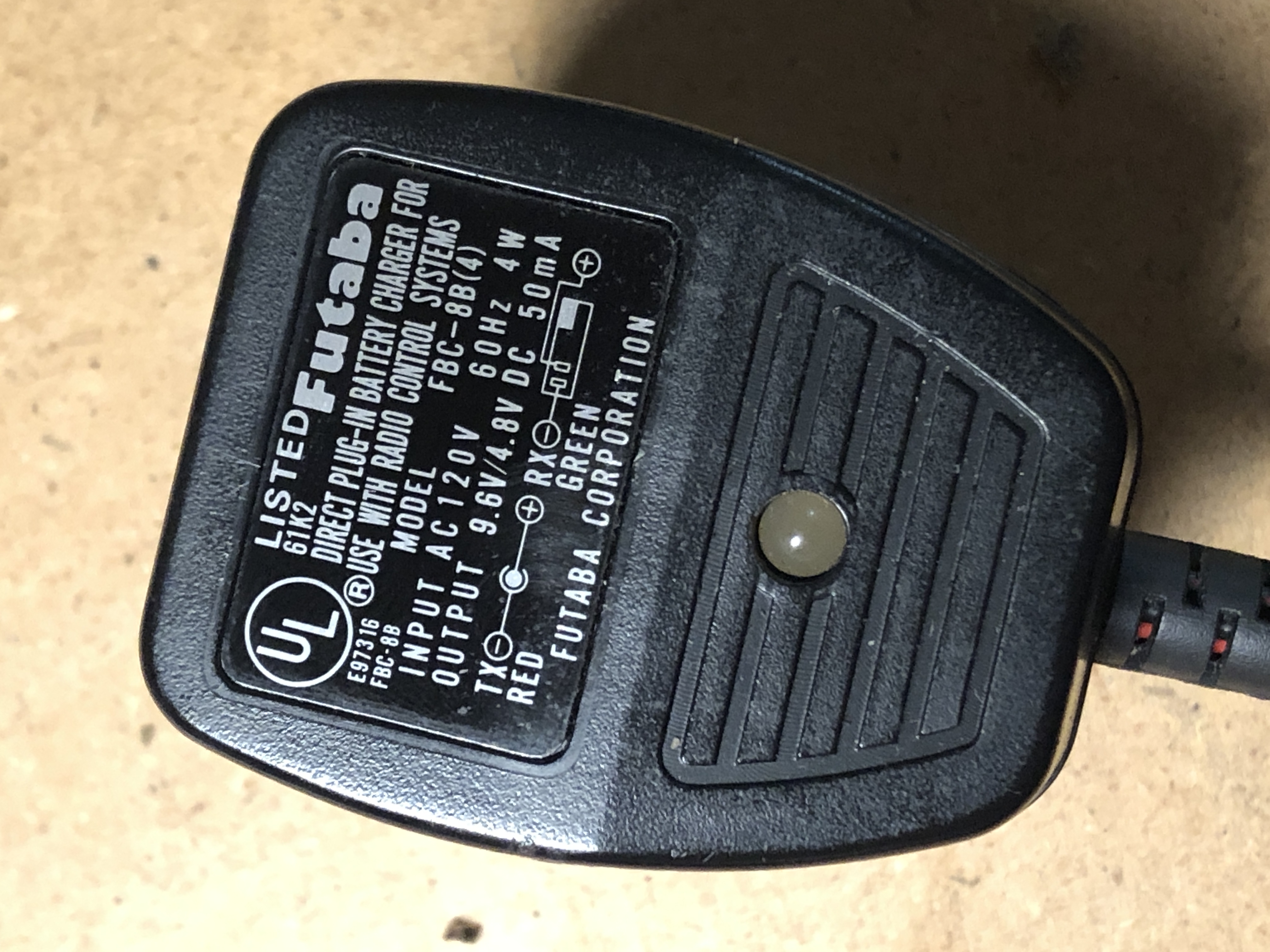

Frankentruck wrote: Sun Oct 03, 2021 11:15 am
I checked an older Futaba charger I have (model FBC-8B(4)), and it helpfully shows a diagram on the label that also shows center pin positive. This charger connects directly to a NiCd receiver battery, and i believe the same is true for the internal NiCd in the transmitter (FP-7FGH), so in this case, no charging circuitry in the TX. I don't know if that may have changed with newer radios though!

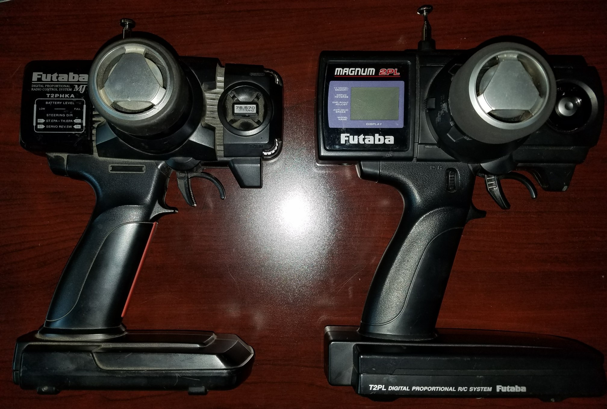

Got these two ol' boys. Haven't used either yet but both work and I will use them when the times comes. Until then, they're just nostalgia display pieces.
