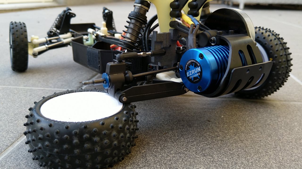

This is now my setup for astroturf:
-NIX63231 MJF-bulkhead made by i.materialise.com
-ASC9826 gearbox
-B6 Gear Diff
-CustomWorks 3241 rear hubs (It's like RPM '91 conversion hub)
-Stock rere-RC10 Worlds axles, bones and spacers.
-Stock rere-RC10 Worlds arms and inner mounts
-Stock rere-RC10 Worlds rear shocks with just 1 shim inside the shock.

Setup is now pretty much perfect, only thing I would like to improve a little is on power steering, or the lack of it. I seem to be overly cautious with the car as I don't want to break it but it still is much faster than I thought it would be. And very easy and predictable to drive. Gear diff is working really well on astroturf.
And when I gave it to hands of "local senior junior", a frequent a-finalist, it really showed some potential. Here are his first ever laps with the car:
https://youtu.be/fVEjqW6YmHs
And here's some lap time comparisons with his B6.1. Not bad as this is the first time in 20 years he's been running a rear motor car and took it a bit easier than with his own car. Graphite on the left, B6.1 on the right.

I still think it’s great! Combined with Niki’s rear arm mounts, traxxas arms, and b4.2 hexes it’s a superb handling package. I have only run the car on turf but see no reason why it wouldn’t work on carpet also.
