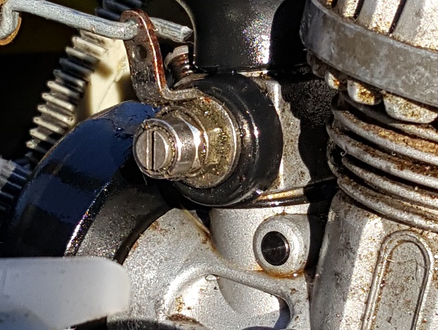

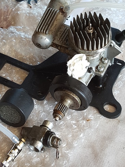

I'm suspecting the carb isn't seated properly. Gonna be a pain to get it out/in though... might get to the bolt if I remove the silencer and have a good spanner, otherwise going to have to remove engine plate :(

Well that's definitely not right, fix it first and see how you go.

RC10th wrote: Mon Aug 26, 2019 8:18 am Well that's definitely not right, fix it first and see how you go.
Yeah, looks like more of a scarf than an O-ring! :lol:
Edit: Might try to get it at least starting & idling reliably on the bench whilst it's out.

Carb re-seated this morning, and it's now holding the prime.
After re-reading (properly...!) the various guides on tuning, it turns out I need to start with the HSN, not the LSN as I'd been fiddling with. ("Setting it up at idle, that'll be the LSN" I thought. Intuitively I thought, but wrongly!! :oops: )
A click or two on the HSN has made all the difference to getting it started, and it also keeps going without the igniter. And it revs up and down with the throttle rather than just lumping along regardless. Major result. :)
