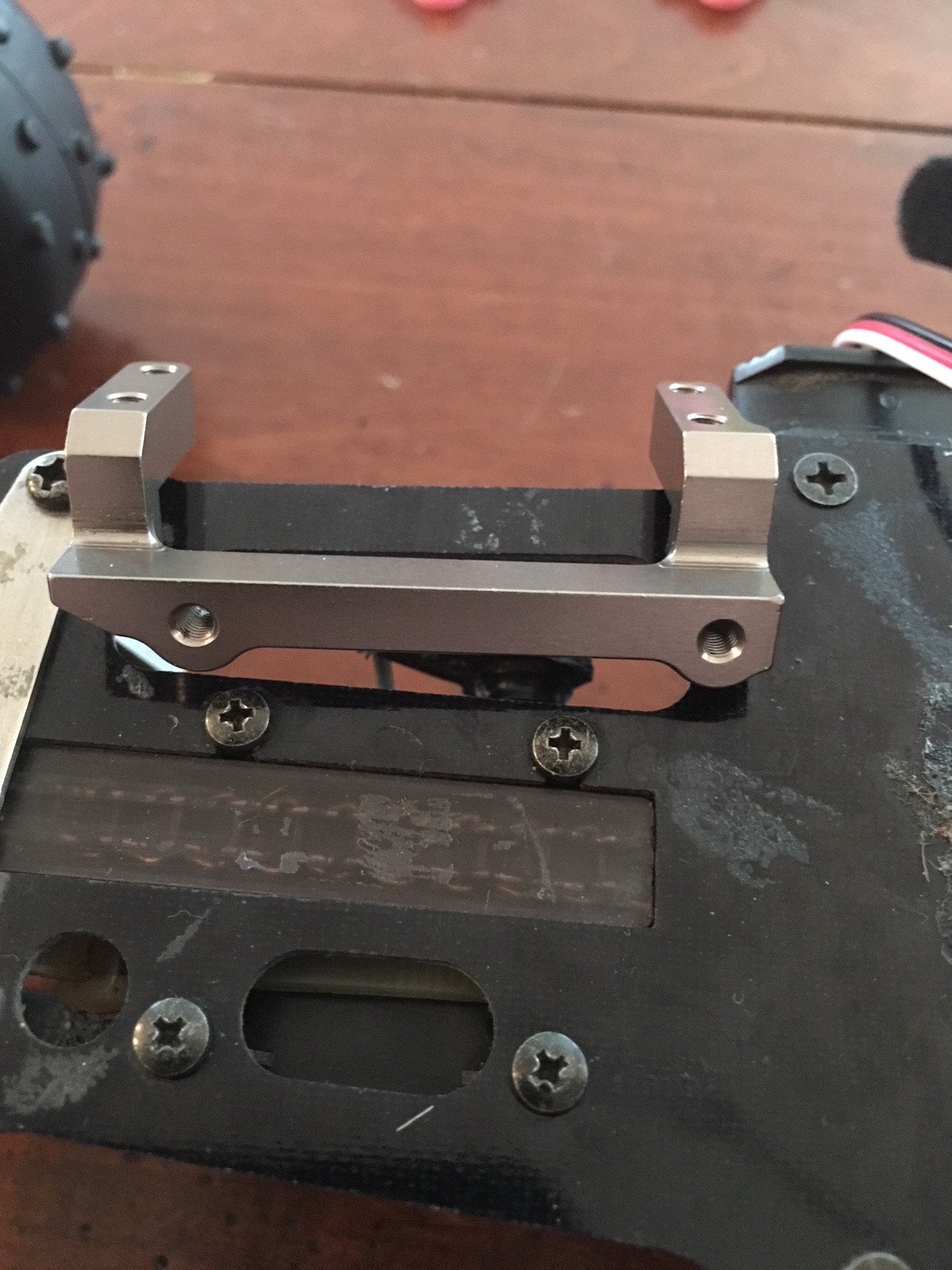

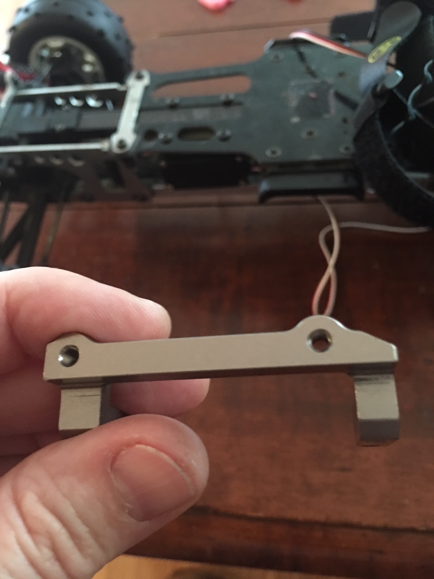

The metal servo mount arrived, and it's nice.
However, it does not fit the screw holes on the base plate.
I'm debating whether to drill through the plate to be able to mount it. As of now, the servo is mounted with tape onto the plastic piece that hangs down. It works, but the servo shifts around a bit when the wheels are moved. Probably not worth a major effort, but I'm just wondering how difficult it would be to drill through the plate and if it seems like it would be easy to destroy it by doing so.
Re: Optima - Servo Mount
Posted: Fri Jun 15, 2018 10:59 am
by DennisM
You´ve come to a crossroad - either spend a small fortune on re-re radiodeck, gearboxes, diff´s, gears, belt and slipper.
Or buy a new kit.
Other thing you can do, is keep the original as is, buy a re-re radioplate and run it with a mild motor setup.
