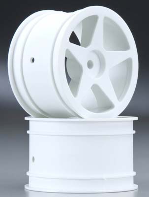

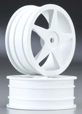

I haven't even started my vintage Losi yet, but this is a subject I have thought a lot about. (for my Ultima Pro) The way I see it, a Losi buggy should have spoked wheels, none of this dish stuff. (I LOVE the original JRx2 5-spokes!) I've seen the Rulux wheels and the look nice on the car.(Not faithful,to the original, but better than a dish). The XX 5-spokes I also like despite the width issue.(I campaigned a XXcr for many years.) Her's what I think I'm going to do. RB5 carriers and axles and such, and then these wheels: I think a nice light orange dye job would be good too 8) .
http://www3.towerhobbies.com/cgi-bin/wti0001p?&I=LXXSA0&P=7
Oh, you'll need a 12mm hex on the rear as well, and a set of these:
http://www3.towerhobbies.com/cgi-bin/wti0001p?&I=LXXSA1&P=7

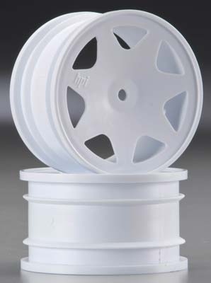

I've heard that the RB5 carrier adds a little width, so that should help the problem with the XXcr wheel, and if more width is needed, you could use the rears up front, cut to width of course. (You can see that the rear has a little MORE offset than the front.) Also search for the Ultra 7 wheel from HPI - it's a combination dished/spoked wheel, looks good, nylon material, comes molded in a few colors already. (A little more like an Ultima wheel.)

Nice pull on the 5 spoke HPI wheels. If I wasnt converting all my buggies to B4/Rulux wheels, I would be all over that.

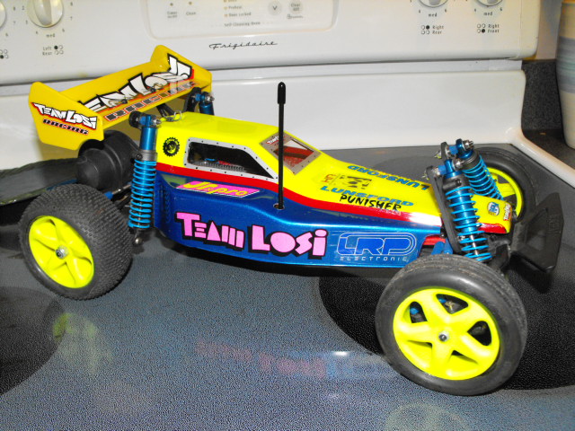

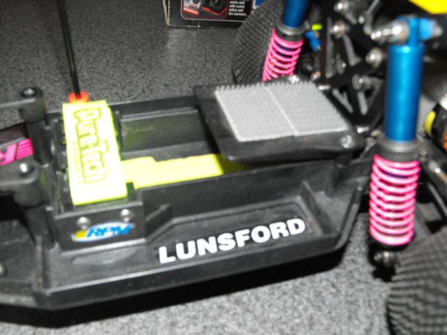

I built my Pro se for the Vonats and I didn't want any grief about running to modern of a Losi, so I used all Prose, XX parts as my motivation to keep it all true Losi. both cars qualified for the Vonats was going to be my argument. My RPM arms , Puretech battery strap Lunsford turn buckles are vintage correct. the only modern parts are the Electric's and tires. but the tires could be correct xx so it is really all vintage legal. the Losi threaded shocks may blow that but their going on their anyway, they are so smooth.

I dont think that RPM sticker on the chassis is vintage either :lol: :lol:
Car looks great Rick. Cant wait to finish getting all my little parts together to start the beast.

I respect keeping it all Losi :D , I just thought that the HPI 5-starts were kind of true to the original JRX2 style. 8)
