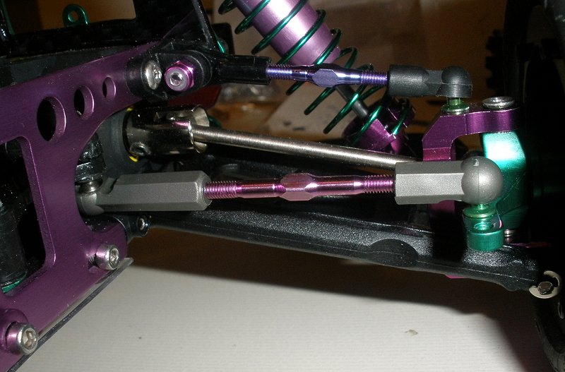

Once I got things assembled up to this point, an annoying problem appeared--whenever I'd compress the front suspension, the wheels would toe-out quite significantly...the dreaded bump-steer! I don't want Barney to handle like a truggy so I began researching ways to resolve this. Neither of my other 2 cars--CYANide and the Zebra Optima--had bump-steer, their suspension was practically perfect, so I was a bit perplexed what was causing it. The only parts that weren't direct replacements of a stock part were the GPM Lazer C-carriers. Looking at the steering knuckles from the side view showed me that Barney's knuckles were more horizontal, while the other Optimas had a significant angle.
That gave me the idea to try a fix that was surprisingly easy. I kept reading that bump-steer is often caused when the tie-rods aren't parallel with the control arms, and that was indeed the case with Barney's steering setup. I simply added a 4.8mm ball-end to the opposite side of each steering knuckle, keeping the original ball-studs there in case I ever need to change my configuration, and popped the ball-cups onto the balls underneath. Now, the rods were almost perfectly parallel with the arms...and the bump-steer toe-out was completely eliminated. I now have a slight toe-in which I hope will perform well. Certainly better than it was before.
