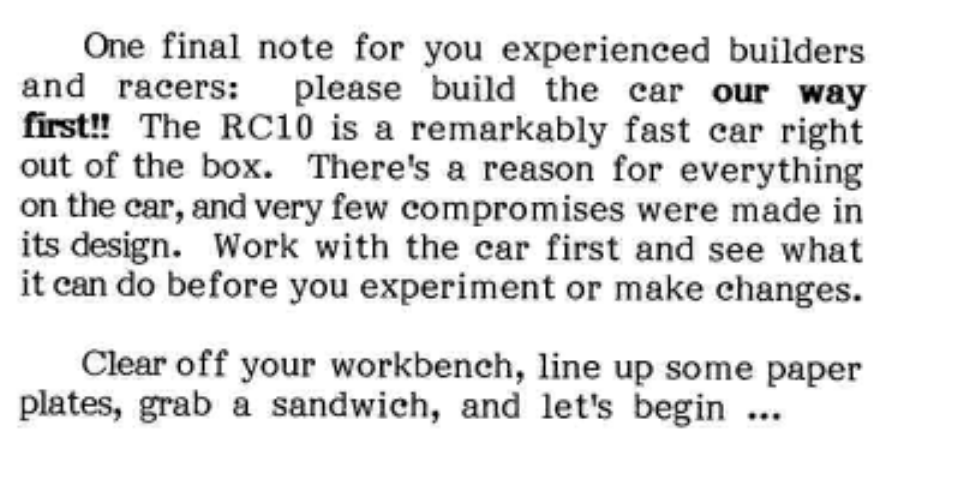

Look to this link for instruction manuals. The new ones not good. The original manuals were made to help you get the build right.
https://www.rc10talk.com/viewtopic.php?t=44408
