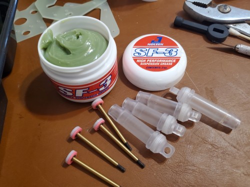

known of this stuff for a long time just always had green slime until now. noleen sf3 suspension grease sure as heck looks to be the same... i wish i had a fresh tube of green slime to compare.
certainly a LOT cheaper than the a.e. stuff. ;)
goin with rpm red medium/heavy lower pistons with the white light uppers since it matches the a.e. shock seal parts and the white uppers let the c-clip and upper part of shaft visibly pop a little better.
debating some 100wt oil since its a shelfer, otherwise shocks are built. the hg bodies and caps are fighting me every step. had to sand the pistons quite a bit, and them damn shock cap threads want to crossthread even when youre bein uber duper careful.

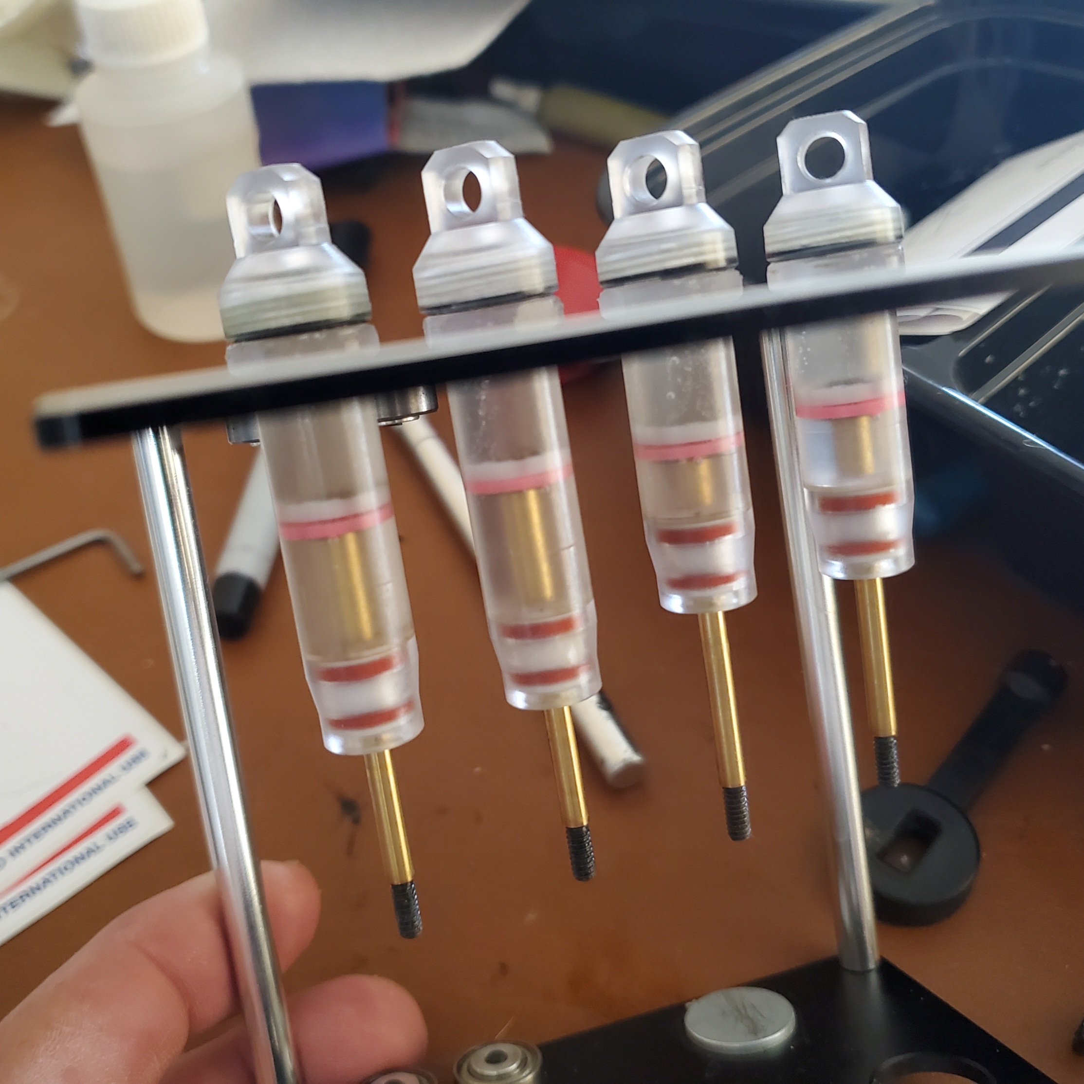

got the 30wt in em. they look neat...
im gonna use the vlts since ive had em set aside forever for this particular build.l, but wouldnt be against considering some losi shocks if i had a set.

The clear shocks look awesome! This feels like a great build to use them with. A clear Cirrus servo would go really well with it too

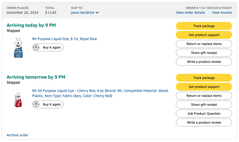

i got the dye comin' for the bombpop look but i still dont know if i'll do it...
biggest concern (other than simply fuckin it up) is the colors not being bright enough. hard to research exactly what rit colors are the brighter colors. scarlet red, racing red, cherry red... i know a lot of that is dependent on how long it sits in the dye but the basic hue is also a factor... i got some scrappy rpm bits i'll do a test on to make sure the colors are right.

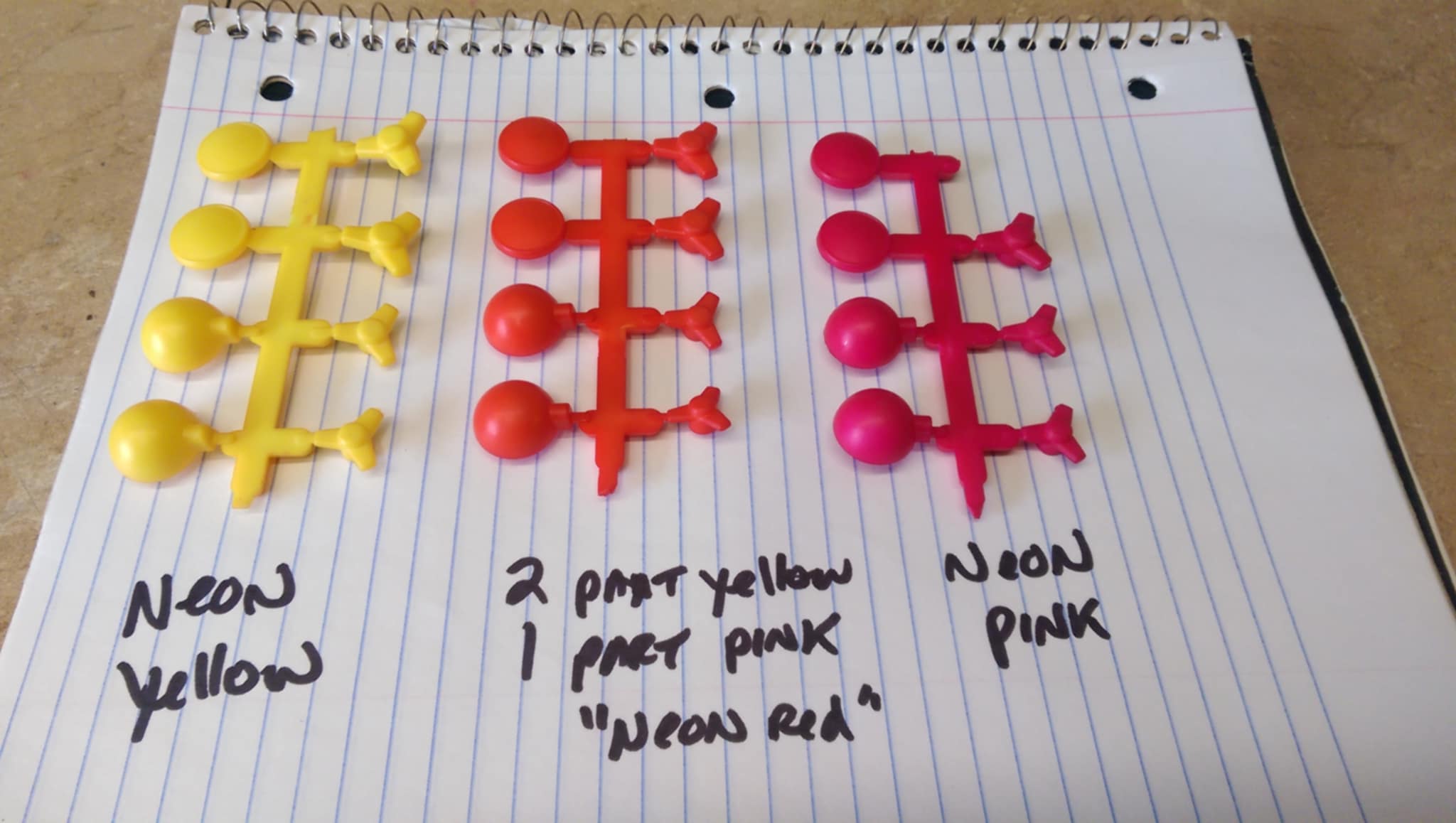

I have neon commercial dye from rit. It is sold by the pound so I have a lot left lol. Id be happy to send some of you want to play with it
Here is a really old sample I did
