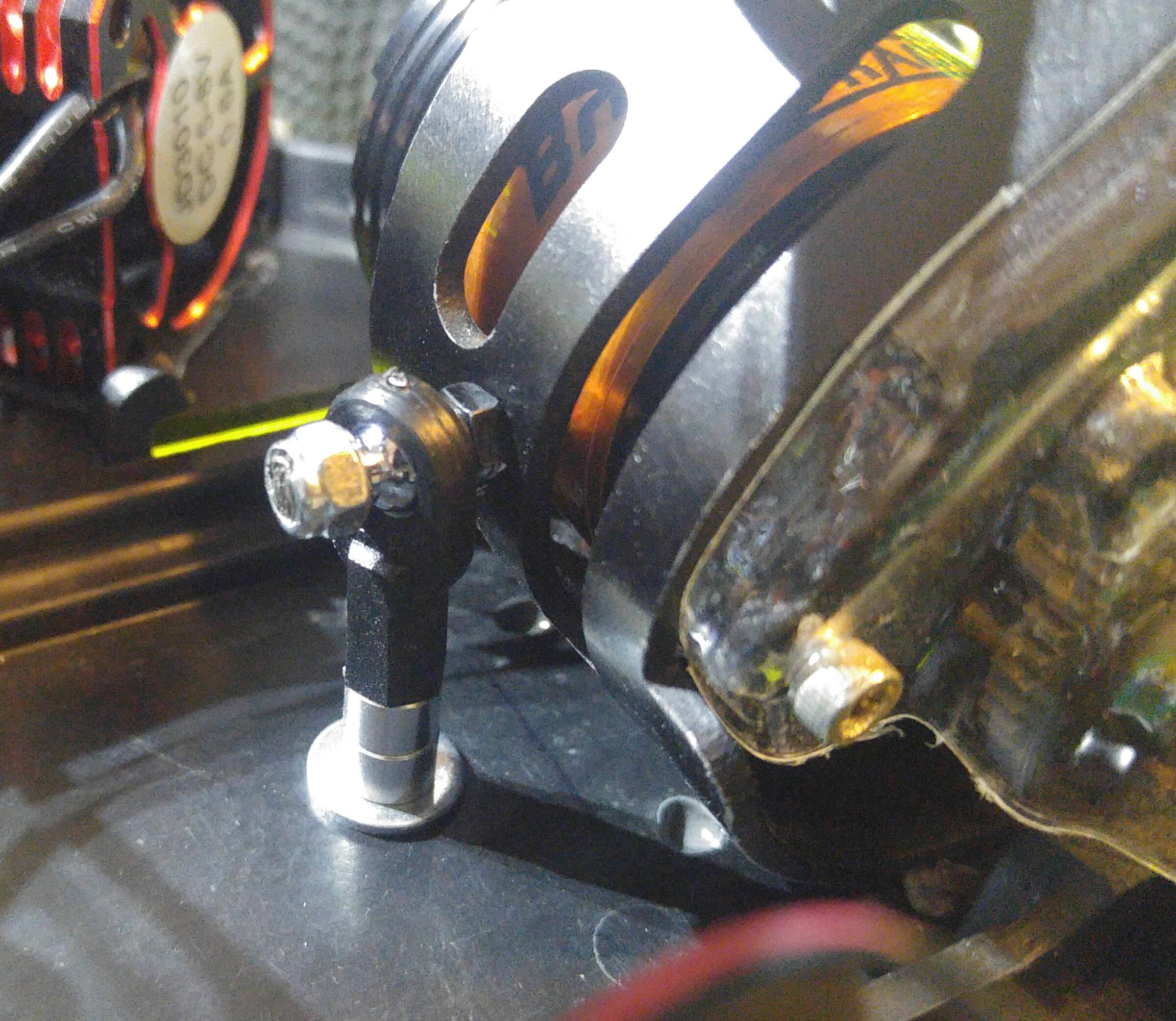

I've never owned a XX but I wonder if a new Tplate could be fashioned to ultilize separate pivot blocks like the XX-4 and later XXX series used. Like milling a tplate out of Carbon or G10 would likely make that part of the car a little stronger.
Also as far as rear motor support, you could always run a turnbuckle from the top of the motor plate down to the front area of the chassis.
p.s. Love this build!

Thanks, and yes, the turnbuckle is a good idea. Would need to figure out how to make it not interfere with battery ingress/egress.

stickboy007 wrote: Sat Jul 06, 2024 11:22 am Thanks, and yes, the turnbuckle is a good idea. Would need to figure out how to make it not interfere with battery ingress/egress.
could make it part of the battery hold down, that way it just levers up out of the way. just and idea anyway.

I got to the bottom of the bending of the rear T-plate, which was affecting the rear tower and wing angles. Basically, the Kyosho UM733 part that I had mounted, I pushed it too far back. That was lifting the motor mount slightly and causing some flex. So I removed that part and tried a different approach. Ultimately a good thing, because the threading into the bottom of the motor plate really wasn't enough to handle long-term stresses of racing. I filled the holes I drilled into the chassis for that with epoxy and drilled one new hole to accommodate what you see in the pictures below. Basically a 3x20 screw with spacers going into a rod end, which itself is attached to the front of the motor plate. This secures the motor plate to the chassis and eliminates fore/aft flexing like a waterfall would. It does take up some space in front of the motor mount, which limits battery position options. This means if you want the effect of the battery further back, then you just have to add some weights back there around the screw. Overall a much more elegant solution and far less messy than what I had earlier.
