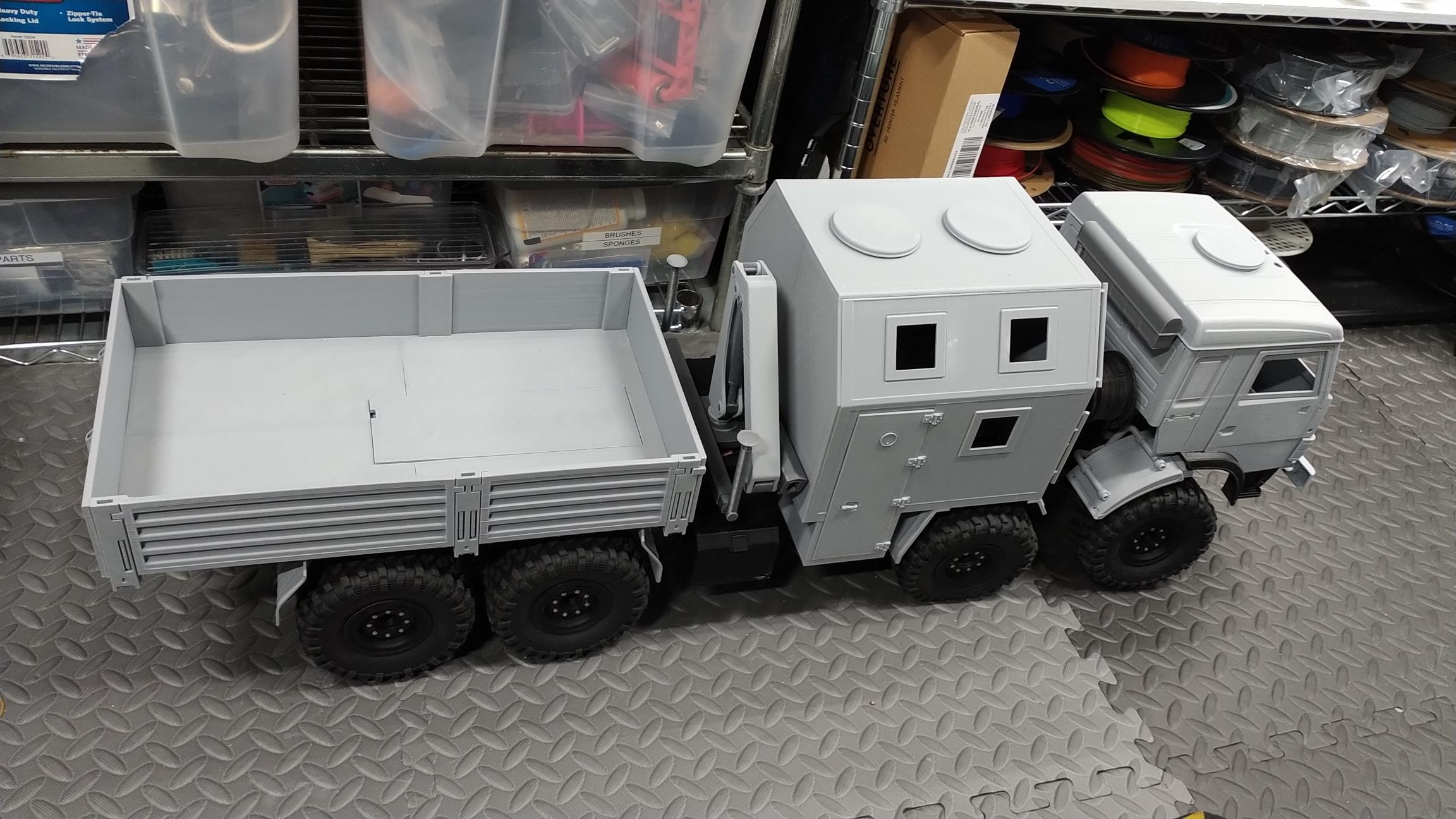

So here is my rendition of "The Bear"

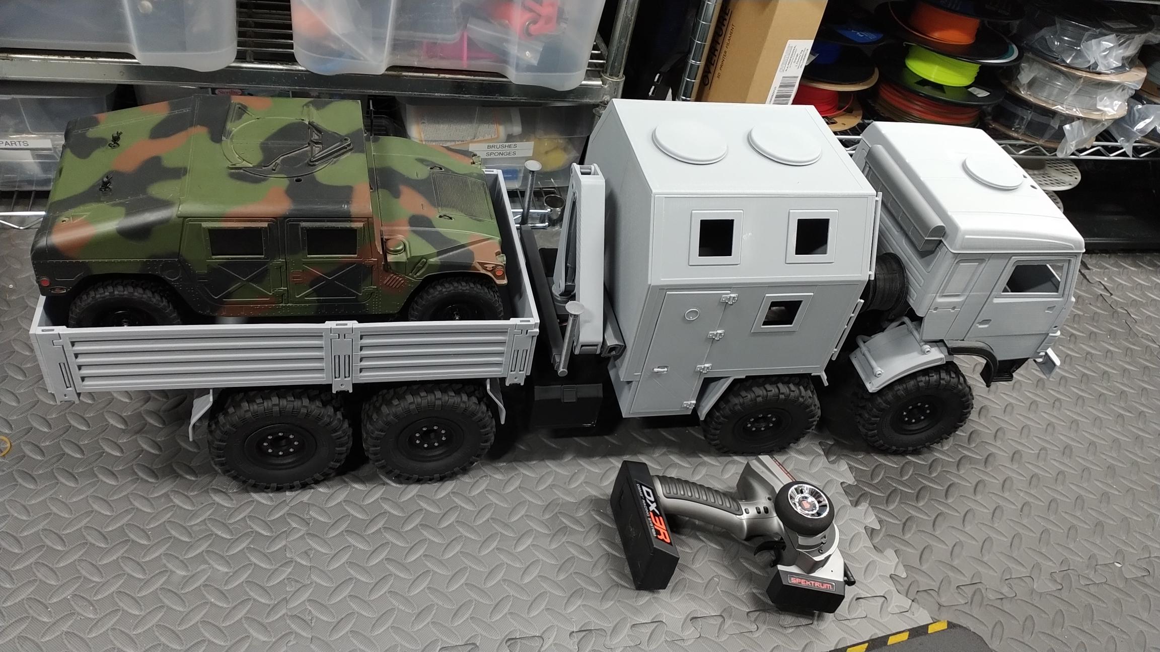

And with a Tamiya M1025 and my Tx for scale....
All in all, I think I used 7-8 rolls of filament (because most functional parts require 100% infill for strength) and LOTS of stainless steel hardware, PlastiBond, and CA glue. All printed on my Creality K1's. Measures just over 40" in in length.
As far as powering goes, I had a 120A 1/6 scale Redcat brushless ESC and a Maclan 8.2 1/8 competition buggy motor in it, but I ended up destroying the ESC. So I am now using an old Traxxas EVX2 and 23V 550 can from an old E-Maxx.
It moves quite nicely, due to the amt of gear reduction. However, on 3S, it still builds some heat because it's having to move almost 20 lbs of truck. Going to put a heatsink fan on the motor, and a fan blowing on the EVX2 and see how the temps are.
