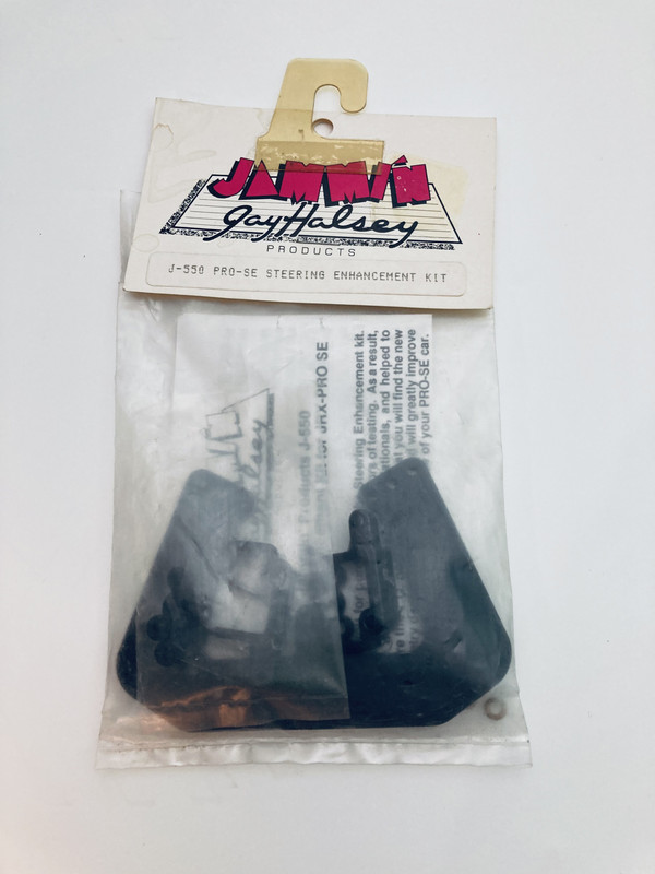

I have two of these kits…so I decided to open one up, install it on my Pro-SE and see what it’s all about.
The shock tower is the same shape as the original, slightly thicker at 3mm instead of 2.5mm and with different camber holes.
The rest of the parts are standard Losi stuff:
A-1017 LXT spindle carriers
A-1008 hinge pins
A-5015 shock cartridge spacers
A-6215 #4 narrow washers
Also mentioned in the instructions:
A-5223 - Silatech 275 - 25wt oil
A-5046 - #56, Teflon, red pistons
A-5150 - 2.5” 2.3 pink springs, cut down 3 coils
—OR—
A-5130 - 2” 3.2 silver springs
I happen to have a used set of the preferred A-5150 pink springs that I wasn’t afraid to cut down..
Stock
Jammin
Notice the Jammin step pin rear tires too..
-Brad

Nice! I noticed when I tried the LXT carriers on my JRX2 that the camber location on the LXT carrier is higher and results in more camber gain and bump steer even at the highest spindle setting. The new camber location on the tower would probably solve this.

Overall..the camber link is raised, lengthened and made more perpendicular to the chassis centerline. Also aligning up better with the swept front arms..
