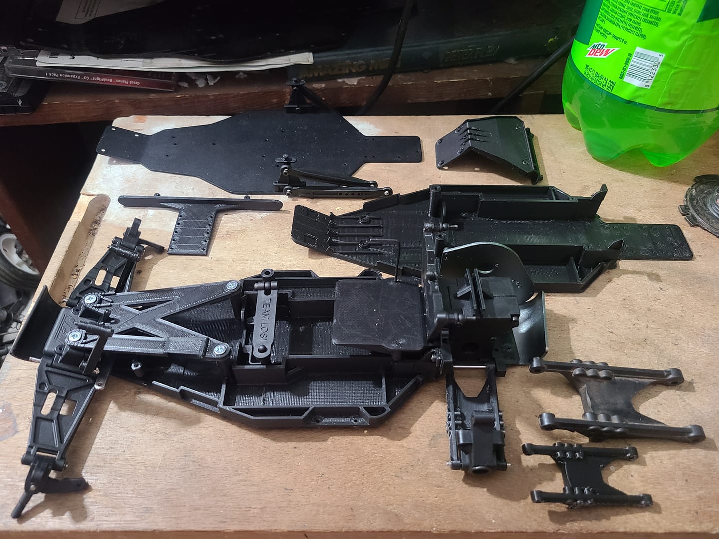

Well dangit, everything is going just swell and then you turn a corner and run smack dab into a roadblock. I have taken down the chassis for the moment as when I had everything together for todays photos I was unable to turn the bellcranks. Turns out the thicker Junior shocktower with a cap head screw took up all the space and the bellcranks wont turn so I have to move them back... grrr.. On the other hand the h arms were a pain to model as they are sided and NOTHING is square lol. I have no way of measuring if there is an angle difference between the hinge pin drillings but I got the angle for the lean of the arm about spot on. I printed them on their side so layer lines are perpendicular to the holes for most strength, seems to have printed just fine.
Those rear arms almost perfectly scaled to the mini I only needed to slightly narrow the opening on the hub side by a small fraction of a milimeter.

Your goodies should arrive tomorrow and you can compare stuff. The rear arms were a giant pita and I modeled them close but far from exact. The offset I came up with was 1.6° and no toe built into the arm- although I was able to measure a tiny bit of toe OUT by maybe 1/4 of a degree. Seemed like it should be 0° so that’s what I went with.

That is awesome Jeff! I have been up way late again working on hubs this time. I am a bil leary on the lack of meat where the ball stud goes I may have to reduce the number of holes... but I dun wanna :p
Also I have no drive shafts or rear wheel bearings yet so cant actually test how the bearings fit lol. I came up with two separate ideas for the hinge pin spacers that mimic the stock Losi ones one a snap fit one a complete circle.
These will most definitely need to be printed on their side to have any hope of strength in the hinge pin hole and ball stud mount, but it is what it is. I guess I will test it once my test chassis is done printing.. again.

I left the carrier as close to original as I could and I agree with all those holes the chances of breakage are high but it just looks “right” with em.
On the clips, I left them open but not really snappable. I wanted the look but wasn’t concerned about the functionality since we don’t have the correct pins for them anyway.
