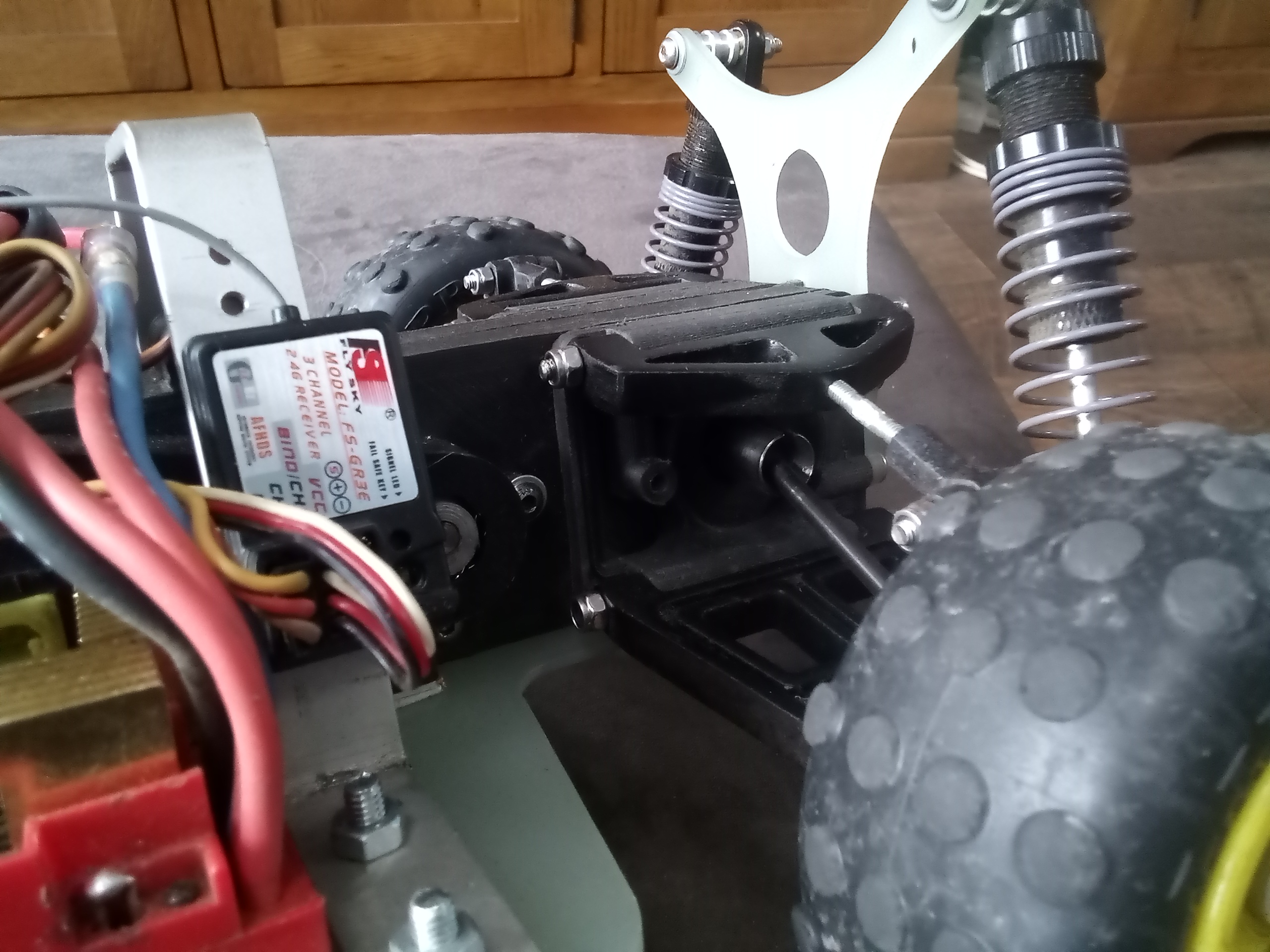

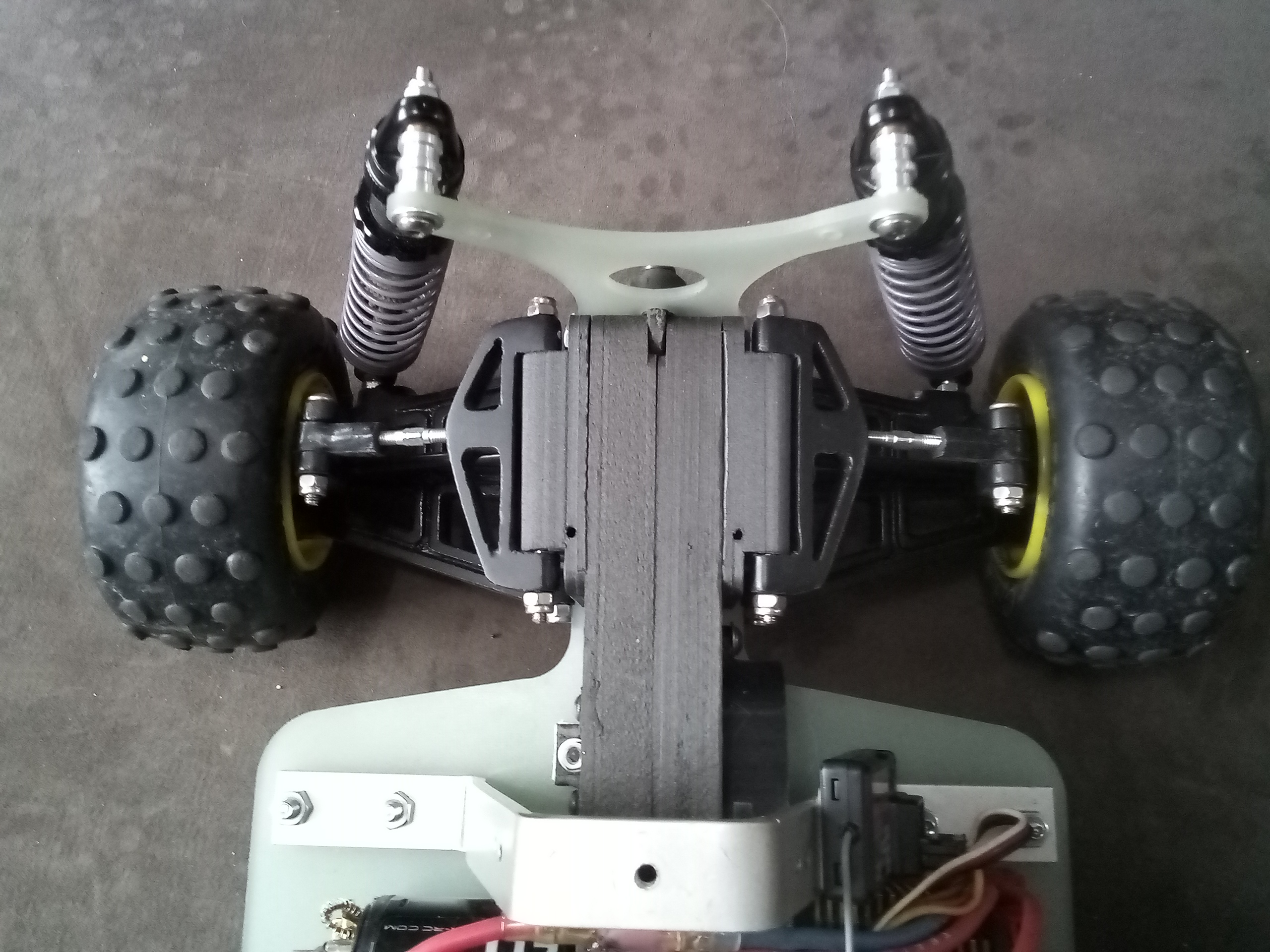

Did a slight revision of the rear suspension mounts to raise the bottom arm mount up 2mm , the wheels are so small I could not make hubs that gave a parallel lower arm and dog bone so by moving the inner end of the lower arm up it gives a bit more articulation without binding up the shafts . I may further modify the mounts to give 1.5° toe in to the rear wheels , I'm already starting to like driving it more as I work out the kinks and dial in the suspension , think I got a bit carried away this afternoon as the motor was a bit toasty when I stopped :lol:

I did a little more minor refining of the rear suspension to give it 1° toe in on each side , I was going to add 1.5° but when I looked at it it seemed too much , running it today it's much more stable under acceleration and at speed , it's not too clear but might be able to see the angle in the suspension mounts .
Also added wing wire mounting points ,you can just see the hole for a locking screw in front of the diff out drive and the holes for the wire can be seen in the first picture .
