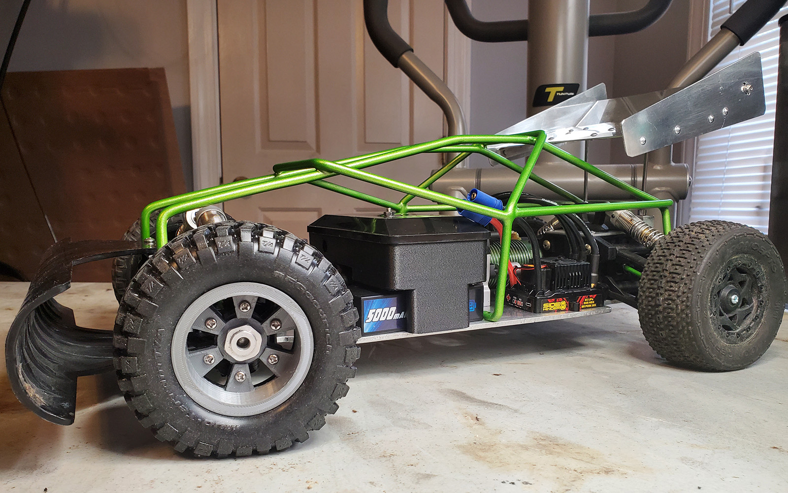

- morrisey0
- Posts: 1719
- Location: Richmond, VA
- Has thanked: 74 times
- Been thanked: 1733 times
Re: GV (Great Vigor) Hunter 1:8 4WD Nitro Buggy?
So, am I the type of guy that paints and decals a rig before finalizing essentials such as steering and battery mounts? Yep, I am that guy!
Remaining:
Steering: New rx/steering box is in printer now that will hopefully be final for final servo set up. For now, the stock steering set up will remain.
Batt mounting: Half of the remaining will be with rx / steering box. Front mounting TBD
Final motor / gearing / testing
Front lower a-arm needs to be replaced as one brass ball stud thread broke off in the arm. I have a replacement arm, but I think I can swap sides on the current arms and re-use them. This involves complete disassembly of the front end.
Shocks: I hate the current / OEM shocks! Finding replacements with similar dimensions is near impossible. I am hoping now I can replace the springs and maybe print new pistons to make them useable.
Remaining:
Maybe try swapping the cage around: I find it looking better that way.
- morrisey0
- Posts: 1719
Swapping the cage around puts the center supports right where the rx box is. I wish it was symmetrical so it was an option.
