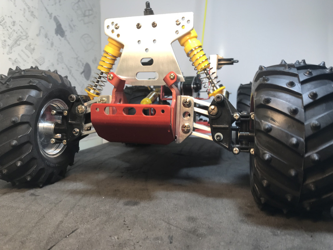

The last phase of this build has been the most difficult.. After getting the rear suspension travel and ride height established, I had to match the front end and incorporate the body & front shock mounts all at the same time. To make things more difficult, I wanted to use a stock hard body and mounting posts.
First problem was that the front suspension was much higher than the rear.. to solve this I flipped the control arm brackets and drilled extra holes to lower them.
There is a good reason why you never see any Hot Trick Monster Beetles.. the body is small and if you want it properly centered over the wheelbase, it doesn’t allow for the typical front mounted shocks & body mount like the Hot Trick Blackfoot. Notice on the December 1987 RCCA Project Monster Beetle, there isn’t a good side pic to see how forward mounted the body is.. So for a nice body fit and look, the front shocks and tower needs to mounted on the back side of the the control arms. Using a cut down, aluminum copy of the JG #5003 front shock tower and ReRe yellow CVAs..I came up with this that looks awesome and sorta period correct. Some CRP adjustable spring collars too..
For the rear body mounts I used an unknown Hot Trick bracket from my stash and some custom cut & drilled pieces of 6x10mm stock.
Looking good! Added a vintage Holeshot 2000 motor heatsink for some more air cooling to the Beetle.. Final body finishing next!
