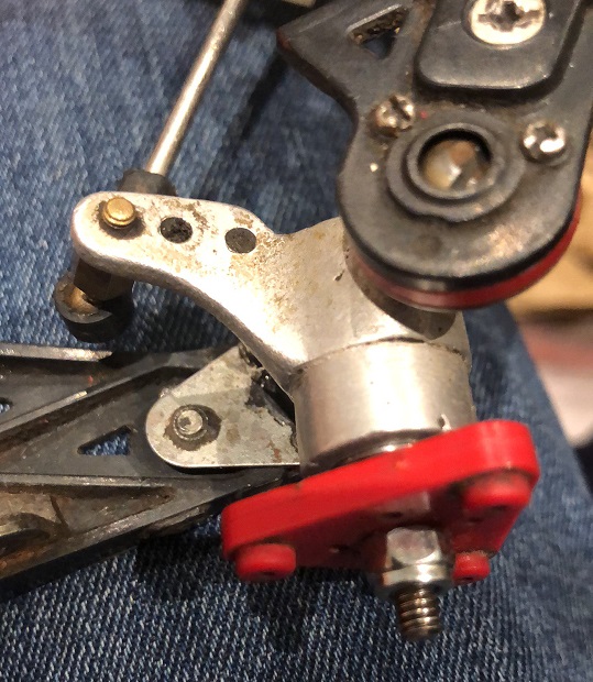

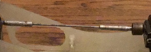

Judging by this old TMS advert from Aug '85 it looks like i might have the TMS steering hubs and possibly the same main prop shaft also.

Dinglem that's not the prop I had , mine was a one piece shaft with a very basic hex end more like a bolt head than the Tamiya hex with the flowed in roll for higher angles of drive , it may not have been a TMS prop , it was a long time ago .
Those are the knuckles I had for sure and the dog bones look right too .
Looks like a touch of rust on the pivot balls so you may already have steel ones , I'd be surprised if it didn't with the rest of the car !

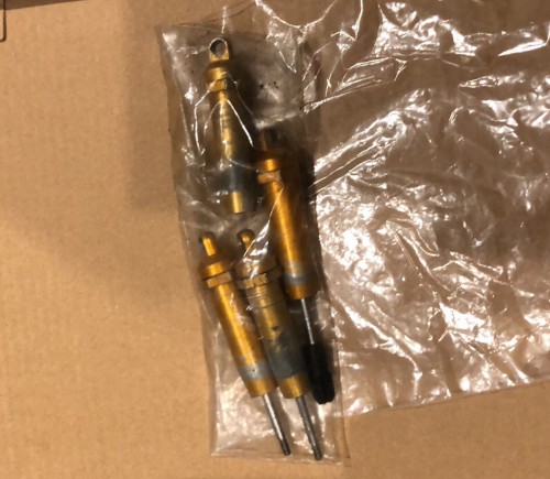

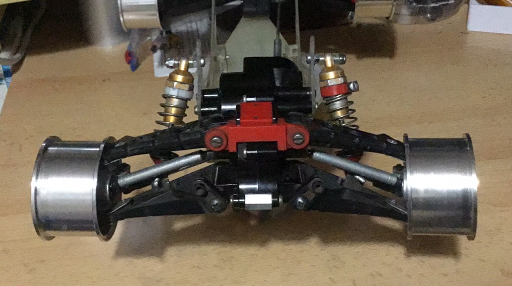

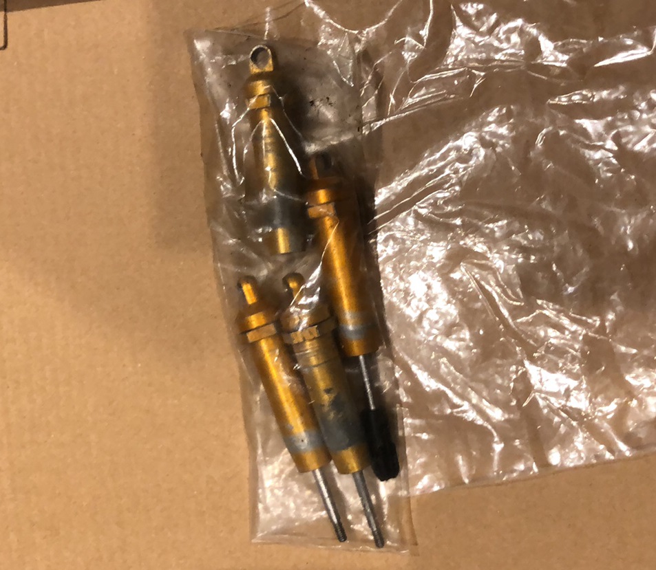

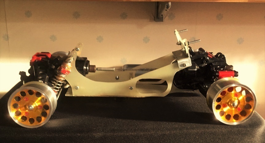

Well i will drop a couple of pictures in here to show you where it is currently at.
Here's a front-on shot before cleaning as we were trying to work out how the upper front shock mounts might work. They are kind of odd as they have to be able to pivot in all directions due to the steep angle of the shocks combined with the wishbone swing, and as they are mounted by the shock cap loop it presents a bit of a challenge. It has been achieved by using three pieces of silicon tubing.... Two larger diameter pieces on either side to cushion the sides against the nut and tower, and then a smaller piece within the top of the cap loop itself. This lets the shock swing quite freely on the bolt in all directions without any play. Quite a cool solution. The rear upper shock positions will have to go on in the same manner but at least we now know it works really well like this. You can also see the CRP front A-Arm brace here, albeit in a bit of a mucky state. The odd spring clamps were just how it came and will obviously be replaced as it all goes back together.
It came with two pairs of rear Associated shocks to choose from, so i will probably build up the less worn pair and get those onto it shortly. I don't want to over-restore these parts too much really as they seem part of the history of the car.
After a complete strip down and a lot of wiping with my top secret cleaning system (baby wipes) plus a gentle sanding of the fibreglass surfaces and mainly the edges to remove years of ground in grime the plates have come up virtually like new! I have to say the chassis is a real thing of beauty - something very different to the norm for a Hotshot anyway. I think with the heavily angled rear shocks on too it is going to look fantastic. The wheels are rare Phoenix alloys which will go really well with the colour of the bodyshell design i have gone for, which will be coming shortly.

Absolutely stunning! As a kid my best friend and I both raced around hotshots which we slowly upgraded to supershots, G10 battery plates, newer shocks and I could have sworn he had the same main drive in his...it was so long ago but brought back some amazing memories, thank you!!! Great, now I want to restore a hotshot lol

That's a jealousy inspiring car for sure ! fabulous survivor.

I will try to do it justice with the rest of the build. Hopefully this one won't take too long as it is virtually complete. I am quite looking forward to installing the period electrics into this one, and then I can hopefully get it onto the track.

With reference to the front top shock mounts , I used supershot ones and they cant out from the chassis , they are also mounted outboard of the chassis , this gave the shock a more upright stance in one plane meaning it only had to pivot not articulate , now there is no way your going to saw of the shock mounts and replace them but fitting a spacer to stand off the mount more appears to be what people did with this chassis .
- dinglem
- Posts: 1381
- Location: Lichfield, UK
- Has thanked: 244 times
- Been thanked: 634 times
Re: 1986/87 Supercharge Hotshot

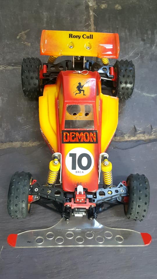

I've just tried to copy the original angle that Bill Jones used. The rear is going to be the same i think, looking at it.
The front mounts on my Rory Cull Hotshot are different again, but are more like as you describe however.
