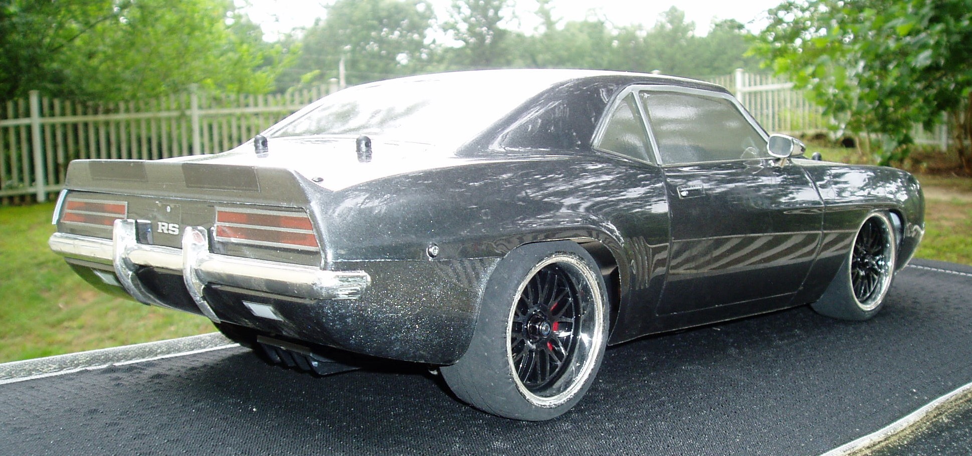

FWIW, here's what I'm rocking:
Shelf duty
wheels: Apex RC https://www.ebay.com/itm/221524930854 ('cause I'm an old guy who still prefers chrome wheels :wink: )
tires: https://www.ebay.com/itm/RC-T6085-Grip-Tires-Insert-sponge-4PCS-For-HSP-HPI-1-10-On-Road-Speed-Car/324198892163?hash=item4b7bc28283:g:aMoAAOSwPNBdAxB8
Track days
wheels: Kyosho Hellcat https://www.kyoshoamerica.com/FAH701BK-Wheel-FZ02-Mesh-7Black-2pcs_p_25693.html
tires: Nitro Hobbies V-Grip https://nitrohobbies.com/nhxt1205/

I want to be careful here as I don't want to hijack this thread and steer it off-topic. Maybe this is a good place to discuss availability of wheels and tires for these cars -- or maybe not. LoboNYC, please tell us to to take this discussion elsewhere and we will. No worries, I promise! :wink:
I agree that the tires supplied with Kyosho and other models would look better if they were wider, but 26mm has become the industry standard width for these cars. I think this goes all the way back to the touring car era and perhaps some time before that. Contributing to the skinny tire appearance is the car's width. The Kyosho Chevelle body for instance is 8-5/16" wide. If it were true to scale, it would be only 7-1/2" wide.
Vaterra supplies 30mm wide tires for the rear of their cars and similar width tires are also supplied with certain Tamiya models (mostly for Porsche models). But those non-standard width wheels and tires tend to be a bit exclusive and more expensive so, with the Camaro, I save them for shelf duty.
... and fit the cheaper stuff on track days.
