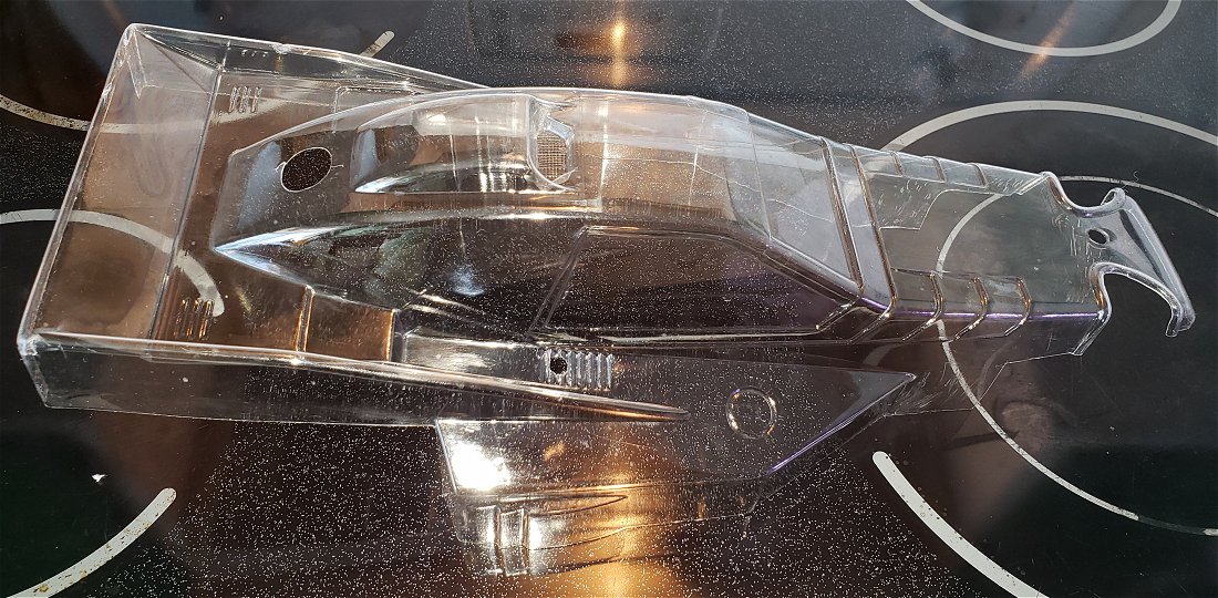

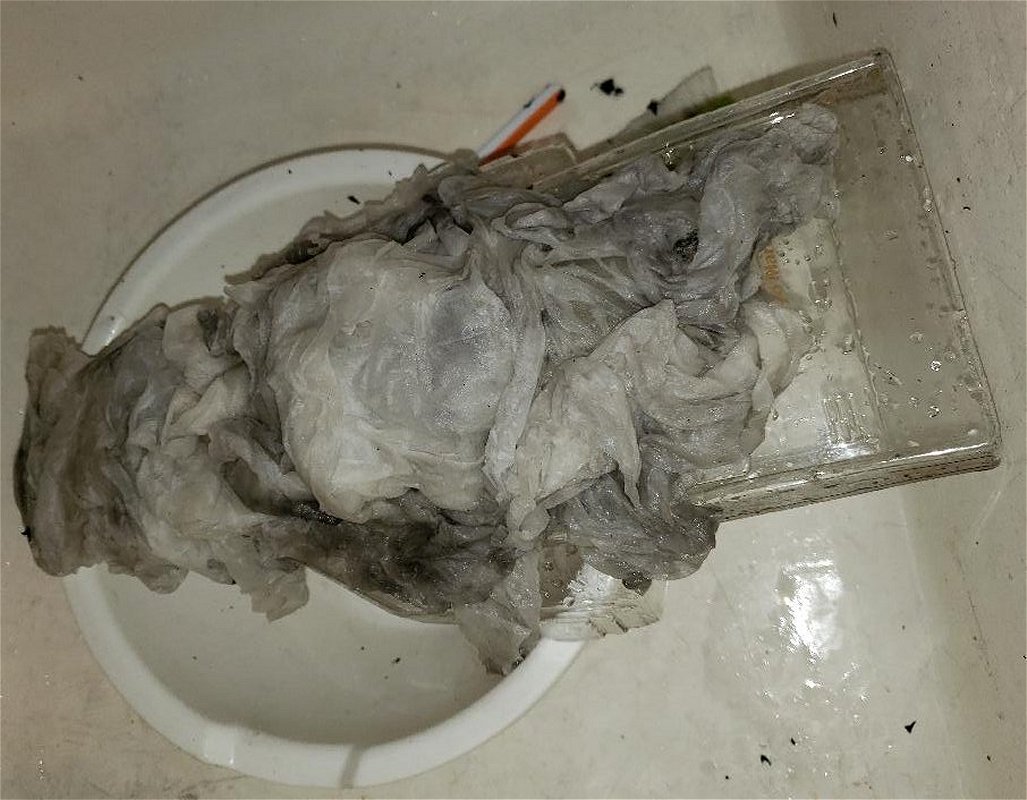

I got to repainting this body. I figured it had decent RC paint like Pactra, and since it was mostly good and needed only some touch-up to cover up some areas of chipped or flaked off paint, I got some leftover Tamiya black and sprayed over the existing black. The body was originally painted with the common "lazy black everywhere" paint job, including the windows. Unfortunately, not long after I sprayed on the black overcoat, I could see the Tamiya paint was reacting with whatever was already there. In those areas like the corners, I was able to wipe up sections with a toothbrush.
I supposed the original paint was therefore NOT Pactra, and began soaking tissues in DOT 3 brake fluid and left the bunched-up tissues on the body shell. After several hours, I was able to remove large portions of the original black paint with a toothbrush, X-Acto knife (on the inside) and my fingernails (on the outside). I also discovered there was a LOT of black overspray on the outside of the body...something you wouldn't really notice with an all-black paint job. I've been at it for almost 2 days now but I'm almost finished. It takes a lot of patience because each round of DOT 3 tissue soaking takes hours of waiting before you can brush or scrape off more of the paint, but I'm actually glad. Now I can do a nicer paint job with good paint and have clear windows. I'm no fan of box-art, especially not the original box-art design with silver areas to go with the black & gold, I don't think silver works with black & gold. I'll probably come up with something that's mostly black but maybe I'll add some subtle gold trim or gold pearl.

After a lot of painstaking black paint removal, most of it overspray on the outside of the body that was obvious when looking at it over a white piece of paper, it's ready to be repainted. I'm lucky to be able to salvage this original body, even with a few cracks and flaws, and not have to buy a repro body.

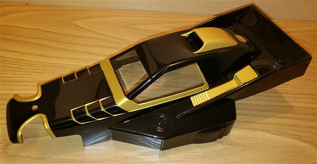

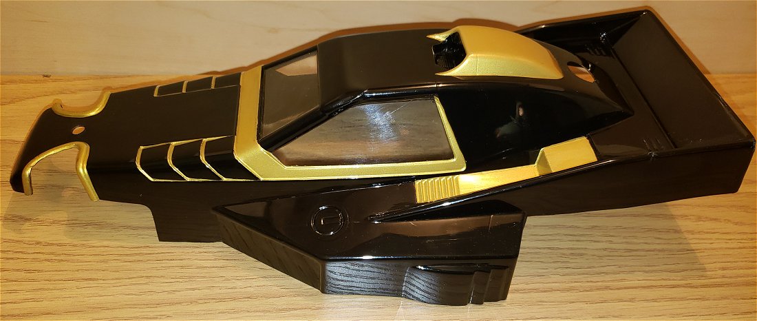

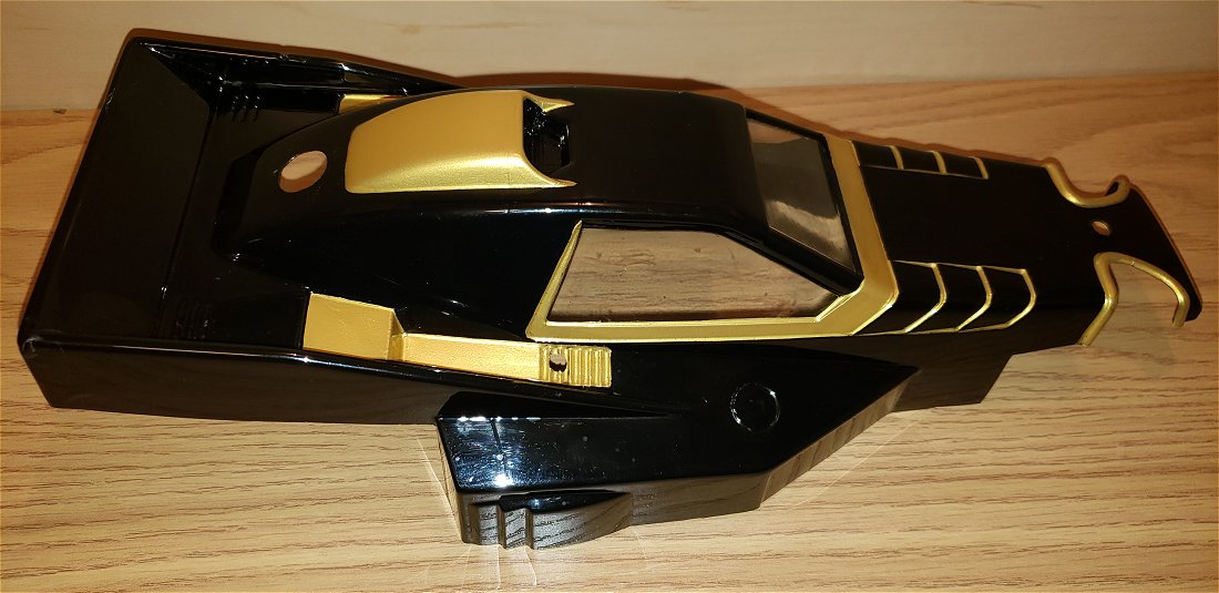

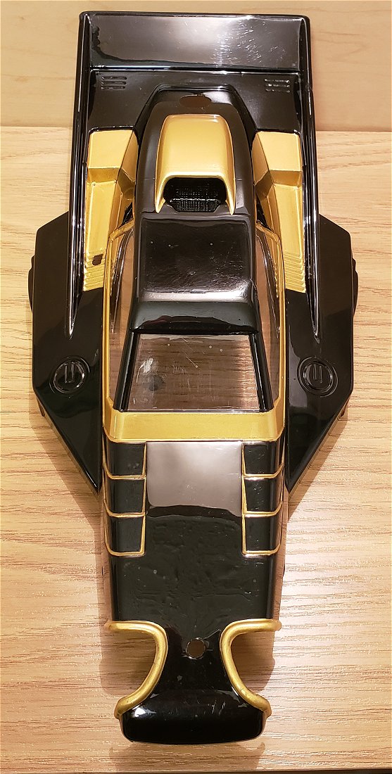

Painting is finally done! I had a major setback following my own stupidity, only brushing on 2 thick layers of FasMask (instead of 3 or 4) and peeling off most areas of the mask was a painstakingly tedious, frustrating ordeal requiring many hours of X-Acto knife cutting and scraping of paint and mask, and several subsequent touch-ups. OMGawd that wasn't fun. :x
Well, I don't do box-arts, because it lacks imagination and creativity, and also because I don't like how the original box-art has silver sections that I don't think contrast nicely with the black & gold sections. I try to somehow bring out the body's lines and accentuate them in a way that does it justice. Here's what I came up with for this Shogun's salvaged, repainted body. I'm waiting on a sticker sheet from MCI, but I won't be putting all the box-art-suggested stickers back on, only the ones that I think will improve the esthetics without obscuring the paint job. Next thing to do: Take care of that repaired rear body mount section with the big round hole.
Dadio
Posts: 4055
Location: Guildford UK
Has thanked: 2705 times
Been thanked: 2237 times
Re: Marui Shogun Restoration
Post by Dadio »
That's come out really well , all the stress was worth it for the result !

Yes, worth the effort - looks great.
Nice save :!:

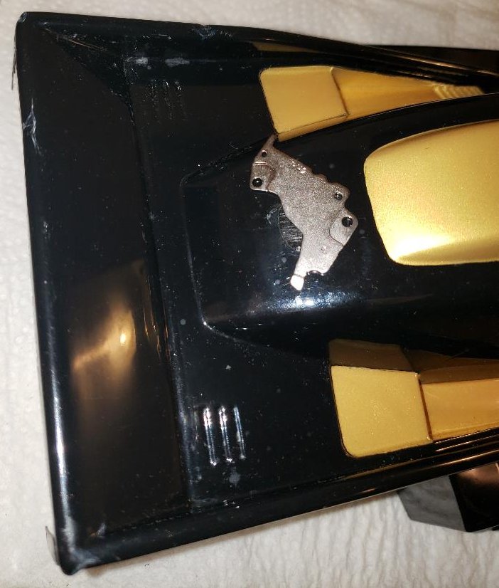

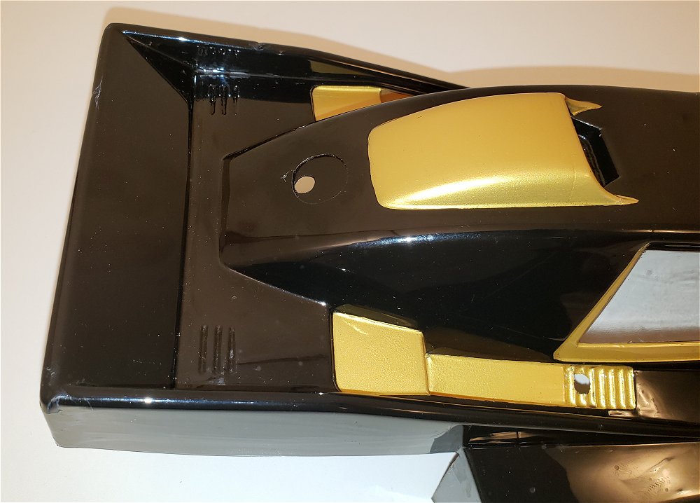

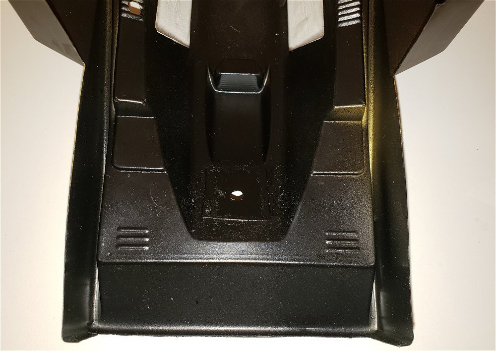

The body repair of the originally mangled rear body mount section is done. It's not picture-perfect, but a lot better than the way it was before:
I already ground out a largeish circle to get rid of the original damaged Lexan, everything except a bit of a crack that ran rearward. I didn't want to totally remove the crack because the hole would've ended up being too big. I think I ended up with a fair compromise.
I found a piece of Lexan with a curve that was very close to matching the inside of that part of the Shogun body, then painted it black.
I used Shoe Goo to stick on the repair patch to the underside of the body, and since it's hard to get a clamp in there to firmly press on the patch until the Goo cured, I used a couple hard drive magnets on opposite sides to keep it tightly secured for 24 hours. I work in I.T. and every time I get a hard drive crap out, I remove the magnets. These are the best fridge magnets ever! I even use them inside my Grand National's transmission and oil pans to keep any metal particles from flowing around the oil. They stick on so hard, you practically need a screwdriver to pry one end up, and remove them.

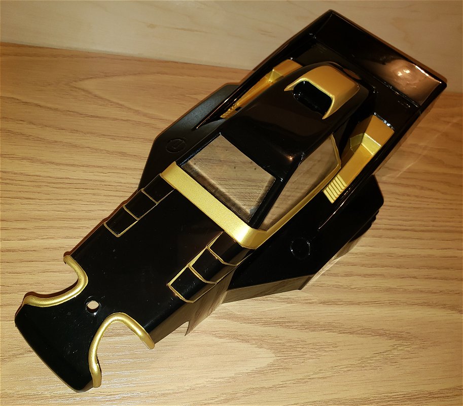

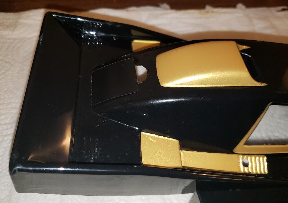

The finished body mount repair looks a lot better now; repair patch from the inside and outside:

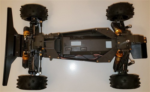

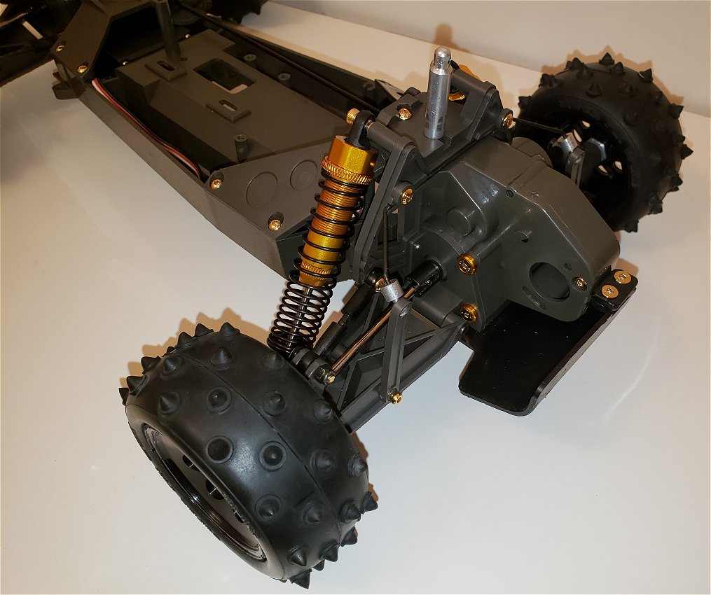

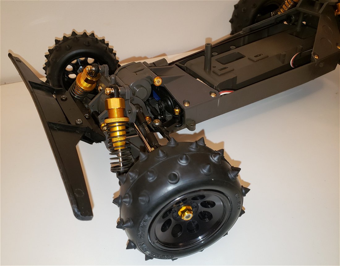

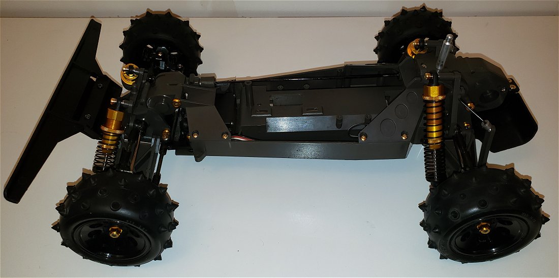

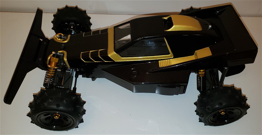

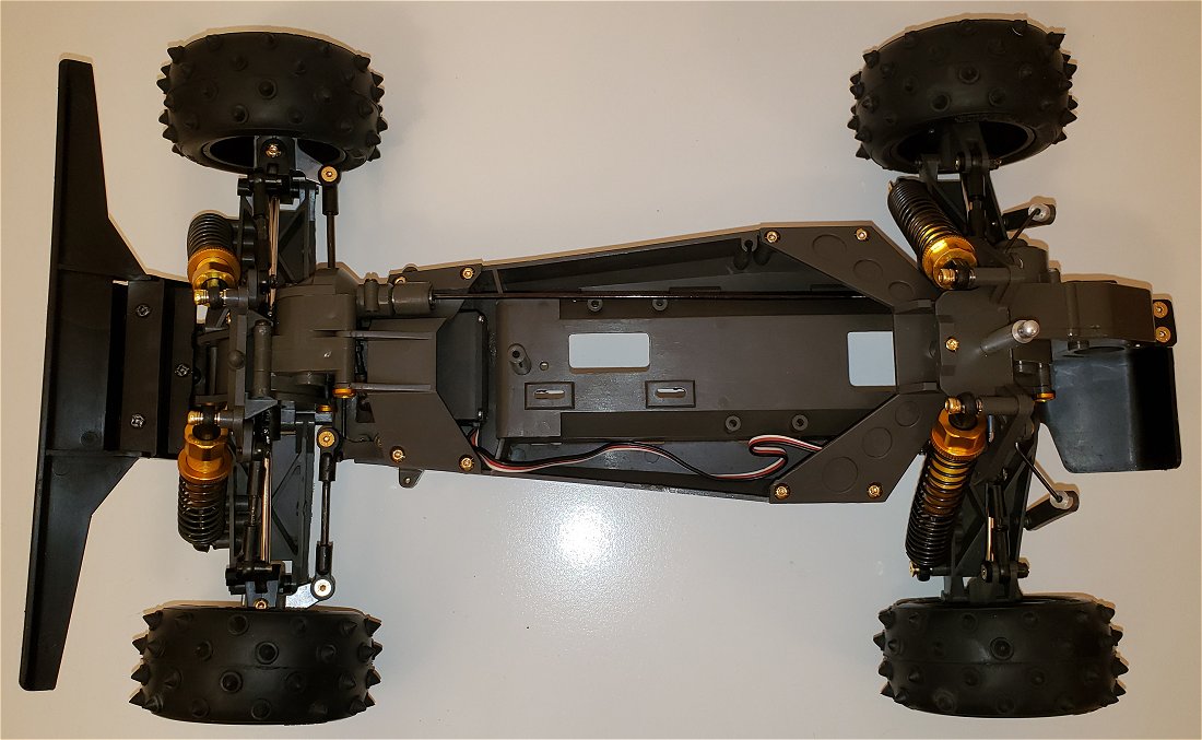

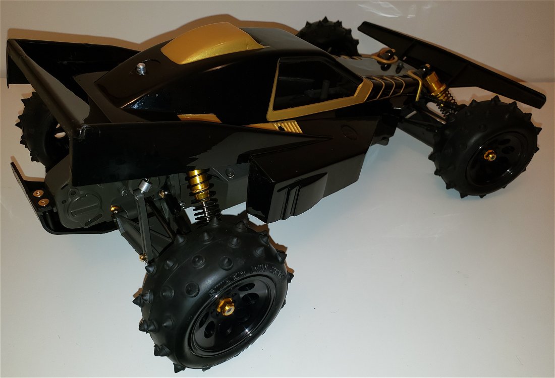

Here are some finished chassis pics:
Coelacanth
Posts: 7421
Location: Alberta, Canada
Post by Coelacanth »

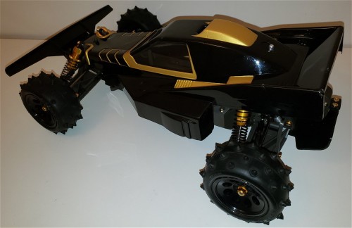

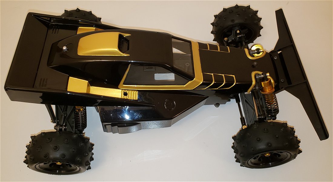

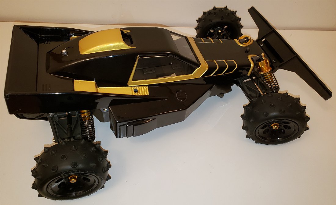

Some pics of the almost-completed car. Still waiting on the MCI sticker sheet to add a few stickers before taking the final money shots.
Dadio
Posts: 4055
Post by Dadio »
That's stunning , gold on black (even the nuts) works so well !
Coelacanth
Posts: 7421
Thanks for the comments, Dadio & RC10resto! I'm glad that it has turned out better than I expected. Up close, it really looks good with all the gold-plated screws and gold anodized nuts & washers, not to mention the shocks. I wonder what the purists would think of the build? :lol:
