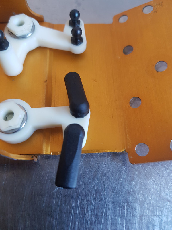

Been chipping away at this.
Got the chassis protection on
Servo savers were cracked and incomplete so put rere worlds bellcranks on it
I have a load of ball cups which fit great. Not sure what they are, schumacher maybe
Its going to be a runner, so ill use them.
The plastics just wouldnt clean up well enough so i dyed the bits that 100% needed it!

Re: My first rc10!
yes, I would use the insert on the jconcepts tires(they are really intended for the jconcept hazard wheels) and be sure to glue too. you should be able to find the wheels really easy. it's the tires that are hard to find.
look much better dyed black. and nothing wrong with mixing and matching black and white parts. the factory did it.....predominantly due to the upgraded team arms, but towards the end of production, they mixed parts to fill stock.
