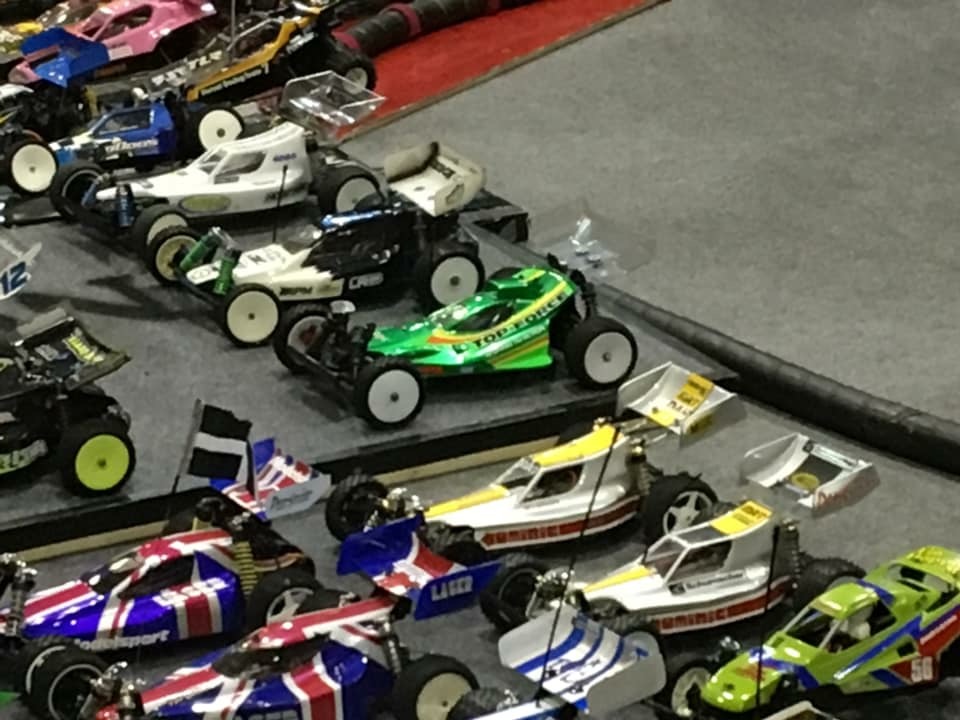

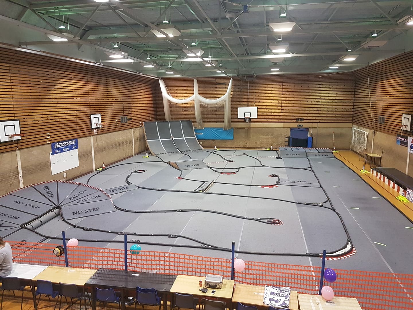

So went and raced the top force st Brett Davis gp (lots of pics on iconic rc Facebook page) from me and others
The topforce went well for 3 x qualifiers and was sitting top 2/3 in class with it, as the day went on the gearbox was getting more noisy and it stripped a spur gear :(
I was running speed tuned gears and had no spares so ended up using my rc10 in the finals
Car handles well but on carpet with the heavy breaking/grip the gearbox is the weak link for this car on this surface

thanks for the results, and that looks like a really fun track and great cross section of buggies there!

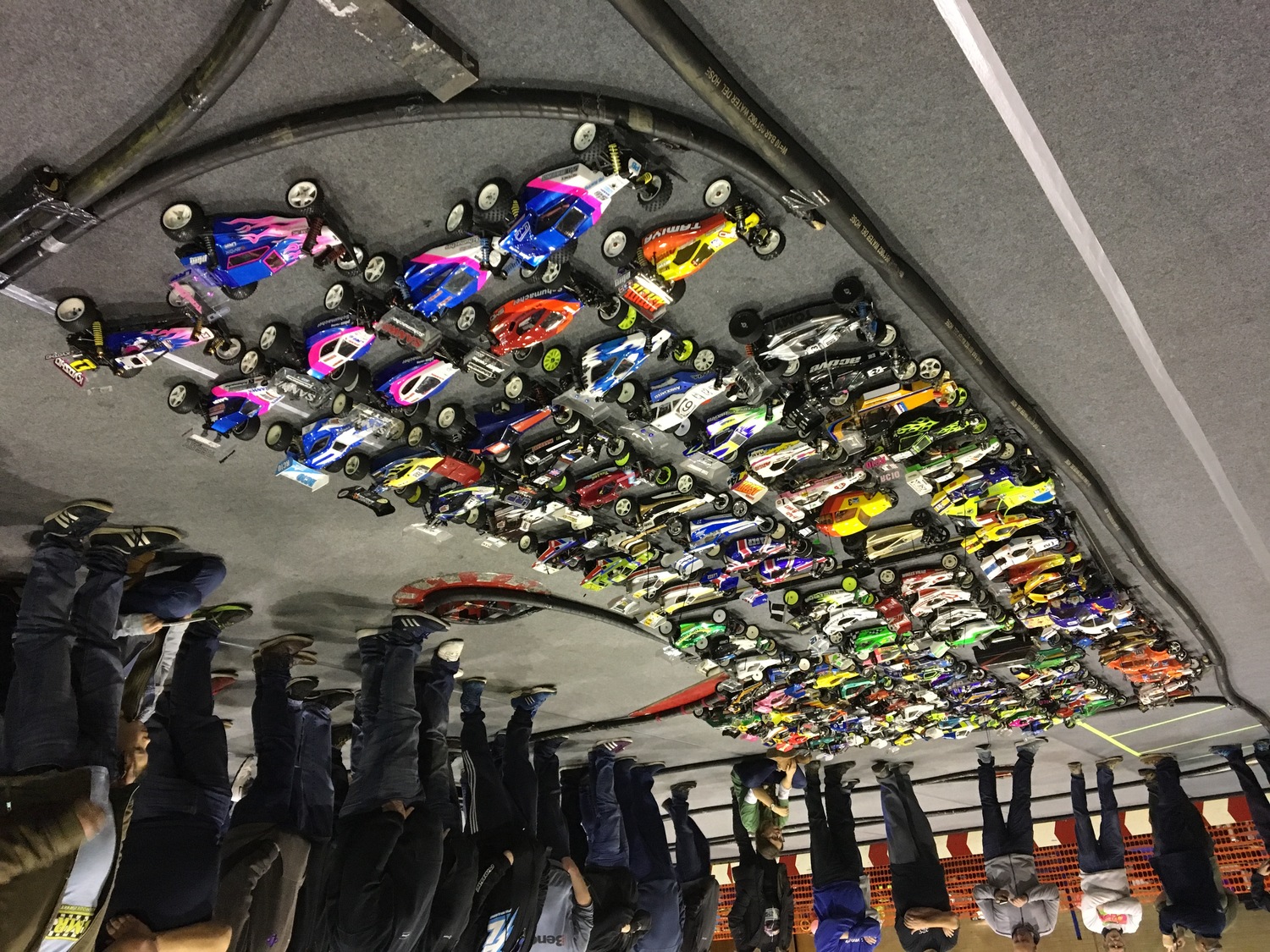

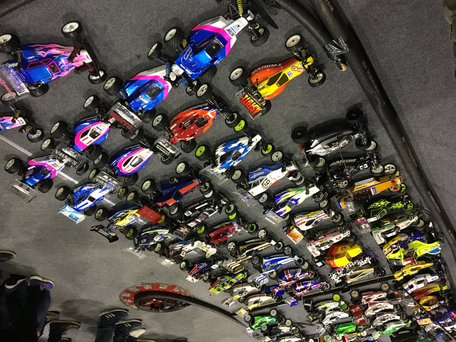

No worries, some more pics

The iconic team split the class by 2 and 4wd and by years so they are competitive and on par
